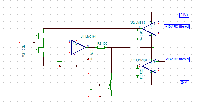

FWIW, here roughly the schematic of this experiment, ca. 1997 or so IIRC...
This was in my "Batteries and superfast circuits" time while I did my 2nd degree at UNL and worked as repair man (they called it engineer) for london chain of 2nd HiFi/Pro-Audio/Records/Books/Clothes shop chain based mostly around Notting Hill Gate and was even poorer than I am now (and drank more Guiness than I do now).
Nat Semi had a most generous sample program and Sandy at Cricklewood used kind of like me and sell me stuff below cost...
The circuit was rather twitchy and tended to oscillate if the cap across the rails had the wrong value. I think I had a trimmer in the FET sources for DC.
It had a MC Phonostage using shunt feedback EQ and current input with AD811 and LM6181 which bypassed the J-Fet buffer and 8 pcs of 2nd hand alarm system SLC Batteries (6V/2AH or such) as supply.
The two pots was actually a single 32-position GEC-Plessy silver contact switch (which I bought for an outrageously expensive 5 Quid per deck at the Tonbridge Wells Audio Jumble) with discrete resistors (including the then fashionable vishays - I changed to Rohpoint precision wireounds soon) so that if gain was needed they switched the right resistors to ground from -in and the output was unloaded while for below unity operation the right resistors where switched to ground from the output.
It did sound quite interesting. It was kind of my active answer to the then very popular (in England anyway) Audio Synthesis "Passion" passive preamp.
All ancient history.
Attempts at building this should be limited to anyone who has a> 100MHz scope and experience in spotting oscillation and related issues.
The circuit needs to be constructed 3D with the supply regulator Op-Amp's basically above the signal Op-Amp with minimal loop areas. The cap is a low pF silver mica IIRC, the whole active circuit occupies no more volume then the size of stamp squared with MEL resistors for feedback soldered to the DIP package pins.

What JFET has .22nV noise, or maybe I'm not understanding the configuration?
These days I'd probably just do something with tubes and transformers...
Ciao T
