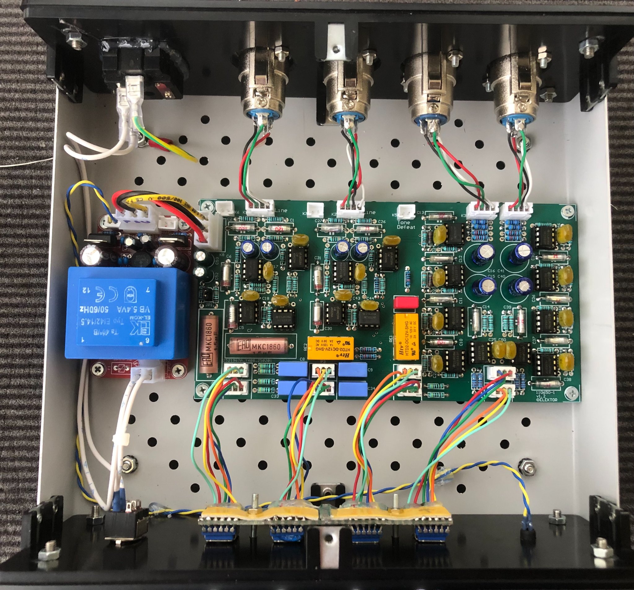

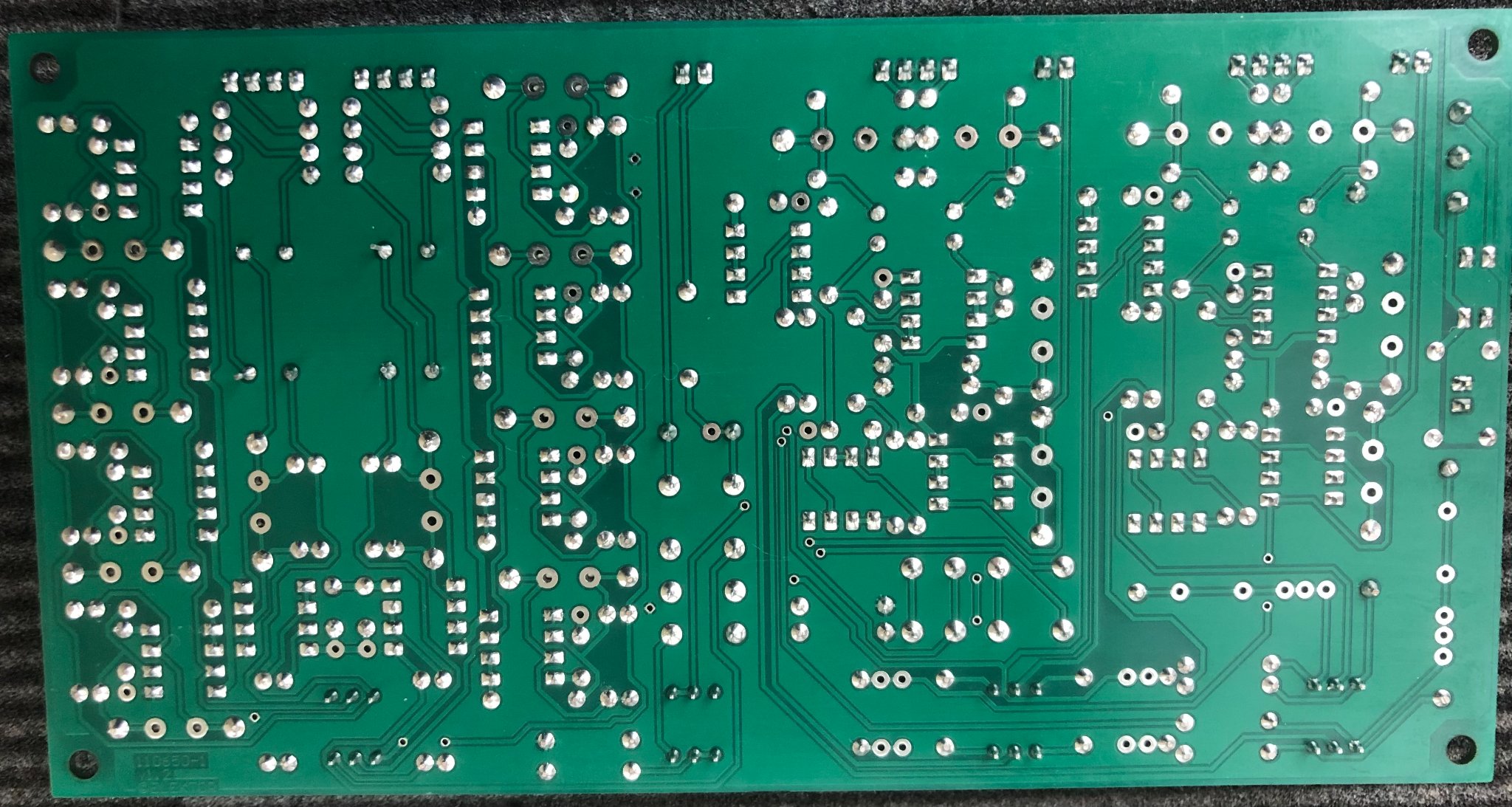

Hello everyone,
I have assembled this circuit. It has a very nice sound. But there are two problems. First, the balance adjustment does not work. Secondly, there is a noise that disturbs the ears at the lowest volume. A member friend on the site advised me to replace the 3k3 resistors with 1 k. But it didn't work.
