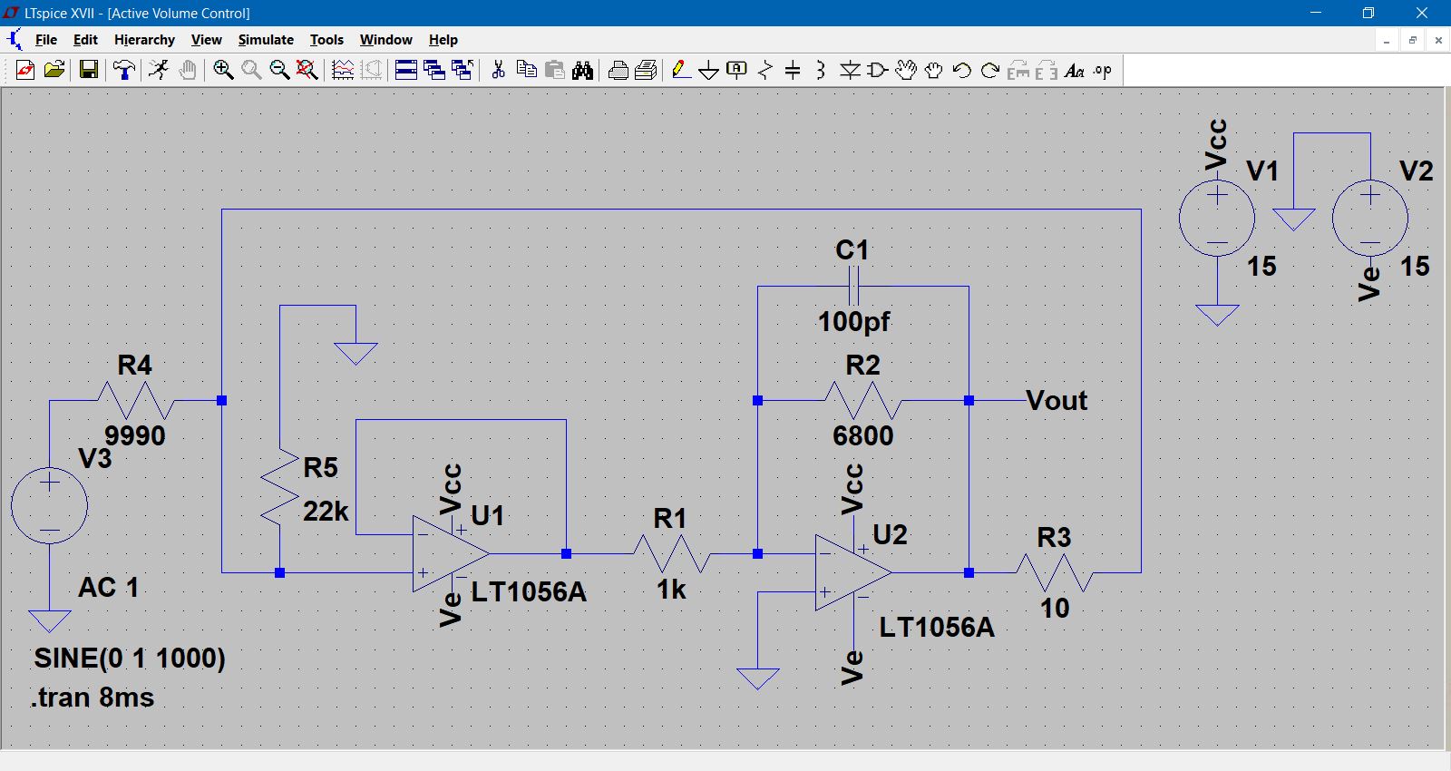

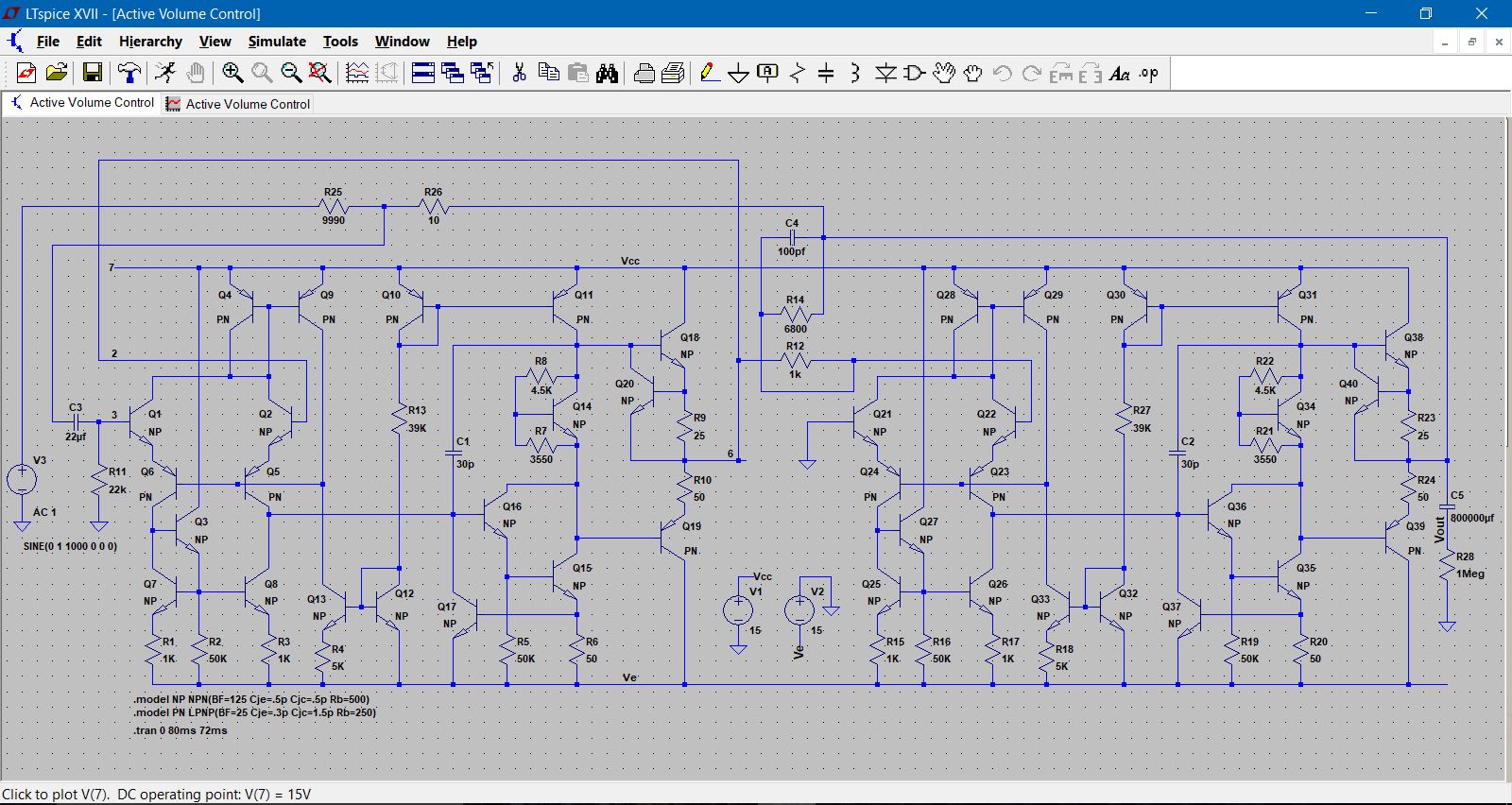

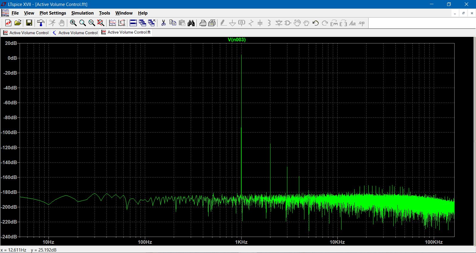

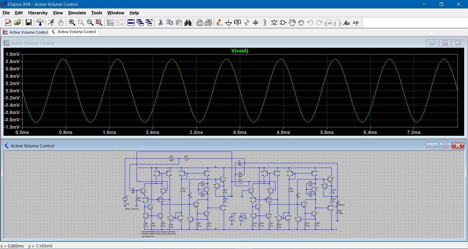

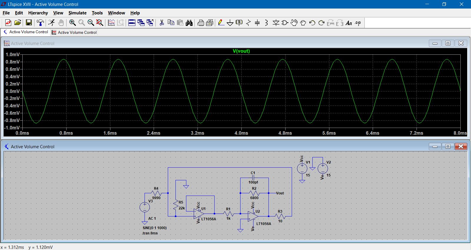

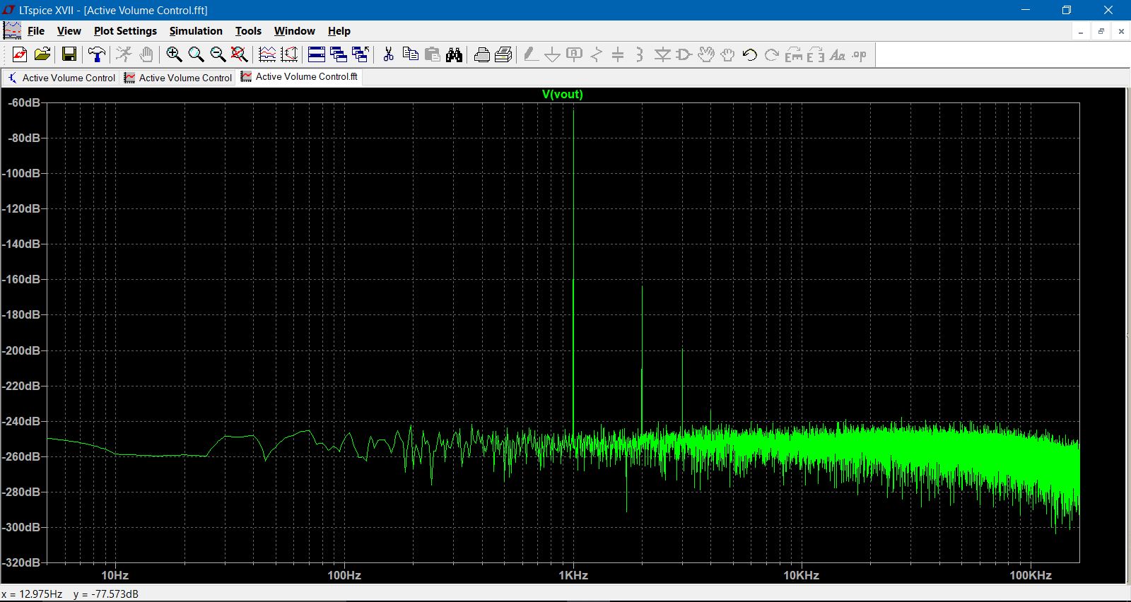

I don't know if this is a help or a hindrance but LTSpice includes a 'real' opamp made from discrete parts in the examples. OK, so its a 741 type but non the less......

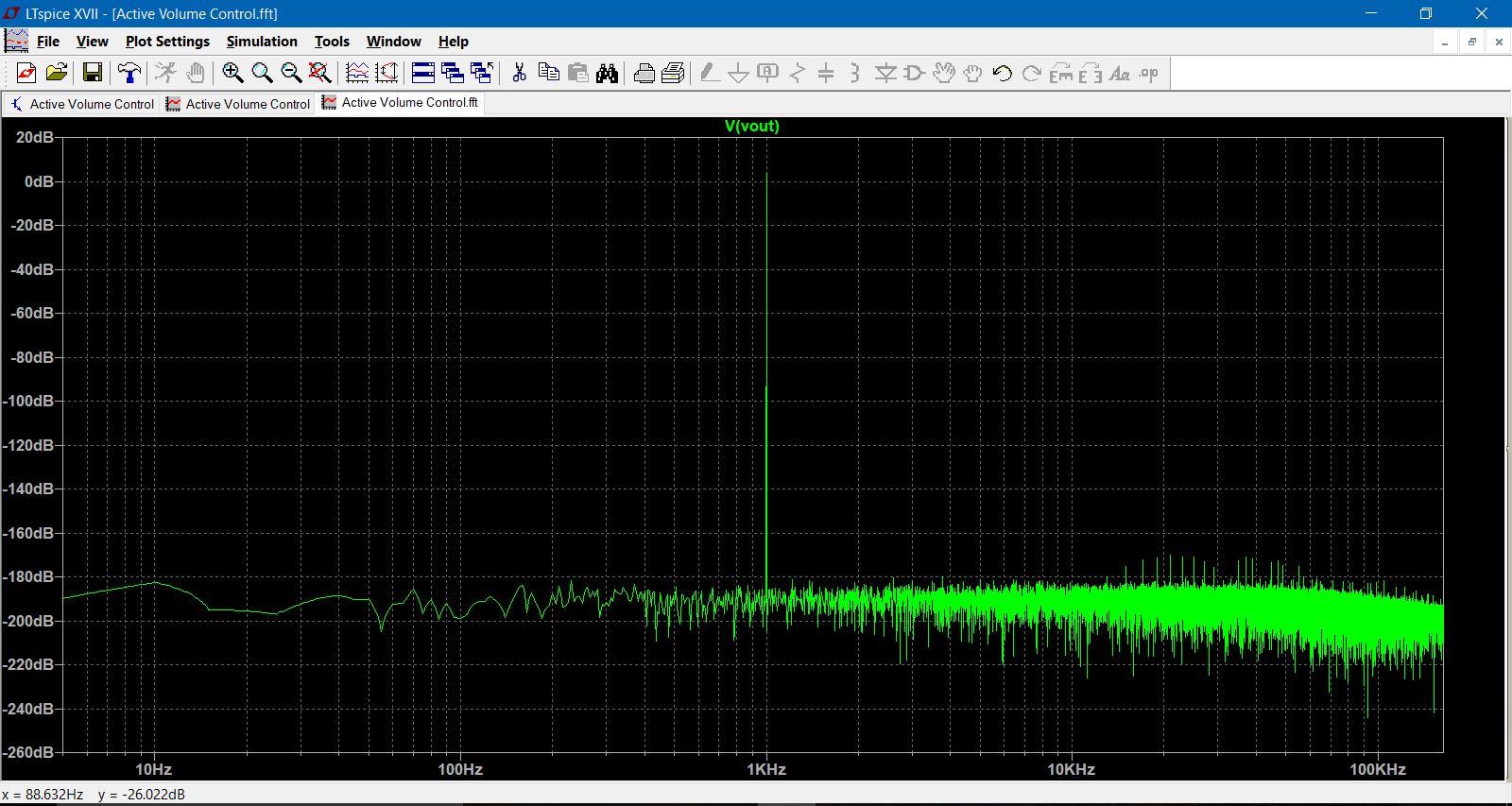

Here are two examples of the active volume control, one using standard opamp models included with LT and one using the discrete opamp. The output stage current of the 741 was set to 1.7 milliamps.

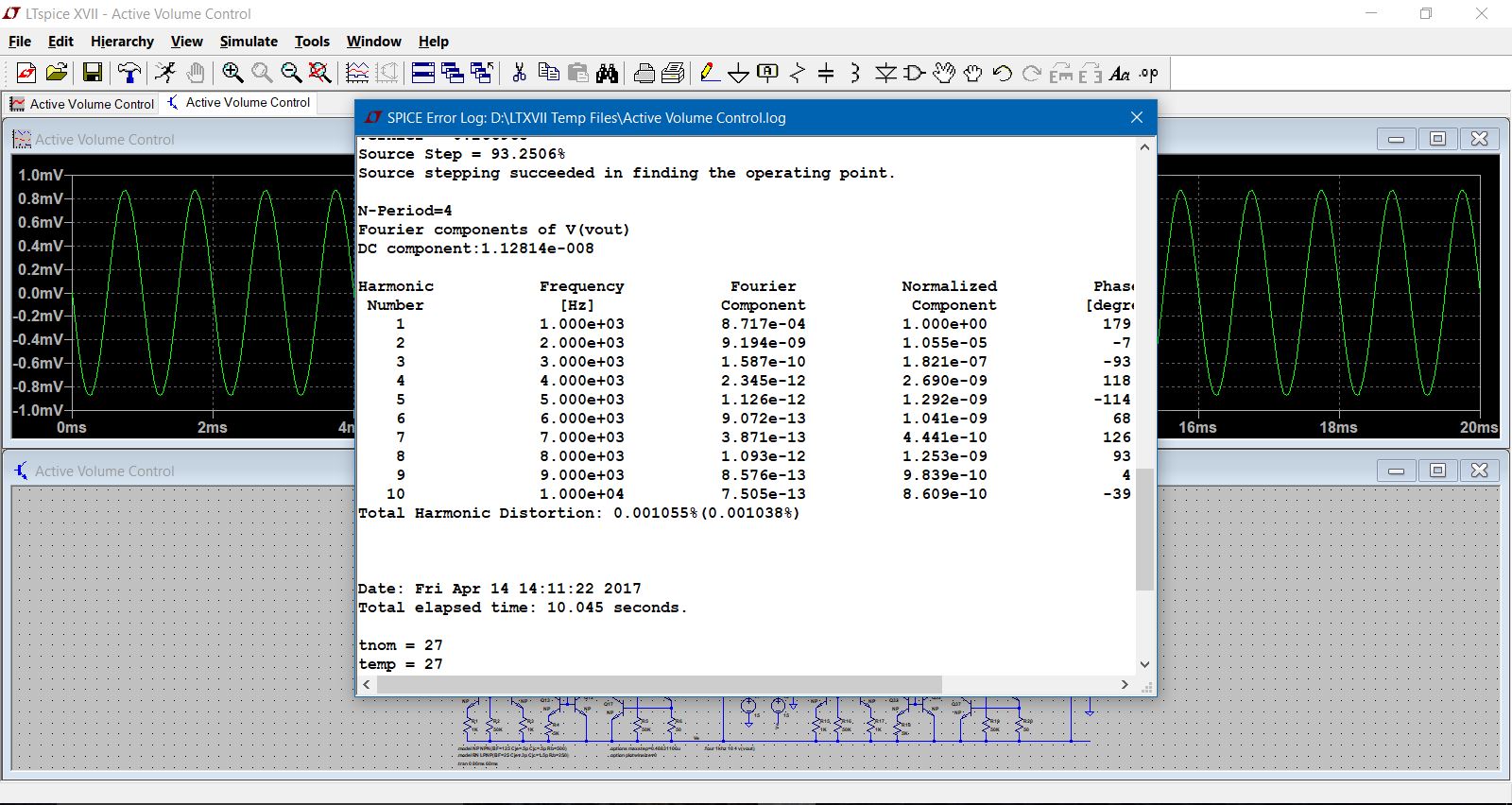

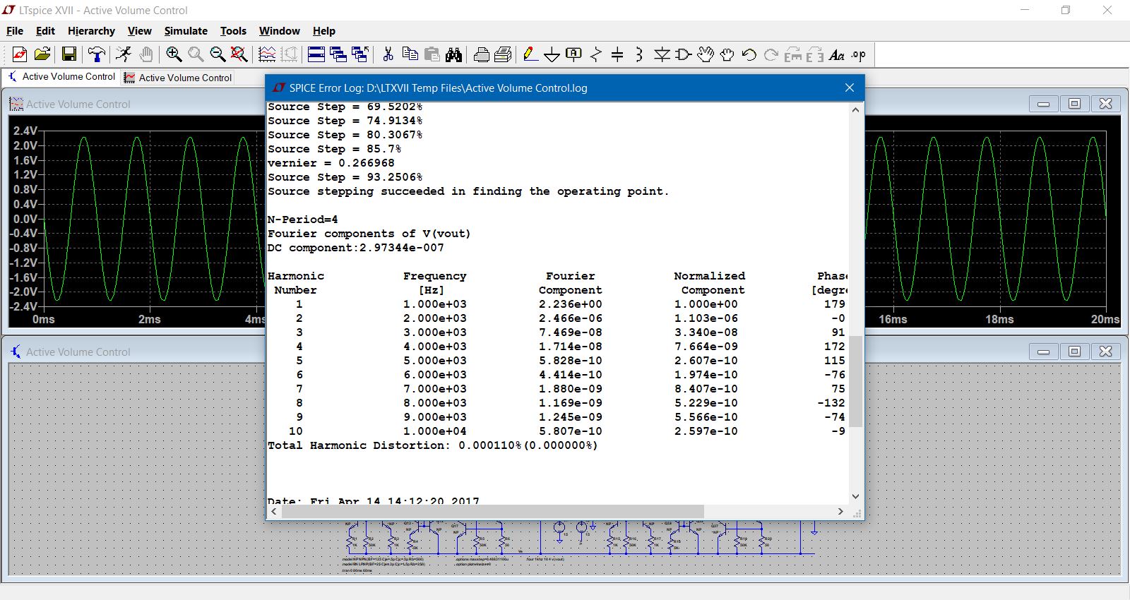

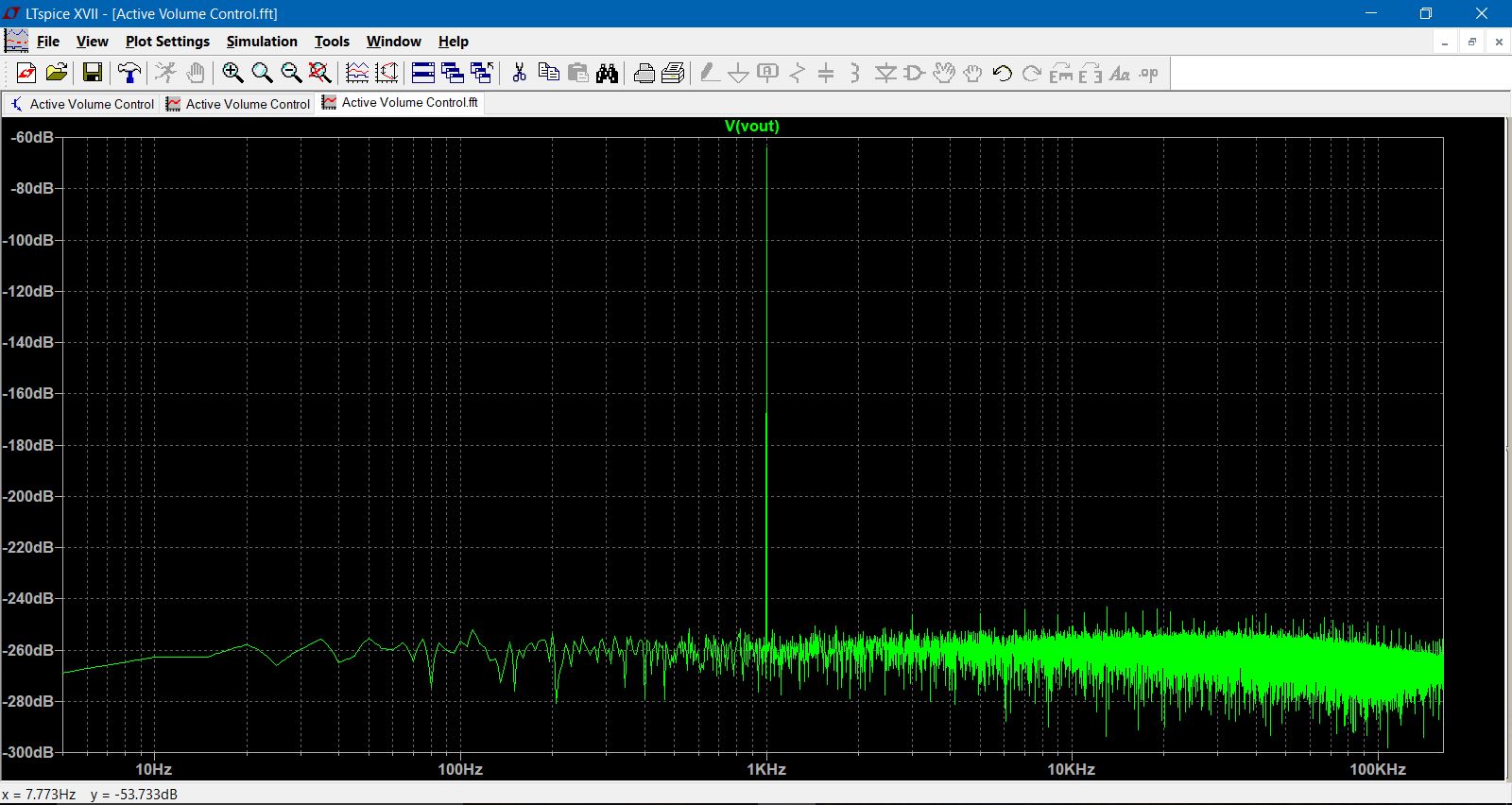

The images show in order the circuit setup, the output voltage and the FFT for both versions. The last two FFT's are with the attenuation factor altered and the 'pot' setting resistor at 2000/8000 ohm.
The distortion results (final two shots) show that the distortion does indeed rise at high attenuation for the discrete opamp... but as to whether this little experiment is useful or not I wouldn't like to say.
