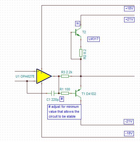

While the circuit you show does remove crossover distortion it is not suited to driving low impedances.
What I have attached can drive 15V peak into 100 Ohm while leaving the Op-Amp essentially unloaded and offering under 0.2 Ohm open loop output impedance.
Note, due to the limitations of the software used to create the drawing I have to show the LM317 as a NPN-Transistor T2 (base = Adj, emitter = Out, collector = In). The boosted rails for the output buffer where needed to allow maximum level from the circuit. If a few lower clipping levels are acceptable the rails can be shared.
This circuit originated in the 1980's as line driver for use with a 1:1 output transformer in studio electronics, for use with a special german "Audio" Op-Amp (the east german B761 which in turn was a copy of the TFK TAA761) that had an Open-Collector Output.
I do also seem to remember that we loaded the "Comp" Pin of the Op-Amp to ground and assymetric supply rails, but memory gets hazy now and I have not seen the original schematics in well over two decades. The original easily drove well over +20dBU into 200 Ohm at very low THD.
If sufficient heatsinking is employed the quiescent current can be increased from the 150mA present and even as much as 15V into 16 Ohm can be handled at 1A Iq (yes, that is 30W dissipation per channel).
If using a genuine 5534 this buffer may be attached to pin 5 instead of the output.
If using modern Op-Amp's with rail-to-rail output or diamond buffer output the bipolar transistor should be replaced with a low capacitance (e.g. IRF610) Mosfet and the polarity should be flipped (N-Channel parts are still better than P-Channel ones)
Ciao T

While the question "why not discrete" is valid, often the discrete circuitry becomes way more complex than the Op-Amp plus Buffer and performs less well.
For example my original 1980's B761 & SE Output Buffer replaced a by far more complex circuit with by far more parts and which needed a larger, airgapped output transformer with more windings that performed by far less well objectively and subjectively. No doubt, the discrete circuit could also have been tuned to give better performance, but from a manufacturing viewpoint it was a better choice to go integrated.
Speaking of the low impedance Baxandall Volume and Tone Control, if one was not slavishly committed to absolutely bodging a NE553X into any application, by whatever means and hook and crook, one could have looked beyond the rim of ones plate for better suited Op-Amp's.
For ONE example one could have used a pair of AD815 per channel. One as inverter for the balanced circuit, one in the volume control, one (without extra buffers) in the Tone Control and one as buffer preceding the tone control.
The AD815 will happily drive 10V peak into 25 Ohm with 0.005% THD and no rise in THD up to 30KHz and it will manage 10V peak into 100 Ohm with < 0.0005% THD at 20KHz...
Ciao T

Is the crossover distortion of the 5532 really an issue ?
In his book on (active filters for) crossovers, p.393, D. Self give some distortion numbers for an output of 9.6 Vrms on a 680 Ohm load at 1 kHz of various follower configurations of 5532 : 0.00018 %, worst case.
Hi forr,
This is a fair question. I have addressed concerns about the phenomena of distortion in the Baxandall volume control when set to low levels, but have not addressed the relative magnitude of the problem. Since we are talking about current-induced distortion when the output signal voltage is almost zero, I don't think we can draw many conclusions pro or con from the distortion created by the 5532 when driving a high voltage into a 600-ohm load. For one thing, the high signal voltage greatly dilutes the THD created in the case I descibed. For another, the high signal voltage case does not let us separate out voltage-induced and current-induced distortions.
If one were to really wave their hands and suggest that worst case all of the 0.00018% distortion voltage would also appear due to signal current when the output of the op amp were driving a load with essentially no signal, and one were to say that the baxandall control was set to -40dB with respect to a nominal signal level, then MAYBE one could argue that the relative THD % could be nearly 60dB higher at 0.18%, but this is an extreme stretch.
The best way to do it, in my opinion, is to operate the line stage at nominal signal level output of, say, 1V, then reduce the volume control to -40dB, obtaining a signal level of 10mV. Then look at THD of that signal at both 1kHz and 20kHz.
Bob
