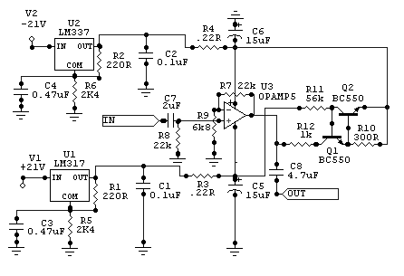

I guess this is worth a look:
How about that thing? I couldn't find it for NE5532. In the schematic is actually NE5534 also using a slight gain, but it is biased towards class A, tested "known good" and it looks both accessible and readily doable.
