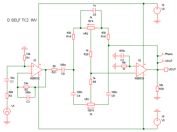

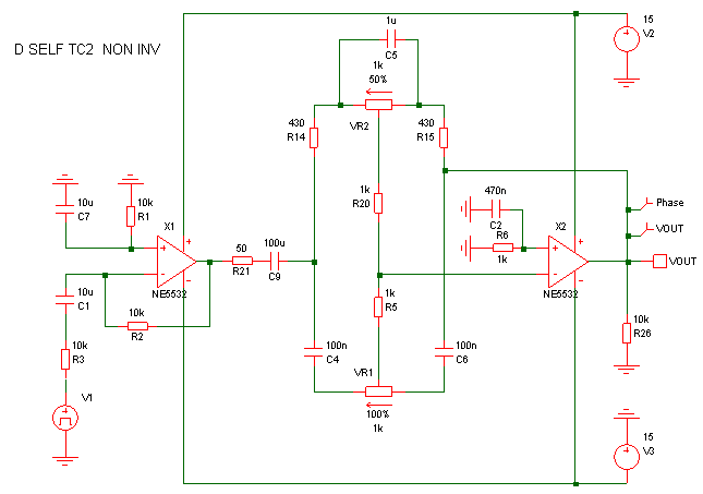

Those are the values that Doug Self used.

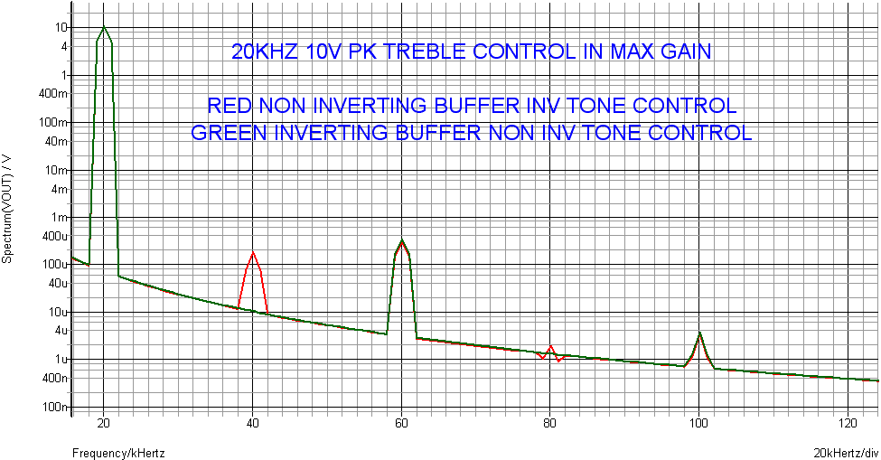

I did add a buffer in two versions , inverting buffer so the whole circuit
is non inverting , and a non inverting buffer that will left the circuit
as an overall inverter.
Of course , the buffer is a NE5532.
I would point that the current requirements of doug self circuit
are overkill , i would increase the baxandall impedances by a ten
factor and this would be still relatively low.
Good, we now have a more objective discussion going, if of course we can hold ourselves back from sleighting other people and their designs out of hand.
The input of TL's tone control stage does not need buffering. It's the opamp output that needs to be buffered. And, you can use jcx's neat to bias the OPA6x7 into class A.
Now, this arrangement would holds the prospect of of 0.005% distortion at 20KHz with full treble boost.
Wrt to the Baxandall tone control, it is well known that this must be fed from a low source impedance, and for this you can use an opamp or a suitable discrete circuit - there are many fine examples. Also, it is a very simple matter to arrange a bypass for a Baxandall such that is is 0 (zero) effect on the input signal.
