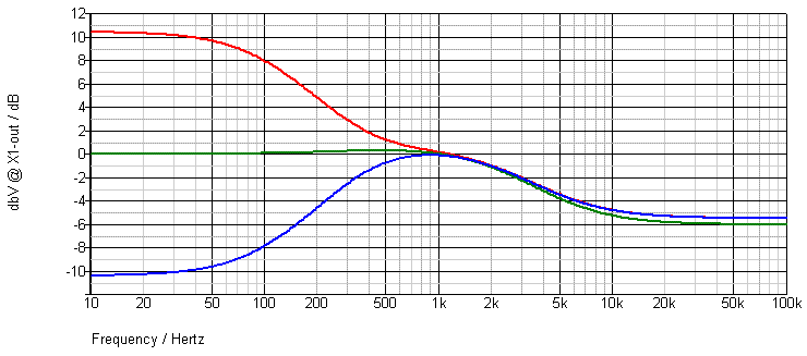

Do the boost and cut curves return to unity outside of the audio band...

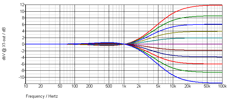

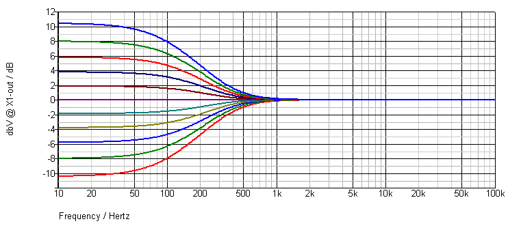

Nope, it's pretty boring, simple boost and cut above and below 1KHz. The treble control is one of those that cuts the midrange when boosting the treble (and vice versa), and turning the bass control to either extreme reduces the effectiveness of the treble control, but both effects are small (less than 1dB).
I was amused to see him getting the treble control null spot on 1KHz, using bog standard values. 😀

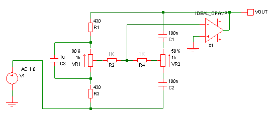

The circuit I used is slightly simplified. The feedback network is identical. I just left out the opamp overkill, assumed everything is driven from zero source impedance and ignored pot wiper resistance, so there are probably slight errors, but nothing to get excited about.

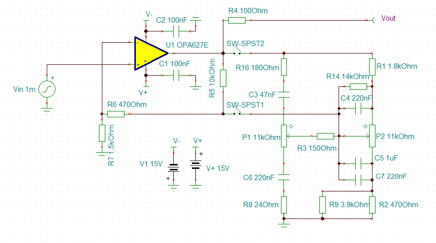

The shape of the curves, what happens with partial boost or cut, interaction between the controls. Different versions of the Baxandall controls actually behave quite differently.
I'll do some sims now to get an idea, and post the results when I'm done.

Torsten, show us the distortion graph for the circuit you posted earlier. Before dong that, take a look a Samuel Groners site and read up on the device.
0.05% at 20kHz 7V is high and completely avoidable. That's 500ppm.
The OPA6x7 is quiet and the bias currents are low, but it does not drive loads very well.
What is the load current on the devices output at HF when your tone control is set to the worst case position (wrt load current)? Have you simmed or measured your circuit?
Hi
First, the circuit is a concept, which I made clear in the original thread. The performance of the OPA627 in this circuit is easily predicted from the datasheet and circuit by anyone "skilled in the electronic arts".
You can read circuits, right? The effective load at 20KHz is 530 Ohm and the minimum HF load is 450 Ohm.
