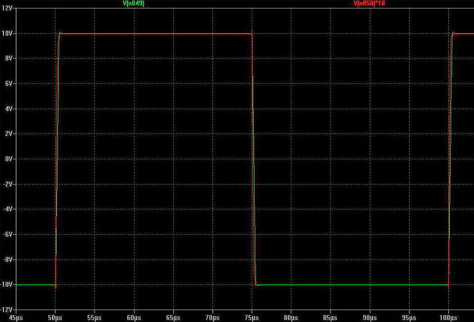

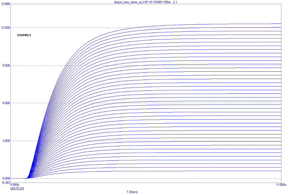

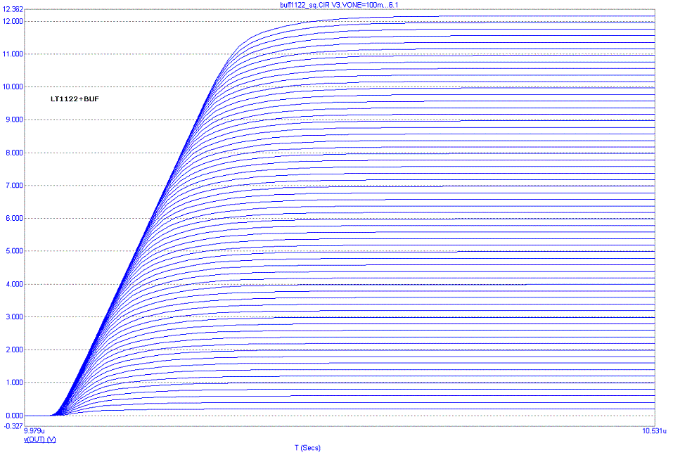

PMA said:But the opamp approach is what I want to avoid, I emphasize speed, no slew rate limitation = consistent transient response for all amplitudes
A slew rate limitation does not = an inconsistent transient response for different amplitudes.
Aline Nakashima
Glen, consistent for me means that step response with 10V amplitude is exactly same as 10 * 1V response. Not a case for slew rate limited circuits, as shown. No input RC aplicable. Even if yes, PIM remains. Sorry I will not argue more, being quite busy now.
PMA said:Glen, consistent for me means that step response with 10V amplitude is exactly same as 10 * 1V response. Not a case for slew rate limited circuits, as shown. No input RC aplicable.
In post 2361 here:
http://www.diyaudio.com/forums/showthread.php?postid=1507034#post1507034
I already demonstrated that this claim is false.

PMA said:You have demonstrated nothing. You would need 10x more resolution on time axis to demonstrate anything.
LOL!
If you say so.
Attached below is a plot of a 20kHz square wave output of 10V peak of an opamp that slews 40V/us against a 1V peak output magnified by 10.
How is this a degree of step response inconsistency that can have any bearing on the fidelity of an amplified audio signal?

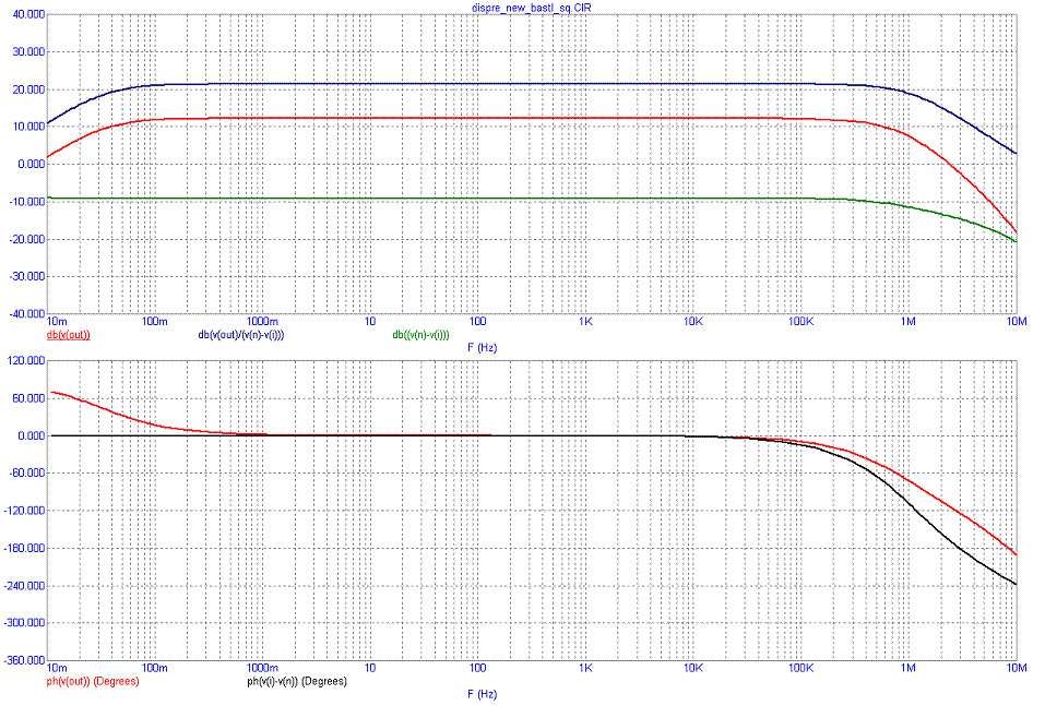

PMA said:For those who read in Bode plots:
The input stage does not behave much like standard LTP - remeber you do not know the resistor values, that are key factor to this preamp. Also, see small difference between Adiff and Acl - there is nothing to keep very low DC without servo. In case you afford DC offset like 100mV - 300mV, then you do not need the servo. I want the servo, and I see no sonic problem when it is applied.
