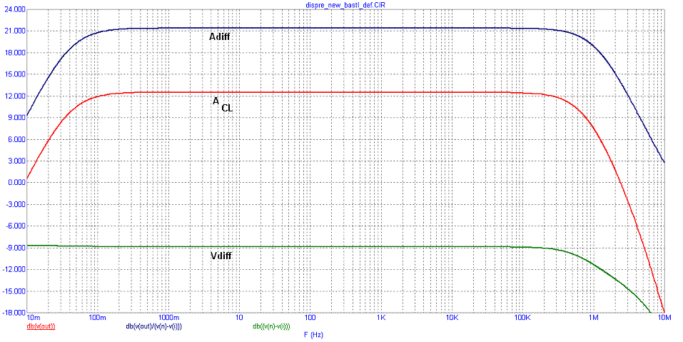

I have no chance to measure THD 20kHz with good resolution. The measurement at 10kHz was done by a colleague of mine, not me.
I have measured THD 100kHz and shown it earlier in this thread.
Regarding BW - in this circuit, small signal BW and large signal BW are quite same, again, it indicates that the circuit is not SR limited, it has RC like step response for all amplitudes, with same rise time, as again shown in the beginning of the thread.
And yes, OLG corner is quite high.

robmil, the PCBs + documentation would be possible to purchase in a 2nd production round, no sooner than end of August. The price would depend on a production lot. The schematics with component values will not be released. I do not have good experience with releasing of schematics with component values.
float, regarding gain, the input resistor network has to be recalculated (I am not intending to make it), as MaxS has already stated. BUT - for the reason of high degeneration and resistor bias of input stages, the gain of this circuit cannot be calculated as feedback resistor ratio . Surprisingly, the gain is different and considerably higher.
PMA said:... regarding gain, the input resistor network has to be recalculated (I am not intending to make it), as MaxS has already stated. BUT - for the reason of high degeneration and resistor bias of input stages, the gain of this circuit cannot be calculated as feedback resistor ratio . Surprisingly, the gain is different and considerably higher.

I have only one customer for Dispre II in England. In case it is you, we can discuss possible gain change in private e-mail.

I sent you an e-mail in the morning, with recommendation to change resistors in input divider (R60/R3, R62/R29)
