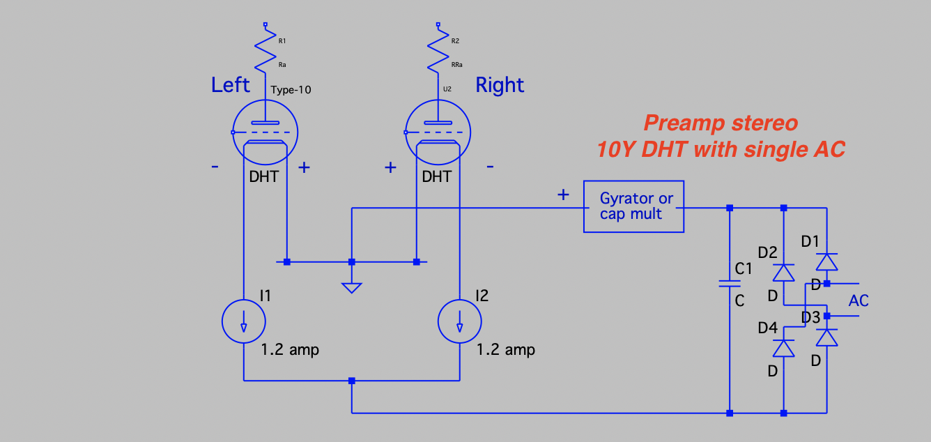

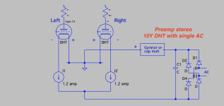

Yes, if you can make good high-impedance current sources, it is worth trying. Please watch out for the safe-operating area for the cap-multiplier transistor, and the size of its heatsink.
I used to see from time to time, schematics where the cathode connection was through a split cathode bias resistance with higher R from ground to the plus voltage end of the filament in an attempt to even out the cathode current emission from end to end. If I recall correctly, one of your early posts on this thread had that scheme as well. (IIRC, splitting into a Y about half way up the Rk.)
I haven't seen it on any recent designs. Did it turn out to be more wishful thinking than effective design?
Yes, I did make them like that for a while, maybe more than twelve years ago! But I found that for many constructors, myself included, the single-point connexion to ground (or Rk) usually wins the listening tests - especially if you have loudspeakers that can take advantage of the wider and taller stereo space.
Would a Keantoken circuitt be useful @ 2A rating as CM? It floats but is high impedance too. The basic is a darlingnot instead of a darlington, with a special buffer circuit.
The cap-multiplier could be a CFP (Szlikai) circuit, if you have the time to build and measure.
I did not find any advantages (with the transistors tested) at these higher currents.
CFPs also need care to be sure there is no instability, which is no advantage at all! At lower current, which IIRC the Keantoken addresses, the control- and the pass- transistors are dynamically close in behaviour, and this makes stability less troublesome.
Yes I remember that Kean described such difficulties and some have been adding a cap between emitter and collector - strange having to to remedy it that way.The cap-multiplier could be a CFP (Szlikai) circuit, if you have the time to build and measure.
Nevertheless, in amplifiers like Le Monstre by Jean Hiraga the CFP works flawlessly, I had it running at > 1.2 Amps (within a closed loop of about 500KHz).
