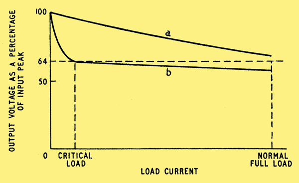

I have several power supplies which in the end all did end up in being altered to a choke input. I mean a true choke input with a minimum current related to the mH rating of the choke.
My line pre amp has a very basic lm350 regulator for heaters. A year ago i did add a choke input with a Lundahl LL1694 40mH 3 A. The lm 350 will be replaced by Coleman circuit.
Most circuits i use have shunt power supplies and all did have chokes in the power supply in CLCLC. All have been changed into LCLC.
Taking care of enough current through a bleeder.

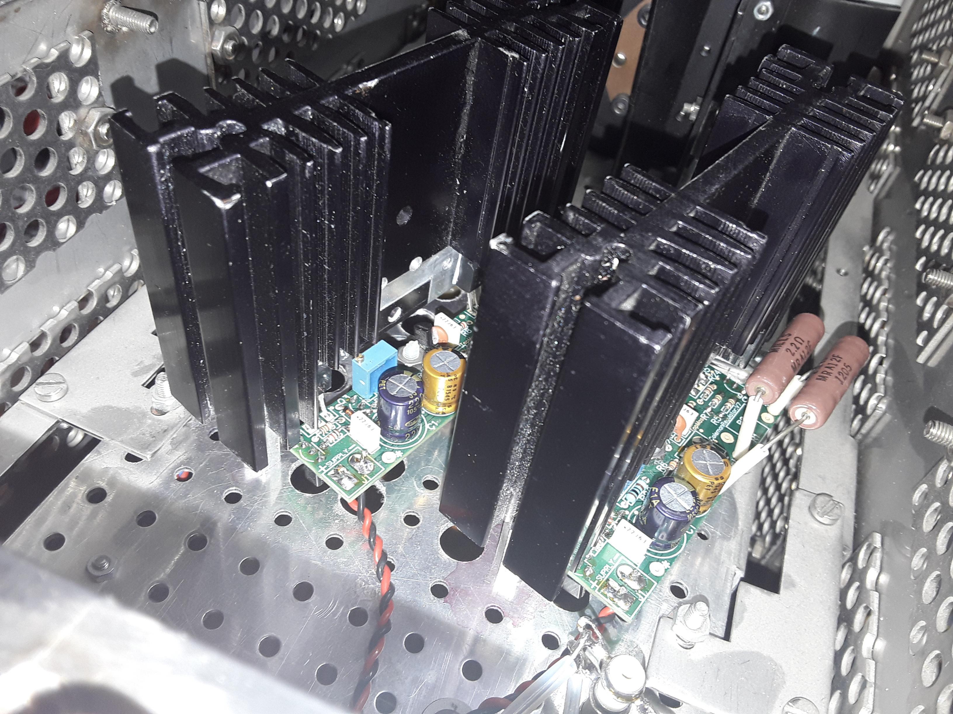

It took more time than expected to install the boards!!.
NOW i have both boards being fed by a choke input power supply. 40 mH 22000µF ( with 39 ohm bleeder) 0.22 ohm in negative and positive lead and then final 22000µF feeding two boards. Both boards loaded by a 6.8 ohm 25 watt and trimmed to 6.2 volt output. Input voltage to the board is 11,4 volt. Voltage drop across 0.22 ohm is 340 millivolt if i remember well. I could skip one of them but probably i will just leave it like that.
The only thing getting hot now is the 39 ohm 12 watt Mills bleeder about 80 degrees but will be higher with chassis closed.
R1 and R2 around 40 degrees, two transistors on heatsink 30 degrees
I thought RV1 would have a kind of stop haha. So i will just turn back 15 turns before installing the 5687 tubes. Tomorrow i will connect the tube sockets.
I will connect them ( left/right) identically. Pos and neg to the same pin on the tube socket.
greetings, eduard
Hello,

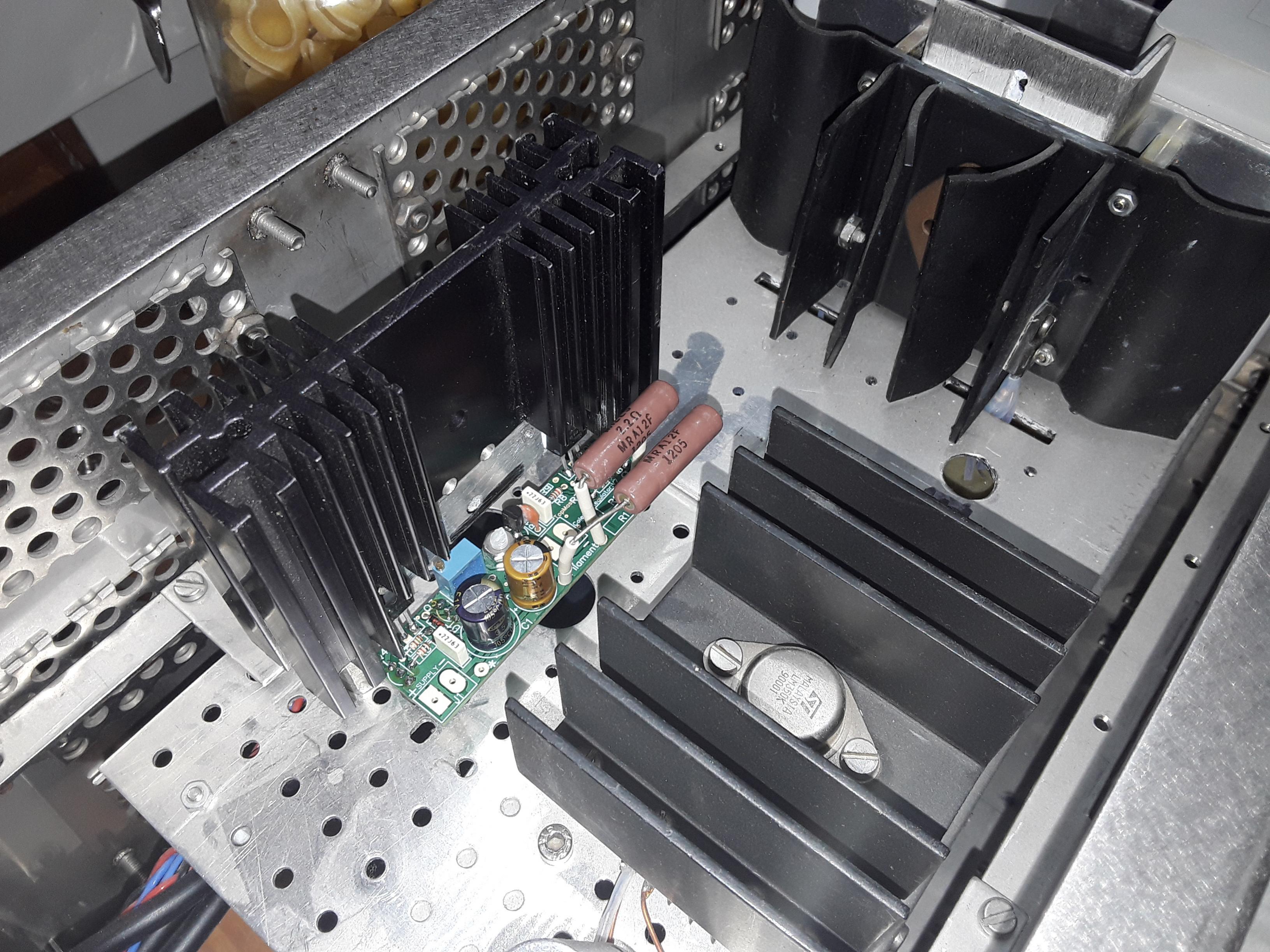

Forgot to include to photos.
One is the new regulator and the old lm350 for two 5687 tubes.
The other one each 5687 it's own regulator. Now still wired to a25 watt resistor for testing. Nothing reaches more than 40 degrees Celsius except the 12 watt mills bleeder
Greetings,Eduard
P.s yes the heatsinks are big but I had them in stock. It was not 100% clear if the smaller ones I had would be big enough. Most electronic parts will cease to exist because of exposure to heat.....

Changing from Cap-input to choke-input can reduce the noise coupling from this dc supply to other (more sensitive) parts of your system, like the DACs, or MC preamp stage - and that could give a better overall sound.
