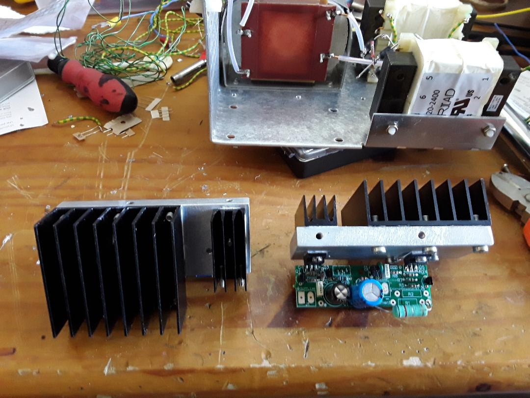

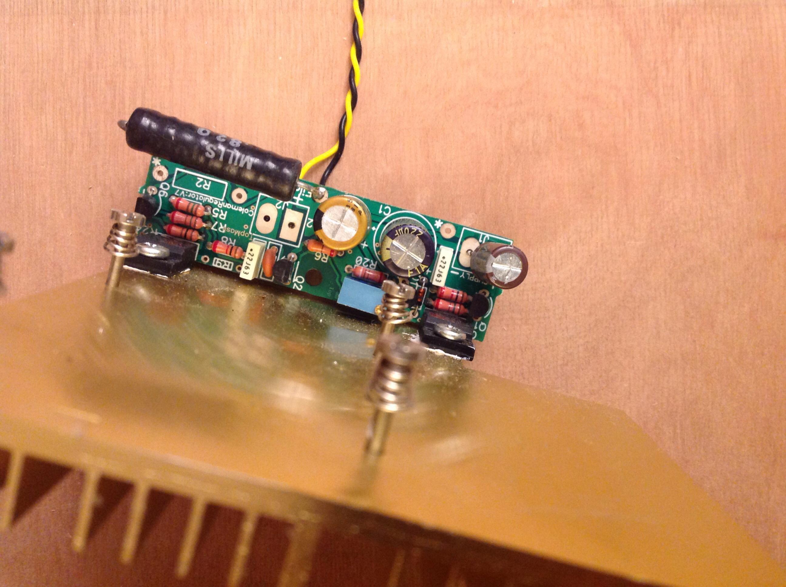

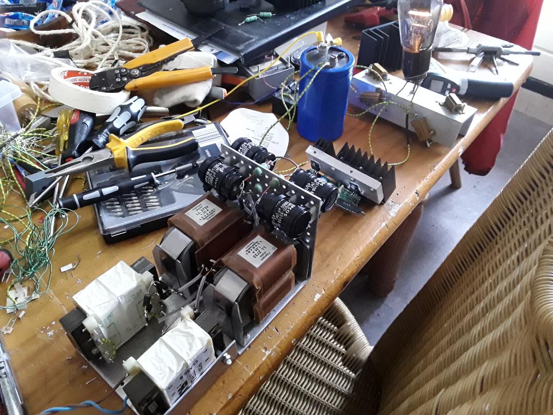

Hello All,
I think I'm doing something wrong with my Coleman Regs.
I am building a Type 26 preamp using Rod's regs for the filaments (one per channel). I have been trying to get rid of the hum, and after putting the whole audio circuit in a heavy steel box, I noticed I still had some residual hum. This hum is actually tolerable, and only really noticeable if I stand right at the apex of the room's 60Hz node.
I tried an experiment yesterday that highlighted a problem in my build. I replaced the Coleman Regs with a 4R/10mF RC network to see what would happen.
The hum and most of the tube hiss went completely away! The preamp is far more quiet than it ever has been! The only problem is that without the Regs in place I get a bit of oscillation that manifests as very slight woofer dancing, and an occasional "blocking distortion" -like signal cut-out with an accompanying low frequency noise-- like a "whump." I put the Regs back in, but keeping the additional RC network, and the oscillation is gone but the hum and hiss are back.
Question is: What have done wrong with my Coleman Regs? Or is the rest of the circuit that is causing the trouble?

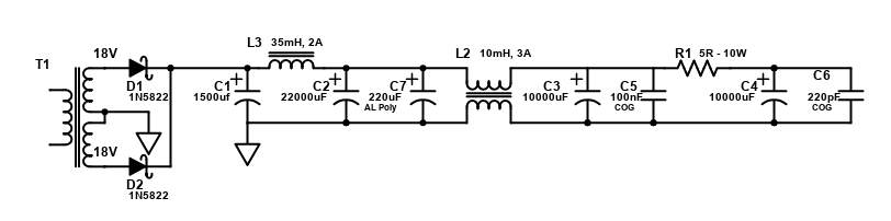

My Raw Supplies are cLC-cmc-CRC built using:
18v split-bobbin transformers-->Full wave Shottky (two 1N5822)-->1500uF cap-->35mH 2A choke-->22mF ALcap/220uf ALoragnic-->10mH CMC-->10mF ALcap/100nF COG-->5R-->10mF Alcap/220pF COG
This gives me about 18.5V raw/rectified DC.
My Filament Regs were built as per instructions (very thorough PDF) and I get roughly the expected voltage out (about 10.8V). I can adjust current from 800mA up to 1.4A or so. They seem to be working. My leads from Reg to filament are a little less than 250mm tightly twisted 18ga (1mm) solid-core. Heatsinks are adequate. Nothing gets too hot.
Any thoughts?

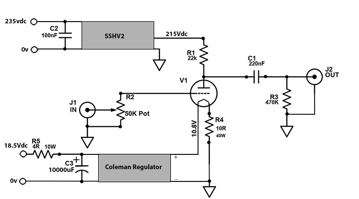

To help understand the problem, here are the schematics of the Filament Raw PSU and the preamp circuit as it stands.
The preamp is in a temporary state, RC coupled, just to play around with while I wait for the output transformers to arrive.
I certainly hope no one builds the schematic below!!
