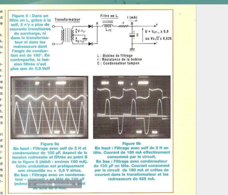

Hello,
Maybe i posted this one before but still could be interesting to members.
Article from a famous french engineer where you can see differences between choke and capacitor input when used to supply a 180 ma current.
On the left top choke input bottom cap input. On the right the current demand with choke input around 180 mA as requested by the load. With cap input switching between 180 and 425 mA. These peaks also occur in the transformer, diodes and the wires taking care of the connections. And this is only 180 mA most heater current are much higher.
So one more reason to use a decent choke input.
Greetings, Eduard

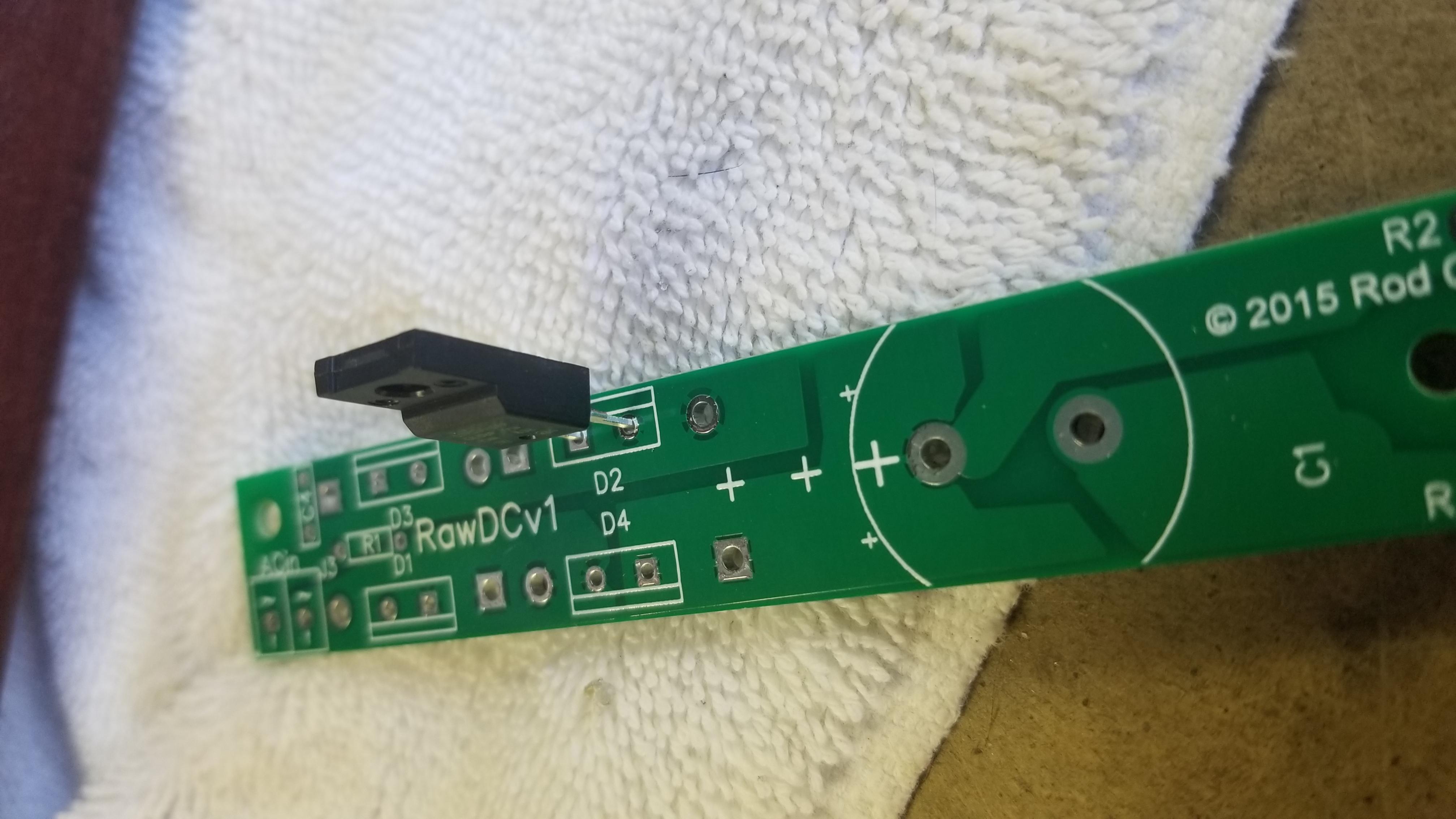

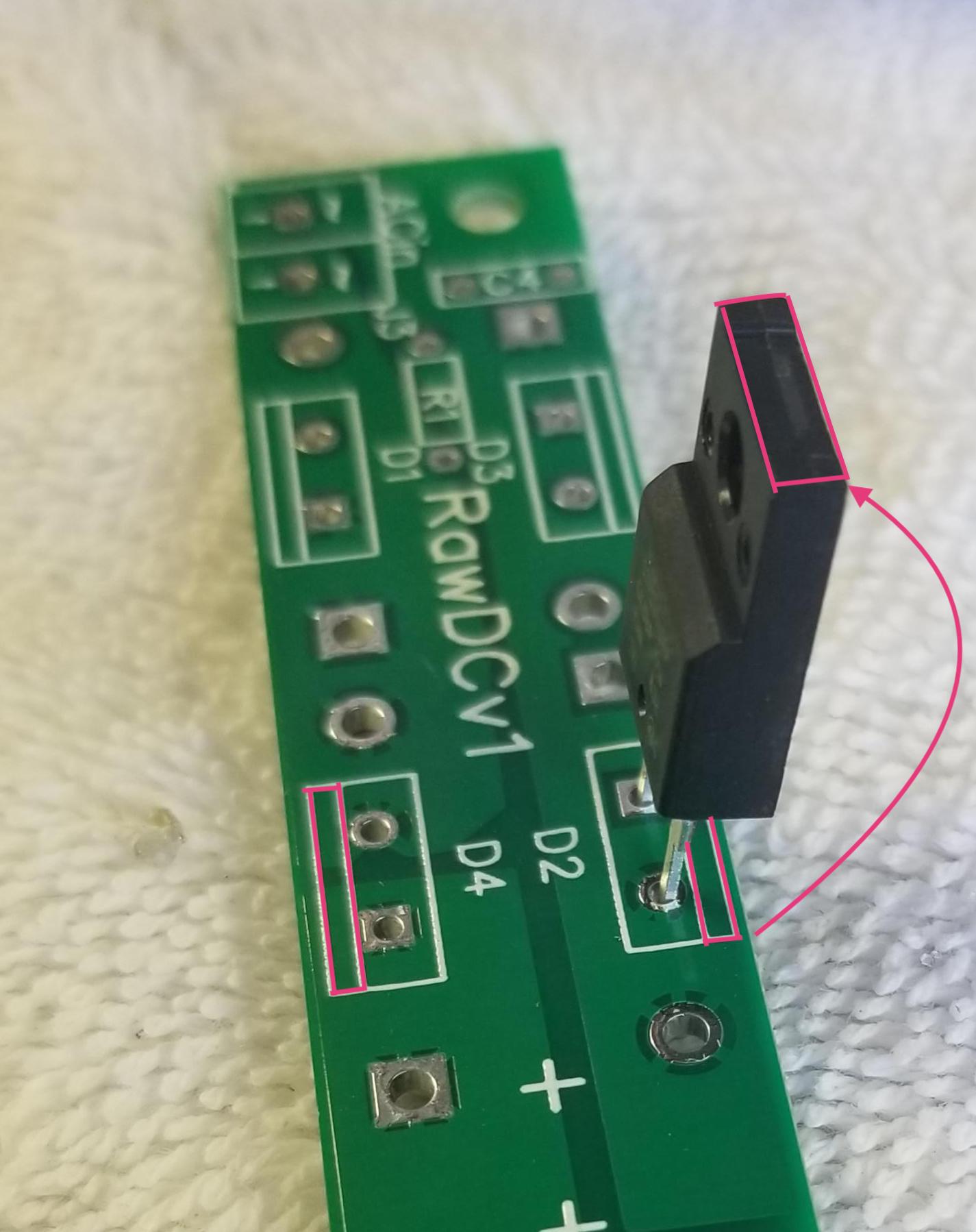

Hi Rod and all, I just got the raw DC boards and populating them and ran into an issue. I'm using the TO220 rectifier diodes and don't know how they go on the board. I "assume" the taller mount tab go toward the back where the diode line is but that is just a guess.
Your assumption is correct. That is the way you should put them into the board. Basically the line is the indication where the tab is that should connect to the heatsink.I "assume" the taller mount tab go toward the back where the diode line is but that is just a guess.
Assuming the diodes you are using have the same pin-out as ones that Rod recommends then the pic is the orientation.
I hope I'm answering the question you are asking !
Thank you for stepping in with the perfect answer!
Thank you, Bas!
