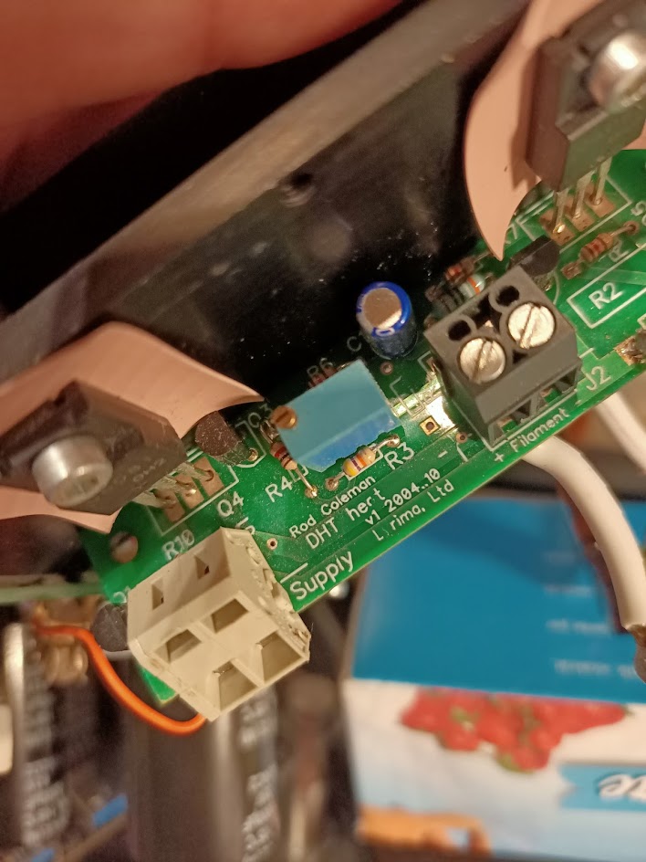

New DHT heater
It's some kind of v1 🙂
Thanks for the PDF.

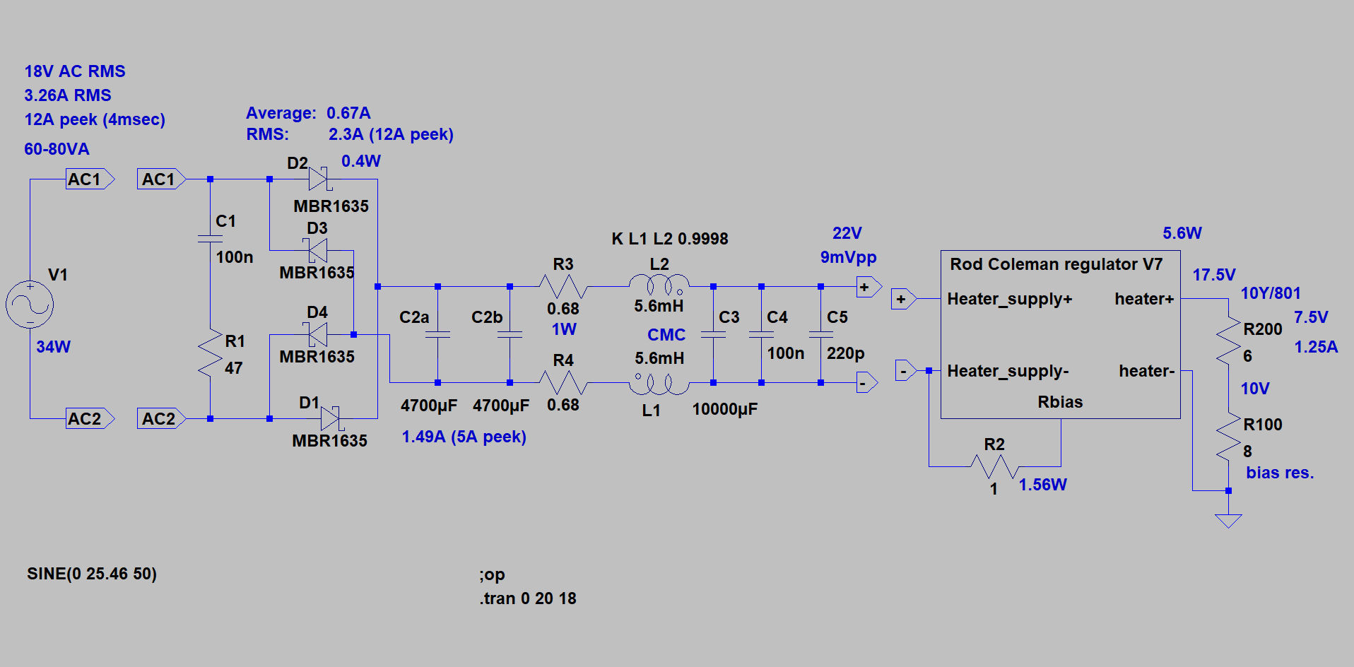

I am working currently on the raw supply (without regs at the moment) and to understand what does what, I tried the weekend 80mH choke input (7.5V, 1,25A) vs. choke inpit with two split coils in differential mode.
Hmmm...interesting. It changes the sound. Brighter. Tighter. Stiffer. Maybe more resolution, but as well less warm tone...pick your poison I would say. Does anyone have a bit more experience with the differential setup va. normal PSU ? Any explanations why this sound that different ?
I usually use this type of raw supply PSU for 10/801 tubes.
For me C-CMC-C give better sound, than C-R-C (lesser noise on R.C input).
I tried "classic" L-C type, but requires larger secondary voltage and the choke is too big ... and -for me- it doesn’t add that much to the sound, only a little different.
I've curious - why the 0.68R, surely the CMC would be CLC configuration?
I use it only for decreasing output voltage of the row supply.
I have two box configuration: raw supplies in the PSU box and R.C. regulators and Ale's "gyrators" in the preamp box.
The latter (and the filament bias resistors) dissipating quite a lot, so sharing dissipation is necessary.
