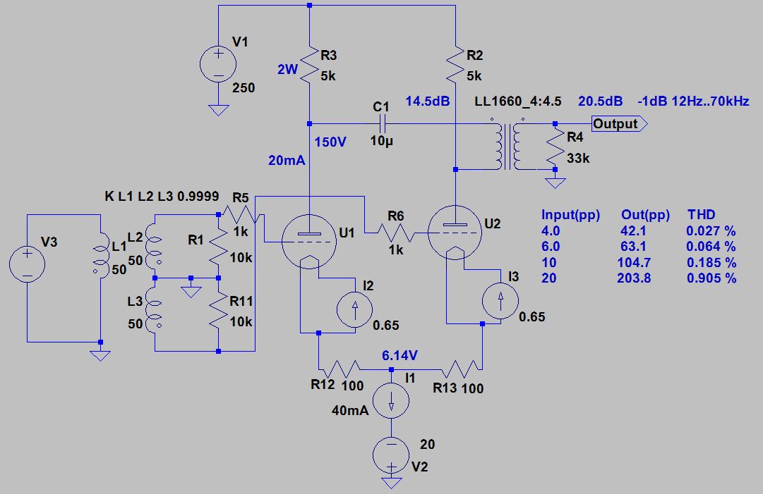

I'm thinking of using 4P1L tubes for the drivers.
4P1L diff driver gain is not too much, with parafeed OPT the overall gain is about 20dB.
If you use 01A as input tube (about 17dB with Ale's gyrator), the gain is -about- 70, so you need some attenuating.

I started out with three stages, but with my Mark Audio Alpair 10s in a smallish room I found that PSE 4P1Ls are just enough as outputs, so ended up with 2 stages, first being the 01A Gen 2. I feed them with a ES9023 DAC and it needs all the output that gives - around 2v probably. Nice to manage with 2 stages if you can, and in my case all filament bias. I use twin 4P1L outputs, but three is possible or you can go PP and double up. Wise to wire the 4P1L filaments in series here, so less heat generated in the cathode resistors.

Intersting schematic...may I ask why you have introduced two 100ohm resistors between the ccs and the cathodes ? I have build as well a diff pair 4p1l-preamp, but connected the ccs straight to the cathodes...so try to learn from you...
