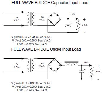

...seen that i have not CLRCCC But i have LCRCCC it is problem? ot is Ease to change to CLRCCC just cut one wire.
Hi. I would use Duncan Amps PSUD2 simulator. You can get simulator result real close to real result.
PSUD2

From the Hammond transformer catalog:
