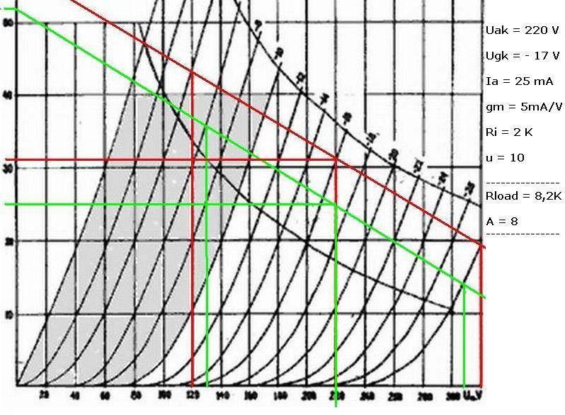

218 or 245 can't remember for sure.
Correct..... for -10V grid voltage and above 80mA anode current.....if you have a plan to melt 4P1L. 🙂
Between 220 and 240V and 20-30mA (-18V grid voltage on 28R bias resistor) are the safer operating points. 😛
I prefer lower anode voltage (for example 160V) and 30-40mA anode current (-10V grid).
I'll lower the b+. 🙂 Thanks.I prefer lower anode voltage (for example 160V) and 30-40mA anode current (-10V grid).
160 on the plate. Current is around 34mA. Thanks Euro21. [emoji2]
