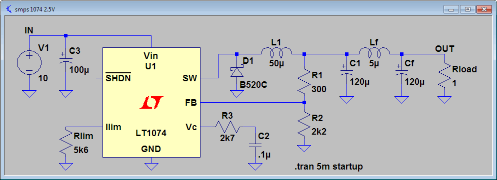

What about the attached regulator? (which, admittedly, I have not built yet..)
Feedback loop is closed before the filament, separated by an inductor. Values shown are for 2.5v @ 1Ohm (2A3).

5uH has such a low impedance at audio frequency that it makes no difference to the regulator interfering with the music signal. And the Elko capacitors are across the music signal (differential signal) on the filament.
Try using the same kind of chip (eg LT1084) in current-mode versus voltage mode, and listen to both ways. A purpose-designed current-drive regulator is better still, but this comparison will help to demonstrate why everyone loves this DHT upgrade.

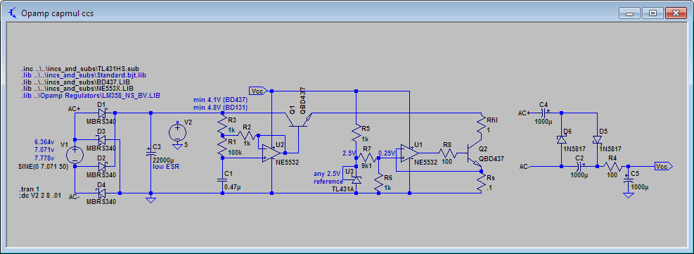

I read thru more of this thread and understand better now, I believe. Thanks. The basic topology should be:
Gyrator / cap multiplier -> Filament -> CCS(ink)
right? Look at the attached circuit, do you think it would work? I am not an opamp expert (not even electronics, to be precise 😀).. I was just looking for something to run a 2A3 from a 5V (AC) xfrmr. Your circuit needs a bit more overhead, right?
Current source, not voltage source
The whole point is to have the filament "see" a high impedence.

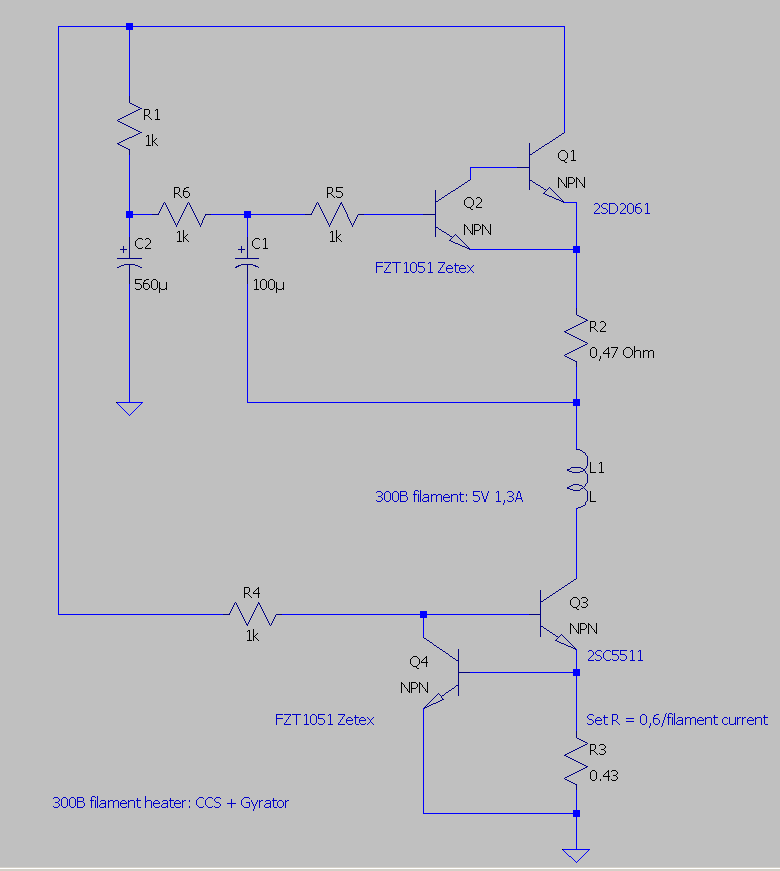

Hello
I have tried CS and gyrator with 6C4C, as you can see on the picture (found somewhere in this thread).
Did you ever observe what is going on with filament voltage when temperature of the tube is changing?
Try to blow some air on the tube, voltage is changing + 0,1 V and more V so we have over 6,3 V (I saw even 6,5 V).
When you power anode voltage tube is getting warmer and voltage is dropping down about 0,1 V and more.
I wonder if conts. current is the best way to power heater?
I know why you use CS and gyrator, I am afraid, it is the best way to isolate heater supply from signal path but not from filament power point of view.
For example, GM70 is very sensitive and require +/- 1V on the heater !
Does anybody care about heater voltage at all?
I've read almost whole thread and I can see only happy ppl with no hum in loudspeakers, and nobody is worried.
Did I miss something?

3 Separate things:
1. Drop of 0,1V when B+ applied.
Yes, this is expected. But the current should be adjusted to achieve the correct filament voltage when B+ is applied - no problem. Running without B+ is not normal use.
2. Temperature sensitivity.
Using a very basic CCS like the one in the picture has poor temperature stability. My regulator uses temperature compensated CCS to get stable output. Just set it up once, when warmed up, and the filament voltage will be will be consistent, even over long periods.
So you are right - CCS can be a bad solution for heating - unless the regulator is able to keep filament voltage stable.
In your solution, when you blow on the tube, cover the regulator, and try it.
3. Unregulated supplies
The real problem for DHTs is use of ac-heat, or unregulated dc to heat the filament. AC mains tolerance is ±10% here in the UK, (and other locations, I am sure). Running anywhere near these extremes, for more than a few minutes, will degrade the filament life-time, fast.
