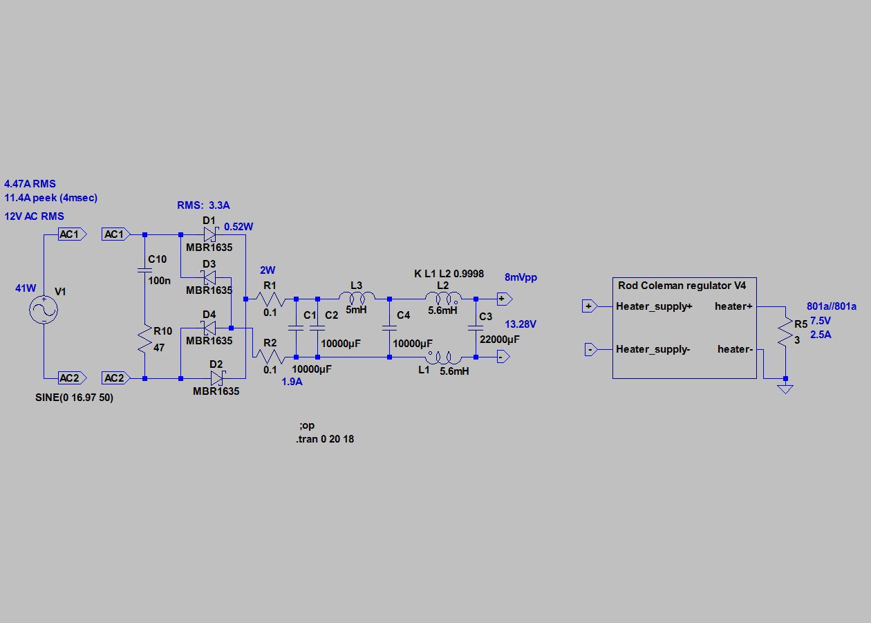

At 2,5A dc the rms current in both branches of the bridge-rectifier will be about 4,8A. So that's 2,4A per branch.
The 1N5822 can withstand an average current of 3A, but should be derated by 20% for capacitor loads - but it should be just about OK if the diodes are mounted on some PCB material, and well-ventilated.
If the case temperature of any diode exceeds about 80 deg C, add some kind of metal heatsinking (clipped in place)

This is my 2.5A heater PSU (paralleled 801a in my breadboarded PSE).
This is r-C-L-C-CMC-C style raw PSU. Power transformer is 12V/5A, graetz is built with MBR1045 diodes.
In my #691 post this is the panel in middle, and above this the -two- 5mH/0.1Ohm 4A choke.
Without large capacitors and choke I have audible hum.

Hi Disco,
As Bas wrote, 15000uF is not too much.

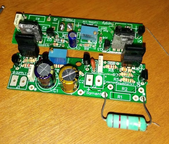

Hi Jaap, Yes, the V4 has a raised Q2; in V7 it's lowered - both cases to optimise the temperature tracking.
As for R1/2 - you could try a Mills MRA5 (nonInductive) - it's possible that higher quality parts are audible. At 1.2A+ the excess current-noise may be lower, though I can't measure any broadband noise from the regulator with standard wirewounds (uA level noisefloor).
5W MRA5??? Even at 1.25A this small ( 🙂 ) Mills will turn dark brown. 🙂
I use this resistors in max. 1.5-2W dissipation positions.
I tried 5W noname (russian and chinese) wirewounds, hungarian 16W Remix wirewound, Mills (MRA5, MRA12), Welwyn (W23 - 10W, W24 -14W) resistors.
The previous ones has very mediocre sound, 5W is too small, large Mills and Welwyn for me is perfect.
I think 12-14W resistor is in the safe side, especially when you use 2-2.5A regulator.
Finally I use in all R.C. regulators 14W Welwyn W24 (thermal resistance is 22 Celsius/Watt, up to 200 Celsius grade) resistors.
