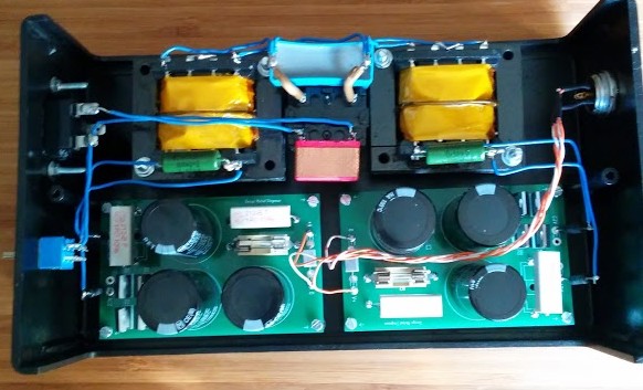

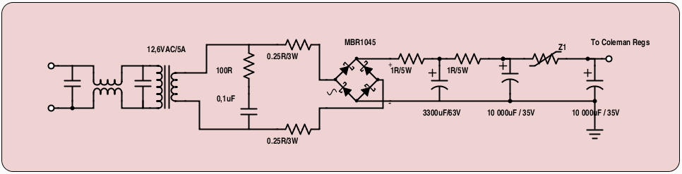

While I have your attention I want to show you my raw supply pics

Excellent raw dc supply, Bas!

noting for one thing that before the primary appears the better balanced point to be implementing common mode mains filtering rather than closer to the filaments
Thanks for the input. I had to drop a little more voltage to get closer to the safe side...and thought reverse recovery spike function as well (not sure if that is an issue with schottkeys)
But do you think the resistors would be better on the primaries?
The resistors you have on the secondary side are already doing a very good job of reducing peak current as well as some filtering.
Common-mode chokes - when run well within current-rating - give some useful differential mode filtering, in most cases.
If you want to try the effect of more filtering, maybe a simple ferrite choke 0,33 - 1,0mH could be used after the first cap.
But I think that the regulator can already deal with any noise remaining after the raw dc supply you have now.

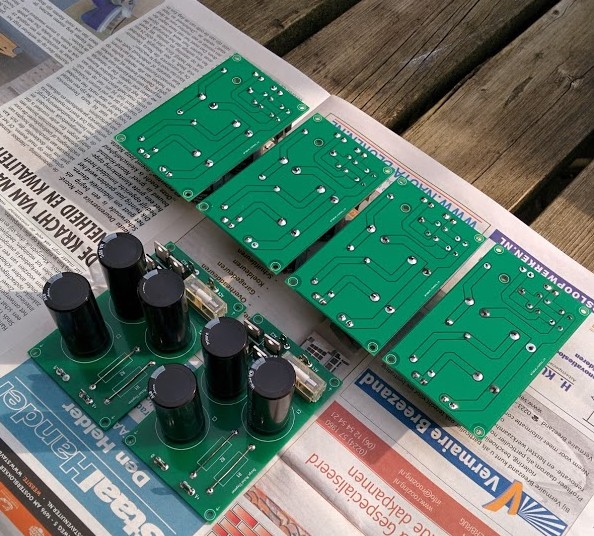

My own raw dc supply PCB is on the way now.

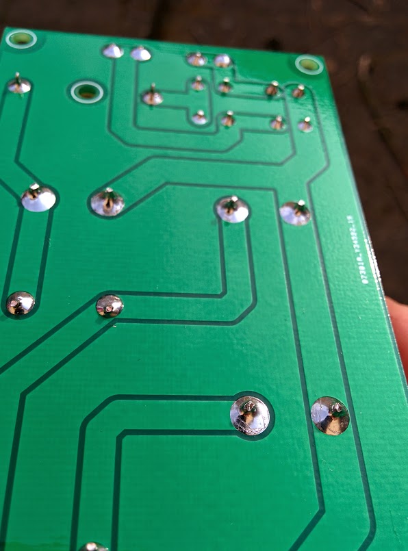

About time. 😉 I had to have my own PCB manufactured...because I wanted it pretty. 😉 And ebay did not have what I wanted. Single supply...with optional dropping resistor(s).

Some guy on a dutch forum drew it for me. Then I sent the files to China. And a week later I had the boards 😀
I don't have a heatsink because they get lukewarm...if that. Biggest heat is from the 1R dropping resistors. Since it is in a relative small enclosure I have drilled holes all over the thing...and got a 10dB 60mm fan to force air into the whole thing.
