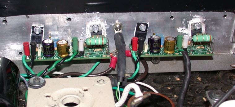

I just installed Guido Tent's Directly Heated Tubes Supplyboards and I am swiped away with the quality and results. Great build, easy to use.
Great depth of sound.

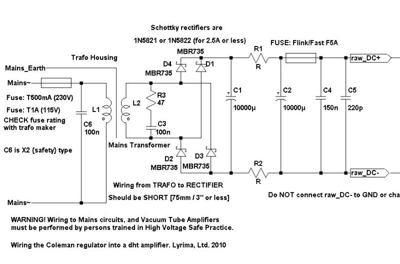

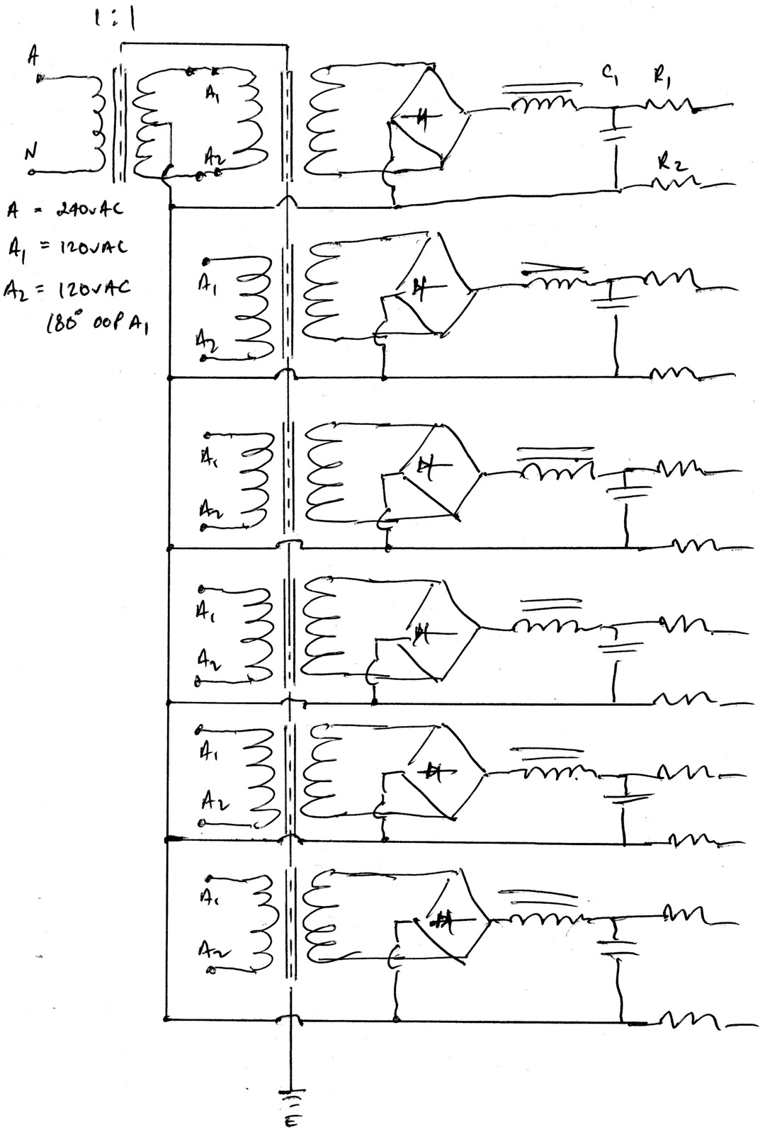

Definitely will follow the recommendations and on that would like to ask regarding R3, C3 and C6 as per the manual and how it might relate to the following application (not drawn in for sake of simplicity).
Particularly with C6 - with all these transformer primaries in parallel as seen reflected back across the isolation transformer. Seems R3, C3 perhaps not as critical but any insight is greatly appreciated.

Hi - Yes, The snubber network R3-C3 can be applied to all of the secondary windings in your (multiple trafo) application. Apply separate R3-C3 to each one.
C6 is a mains suppression capacitor. the 0.1µF value will work well enough here, if you are already adding an isolation transformer. The incoming mains noise will be reduced to very low levels already.
Without an isolating trafo, the noise suppression improves with larger values of capacitor, but this is regarded as hazardous, since pulling out the mains-supply plug may leave the cap charged (to as much as 350V dc or even higher), and present a risk to someone touching the pins of the mains plug.
Adding a suitably voltage- and power-rated Flameproof resistor (e.g. 1M ohm) across the cap will reduce risks, by discharging it reasonably quickly.

The C6 connected directly to the mains supply should be 0.1µF and be a safety rated X2 type.
I use it SE. I have the plus on pin 1 of my 300BC (carbon plate, like a 211) and also I have the cathode resistor there.
My Chinese 300BC have a slight imbalace in the winding; in pushpull and AC it can be balanced quite well, but not on a SE application. And then: even a normal DC feed, CCS, shunt still gave some mains lines disturbances.Great depth of sound.
Now it is quiet as night.
