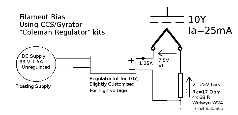

Question for Rod Coleman about the DHT fillament supply: from your comments earlier I'm led to understand that the impedance the filament looks into on both sides of should be high. However, your circuit has quite a low impedance both when looking from the filament into the gyrator, and looking from the filament into the CCS. What I'm saying, is that it appears to me that neither the output impedance of the gyrator nor the input impedance of the CCS is high. I'm a bit confused by this and the earlier comments on impedance that can be found in this thread.

high impedance is required at several nodes, but not in all directions. The performance points that are important are:
- Signal impedance from end-to-end of the filament should be high, so that the regulator does not divert cathode (music signal) current from flowing around the filament, as if the regulator were not there.
It does not have to reach megohms for this to be effective - just big compared to the 1 to 10 ohms of a filament. The small signal impedance looking from the filament into the CCS is several K ohms under the worst case conditions, so I think it qualifies. As such, the impedance looking from the filament through the gyrator is not really important.
The impedance looking into the gyrator from the filament is not high impedance, but this side is usually grounded in the application, and this is not of any consequence.
- In the second case, the insertion impedance (the small signal broadband series impedance) looking from the power supply raw dc to the filament should be as high as possible. This is to isolate the filament from rectifier artefacts and mains borne noise. In the case of my regulator this impedance is effectively determined by the output capacitance of the pass transistors: 30 to 250pF, depending on the model, and standoff voltage. This provides high insertion loss up to pretty high frequencies, and works notably better than 3-terminal regulators in this regard - one reason why it sounds so much better!
It does not provide high impedance in every direction, but provides high impedance across the boundaries that are important in the application.
Both these major considerations are aimed at allowing the signal current to pass unmolested (by noise or by low impedance, due to feedback).

Thanks Guido, I read it. It did not answer my question. From what I understand your circuit has one side of the filament "closer" to ground, while the other one presents a high impedance to the filament, right?
I'm just trying to wrap my mind around the whole discussion that the filament should see high impedance on one side, so that the signal currents go the other side. I understand that the gyrator is more a power supply filter, so it should have a high input impedance. In face it has quite a low output impedance.
The gyrator does not need a high input impedance. Instead it needs a high impedance across to the filament; the fact that it has a low impedance to the raw dc negative is not of great consequence, but in fact it dissipates noise. Both these properties are material aid to keeping the mains and rectifier disturbances from reaching the filament.

It should, and in fact does have, high impedance looking into the collector side of the CCS.
The simulation results should be better than that, but only if the models are trustworthy - and the right ones are used! And, the circuit and circuit operating conditions must be accurate.
That is chiefly down to the use of the transistor in the version of 7 years ago. although it works and sounds OK, the MJE15032 is now neither used nor recommended. The saturation region of this part is not very flat. Today, 2SC3852 and a number of other (all Japanese) equivalents are used, and give hugely better performance, especially at low Vce found in this application. The dynamic impedance of the completed circuit measures in the Kohm region.
You don't need to take the trouble of simulating to find this out for yourself: just look at the saturation region curves of a good transistor. All the models of regulator I supply operate with the Vce-Ic characteristic in the horizontal region, ie high impedance. And, since there is no feedback, or any other circuit element connecting to the filament, or collector, this performance is upheld in the actual regulator.
My suggestion indeed is to connect one end to ground, the other end sees a high impedance, hence the differential cathode impedance is high, which is what counts.

Does this old drawing help, regarding the connexions?
The CCS to filament interface is a collector of an NPN, which should always be high impedance, if the operating voltage/current is appropriately chosen.

The above is what I've been using until recently - Rod's original design in post 35 of this thread. The gyrator goes to the plus and the current source to the negative, i.e. ground in filament bias.

Andy, Iko & I were talking about the question of whether B+ Return (i.e. Chassis, or real Ground - or the cathode resistor, or LED) should be connected to the filament's positive or negative.
It does make a big difference. you have to use a different value cathode resistor, if you use cathode bias, or adjust bias voltage if you use fixed bias - because the bias is shifted by an amount equal to the filament voltage, when you switch polarity like this.
It is well worth trying, to see which way round you like it best.
However, in your drawing filament bias is used! In this arrangement, there is no choice in the polarity - the negative must connect to the cathode bias resistor, or else the bias will be reversed.
But in all other applications, trying positive-return is recommended..
On a side note I think it is confusing to think of this as gyrator-filament-CSS (or the other way around.) Especially when you are directly connecting one end of the filament to ground!
I see it as Gyrator feeding CCS||cathode.
