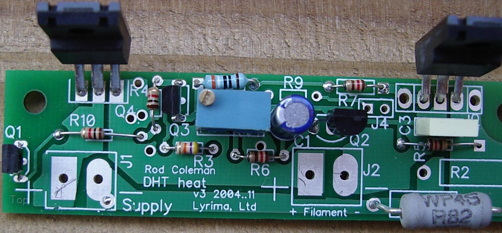

Hello Mr. Coleman,
I couldnt find the schematics for this design, only views of the PCB.
Could please you post (or repost) the schematics?
The PCB + parts are available for DIYers to buy as a kit.
The design is based on some of the schematics I posted on this thread, I think about 1 year ago I posted some.
BUT, to make it reliable and easy to make, and low cost, and characterised for many different tubes, cost me probably hundreds of hours of development work! The schematic is not very different from the ones I published, but please understand that (while the kit is for sale) I must keep the latest schematic to myself.
Actually, it would be hard to make a few boards and buy the components, without spending more than the kit price!
Where is a printed circuit available or even a complete kit?
Herbie, just click on my (user) name to send me some email, or PM.
If you include an email address, I can send you the PDF manuals & Application Notes - these show how to use the regulators, and which DHTs have been tested, and price vs quantity, usw.
The picture in the last post is the new rev 3. Same circuit, a little easier to build. A lot of DIY builders are enjoying these, all around the world.
