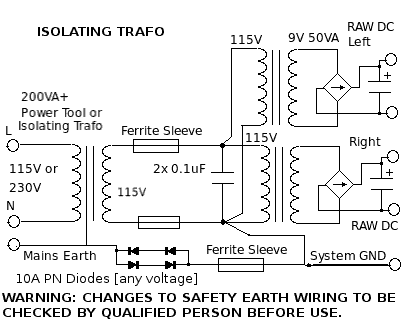

Another way to make your raw dc supply very quiet....
An isolating trafo will allow you to use a toroidal trafo, or other type with high noise coupling and still have the quietest possible solution.
Surplus power tool transformer, or units salvaged from industrial control panels are a good source of these.
Notice also, that my drawing shows the safety earth decoupled (ac-wise) from the chassis. Do not attempt this arrangement unless you are CERTAIN of what you are doing, or have it inspected by a competent person BEFORE switching-ON .
Sadly, the safety earth is often a serious source of noise.
RF-decoupled Earth provides a barrier against safety-earth noise creeping in and spoiling your hard work from buffering the mains Line/Neutral. The diodes must be 10A (or of such a rating as to be sure to blow the mains fuse before the diodes are themselves overloaded). Their leakage capacitance allows some HF noise through still, so a clip-on ferrite (see the Wuerth catalogue) is also recommended.
It's worth exploring all kinds of refinements like this, since IME, a top-flight DHT-powered audio system is sensitive to to minutest encroachment of noise, not least at the filaments.

Thanks Rod. I currently have a cheap and nasty 2A trafo with full wave schottky rectification for my 4P1L DHT pre and with some filtering (no chokes) and your boards, it is absolutely silent. Is there any point in trying to improve on this?
O, when I talk about quietness, I mean electrical noise.
Even total audio silence is no evidence that the sound quality is not being corrupted by ultrasonic/HF/RF noise.
But, If you have hum, or buzzing, then the problem is very serious!
The Filament regulators give a layer of noise isolation on both sides of the filament. The performance of the buffers depends on the leakage capacitance of the pass transistors: 35 .. 100pF in the case of my design, depending on the model. Low capacitance means noise protection up to higher frequencies, and this is important, because HF/RF noise is usually modulated (in amplitude, or in phase), and parts of an amp can effectively demodulate the noise - think of the noise as RF carrier, and the AM or FM modulation being allowed in through the leakage capacitance... The RF can enter a power stage, and leak through to the low-level stages, too.
pF-level of leakage is very hard to improve, except by adding another layer of isolation, either by using better transformers, or finding a way to block noise between the transformers and the regulator. Noise blocking that is effective into the range of modern-day noise sources (mains-carried, and rectifier recovery) is much more difficult than it appears at first blush, so attention to the transformers is always worth trying.
I use the isolating transformer myself, and believe it to be worth the trouble, even for 300B output stage.
You can hide the Iso-trafo in a remote corner, and run mains leads to the amp's filament supply.
On the other hand, if you have cheap filament trafos, and the rest of your gear is pretty good, I suspect there's a very good chance of you hearing the improvement, if you add either isolating trafo, or better trafo, especially if you can get one with an ES-screen.

Rod - what are your opinions on mains filters? I have a huge and heavy one - probably a massive toroid inside - which I don't really use. I couldn't hear too much difference. Mind - my 26 filament supply which does actually use toroids also has the benefits of a choke input supply which presumably strangles some of the sins of the toroid!
andy
andy
I avoid industrial mains filters, because although series impedance is good against noise, in this position it's in series with the cap recharge current - and this causes unpredictable results, often bad ones....
chokes are better used in the smoothed dc portion of the circuit, where their inductance is not subject to fast-rising current steps. Step currents can excite inductive parts into resonance, which is very unhelpful.
Also, note that the (secondary-winding) peak current into the rectifiers is 4 to 7 times the value of the dc current, making inductor/filter choice very difficult.
