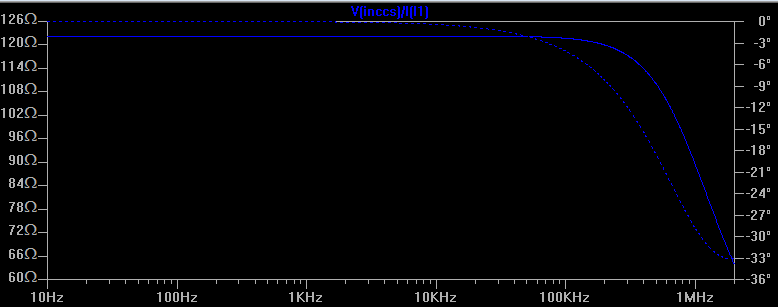

I'm just trying to wrap my mind around the whole discussion that the filament should see high impedance on one side, so that the signal currents go the other side. I understand that the gyrator is more a power supply filter, so it should have a high input impedance. In face it has quite a low output impedance. Let's put this issue aside for not. From what I understand, the circuit should be used such:
+vcc->gyrator->filament->cathode resistor->ccs->ground
Now let's look at the CCS. It should or it should not have a high input impedance?

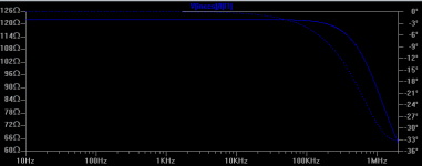

This is what it simulates like, using ZTX894, MJE15032, and a current of about 1.28A through the filament.
It should, and in fact does have, high impedance looking into the collector side of the CCS.
The simulation results should be better than that, but only if the models are trustworthy - and the right ones are used! And, the circuit and circuit operating conditions must be accurate.
That is chiefly down to the use of the transistor in the version of 7 years ago. although it works and sounds OK, the MJE15032 is now neither used nor recommended. The saturation region of this part is not very flat. Today, 2SC3852 and a number of other (all Japanese) equivalents are used, and give hugely better performance, especially at low Vce found in this application. The dynamic impedance of the completed circuit measures in the Kohm region.
You don't need to take the trouble of simulating to find this out for yourself: just look at the saturation region curves of a good transistor. All the models of regulator I supply operate with the Vce-Ic characteristic in the horizontal region, ie high impedance. And, since there is no feedback, or any other circuit element connecting to the filament, or collector, this performance is upheld in the actual regulator.

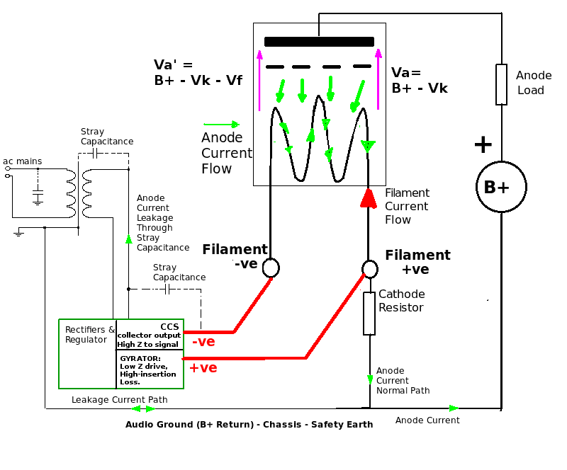

Does this old drawing help, regarding the connexions?
The CCS to filament interface is a collector of an NPN, which should always be high impedance, if the operating voltage/current is appropriately chosen.
Think of the Gyrator as a noise buffer, more than any other purpose.
It's different only in the polarity of the filament.
Originally, I believed that returning the anode through the negative should be best, and I think that Western Electric even counselled that orientation. But, including contributors on this thread, it quickly transpired that the positive return sounds best. I cannot give and solid explanation for why it should be, but it appears so.

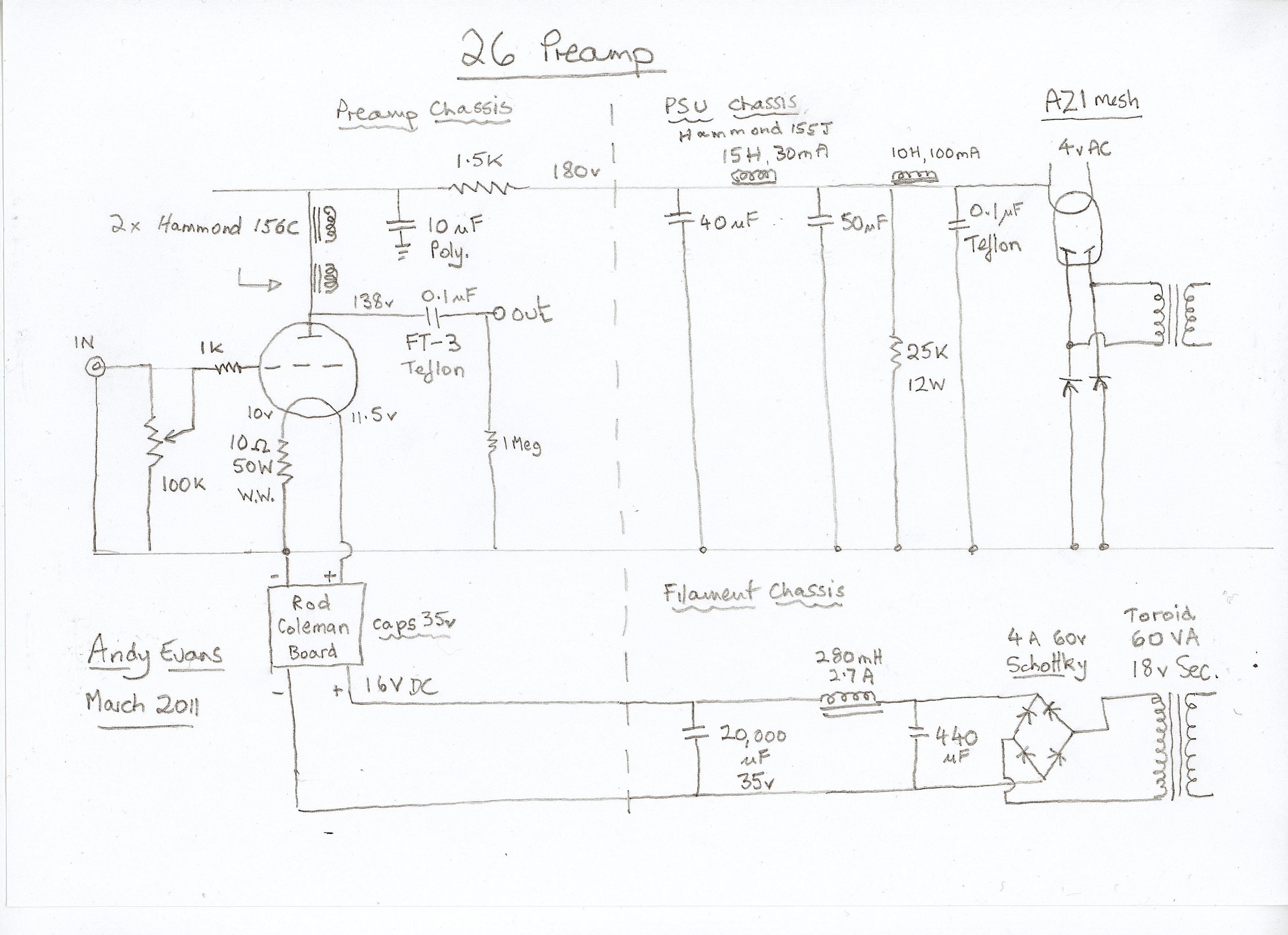

The above is what I've been using until recently - Rod's original design in post 35 of this thread. The gyrator goes to the plus and the current source to the negative, i.e. ground in filament bias.
I wasn't aware I could connect it the other way around - is this true?
andy

Andy, Iko & I were talking about the question of whether B+ Return (i.e. Chassis, or real Ground - or the cathode resistor, or LED) should be connected to the filament's positive or negative.
It does make a big difference. you have to use a different value cathode resistor, if you use cathode bias, or adjust bias voltage if you use fixed bias - because the bias is shifted by an amount equal to the filament voltage, when you switch polarity like this.
It is well worth trying, to see which way round you like it best.
However, in your drawing filament bias is used! In this arrangement, there is no choice in the polarity - the negative must connect to the cathode bias resistor, or else the bias will be reversed.
But in all other applications, trying positive-return is recommended..
On a side note I think it is confusing to think of this as gyrator-filament-CSS (or the other way around.) Especially when you are directly connecting one end of the filament to ground!
I see it as Gyrator feeding CCS||cathode.
It's worth remembering that the whole filament supply - especially the AC transformer secondary, and rectifier/caps floats.
It's only ever connected to ground at one point (Fil + or Fil -) - this is for the cathode current only. The filament current does not need to even know that Ground exists - (ie B+ Return, or B-, or 0V (HT)).
One of the regulator's functions is to isolate GND from the filament supply.
