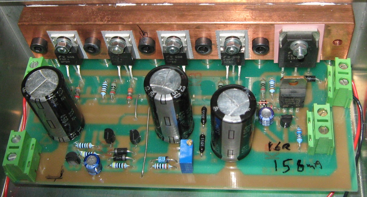

I just ordered a couple of filament supplies from Rod. My understanding is that the supply is comprised of a gyrator followed by a CCS, and that the filament is hooked between the gyrator and the CCS, as follows:
a)
filtered DC positive --> gyrator --> tube filament --> CCS --> filtered DC negative
My question is, why is the tube filament not connected after the CCS, where the line rejection is much higher; like this:
b)
filtered DC positive --> gyrator --> CCS --> tube filament --> filtered DC negative
I have measured an implementation of a simple gyrator/ccs supply hooked up as version a) above and the ripple on the tube filament is much higher than if hooked as in b). We're talking 20mV p-p for a) and below 30uV p-p for b).
So then, why is a) used by everybody?
