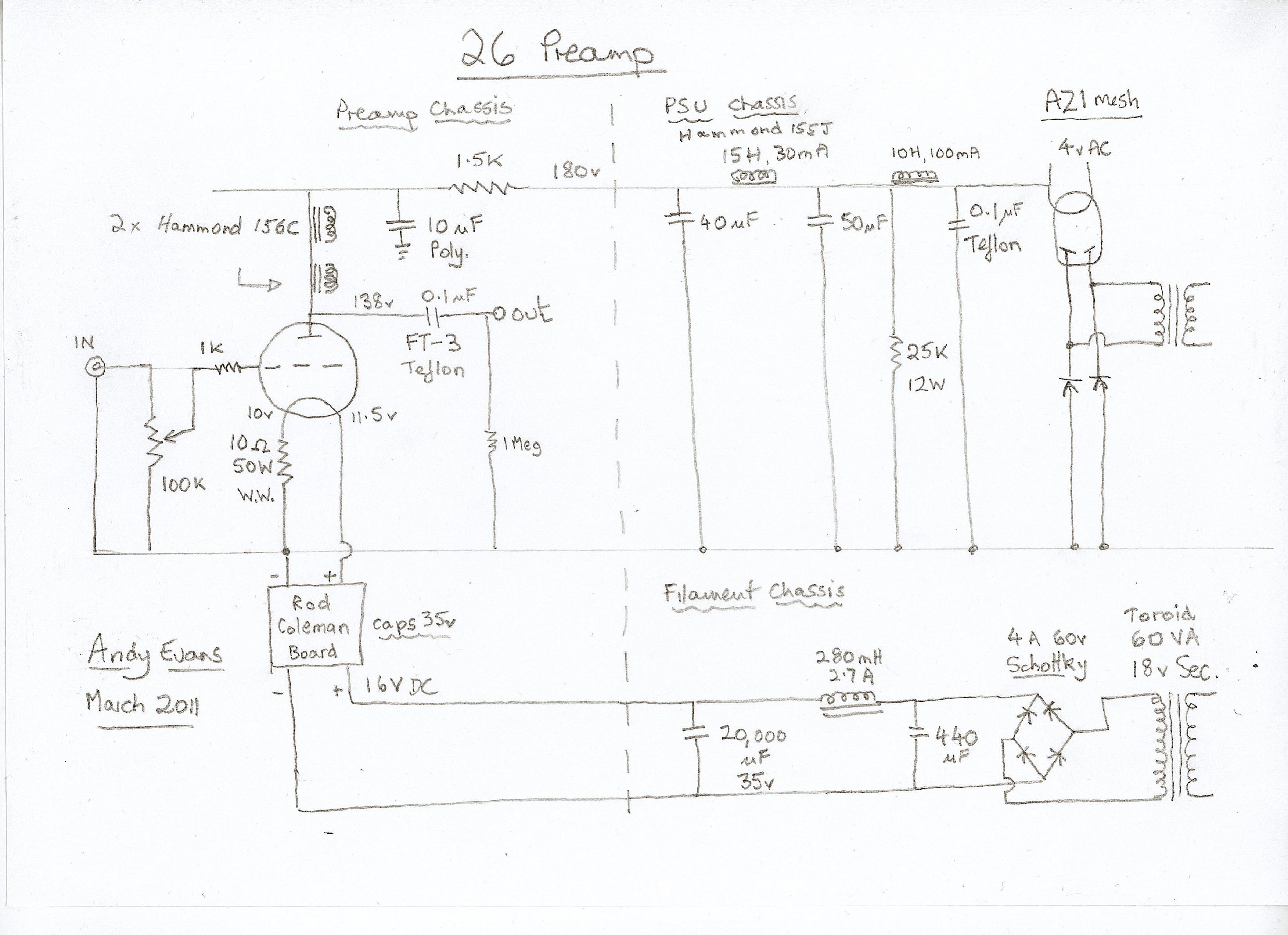

Thanks Peter, great things to try out. BTW, what c-core size area and what type of winding (bifilar?) would you recommend for the cmc at about 1A DC. I should say for an inductance of 1 to 3H.

Now, regarding the CMC, inductance of 1 to 3 H is too low. Do not even think of trying it, absolutely worthless! If your cathode self bias resistor is say 1000 Ohms, then you have to reach at least 3 times this inductance at 30Hz through the CM choke! 2*pi*30*L=3*1000 -> Lmin=15.9 Henries!
I have tried several chokes and anything considerably lower than 3xRk takes back the great part of this amazing thing!
16H is not at the sphere of unobtainium, remember CM chokes do not have gaps and no DC bias, as they are wound on opposing chambers with reverse direction. In case you know the mu parameter of iron core material and the geometric characteristics, it is very simple to calculate the required turns. From available winding space you will calculate how many turns fit inside, so you select the core from the desirable winding window area.
Do not try bifilar winding scheme, just plain 2 chamber winding with opposing directions. Take a look at the pic, the CM choke is the big one between the wooden clamps, it is seen first with tungar bulbs behind it.

Hm, what do you mean #2? My Rk is 10 ohm because passing the filament current of 1A through it biases the 26 tube at -10V.

For Autobiasing scheme, which is the value of Rk? This is very important. You must elevate the AC resistance (inductance) of the filament supply to more than 3 times Rk, so filament sound wave (sound that leaks out of filament) passes 'more easily' through Rk and not through filament supply and its parasitic capacitance. Remember Rk is theoretically the only place from which sound loop must be established, not through filament supply's parasitic capacitance. So the inductance of supply must be as big as possible!
Generally speaking, initial permeability of CRGO should be around 1000-1500 or so. This is where your calculation should be based. No gaps and no DC biasing. On small cores (cross sectional area 1 sq inch) it would be difficult to reach high L values. For 26 tube I would select the core with cross sectional area 32x32mm and winding window width 65mm. Wire diameter 0.75-0.80mm. This is enough for a two chamber CM choke with ~850-950 turns per chamber. Inductance will be really high. Start from this 'extreme' point in order to realise how good is a CM choke! Then you can scale down.

Autobiasing?
If you do not use autobiasing scheme and have the negative supply for grid-cathode, things could be quite different. Have not yet tried it because I like the sound of autobiasing scheme.
Yes, autobias. Have a look at Andy's preamp; this is how I do it, except I'm using my own filament supply. The 1A current going through the filament and the 10 ohm resistor brings the cathode/filament 10 volts above the grid.

10 Ohms cathode resistor. So go accordingly. You do not need excessively high inductance like in my case. But I use different schematic. Classic autobiasing scheme with filament voltage applied directly onto tubes pins, with both resistor and capacitor on the (+) side. Resistor for biasing and capacitor for zero feedback. CM choke imposes huge inductance so signal passes through capacitance more easily with less interference of parasitic capacitance of filament PS.
Finally, something for your PS. I see you use Telefunken mesh AZ1. FYI this tube loves bigger capacitance. 0.1uF is almost choke input. Try 10uF capacitance, it will play a lot better.
It is Andy's circuit. The only part that I use is the bias. My psu is different and I will change it again; I will wind myself some chokes for B+ filtering and plate load as well. Those should be simpler to make.

We can put some honest numbers on the LT1083 noise, rather than just the hand-waving.
The data sheet specifies the noise as:
0.003% of Vout, Typical, 25 deg C, RMS value, 10Hz-10kHz.
When connected as a CCS, for say a 1,2A 300B filament, the regulator applies 1,2V across a 1-ohm resistor, so the output noise is:
Vn = 1,2V x 0.003% = 36uV;
and the noise current is translated by 1-ohm directly into amperes: 36uA.
So the CCS injects RMS noise of 36uA into your filament, where it is directly coupled to the cathode current.
For 300B at 60mA, this is RMS 0.06%
For 26 preamp at 6mA this is nearer to 0.5% (1.05A filament).
No wonder the difference is audible!
Remember, these are RMS values, so the peaks are bigger. For some samples of the chip, the noise will be worse, as it is not guaranteed.
And, if the test bandwidth were properly opened up to audio amplifier limits, the noise would be substantially worse.

Reality is exactly as you mention it!
LT devices produce noise. Cap bypassing was quite shocking to me, but you are right.
OK, the purity of the choke is probably unmatched but unfortunately you cannot go only with a choke as voltage drifts. Your solution at low frequency is definately better.
