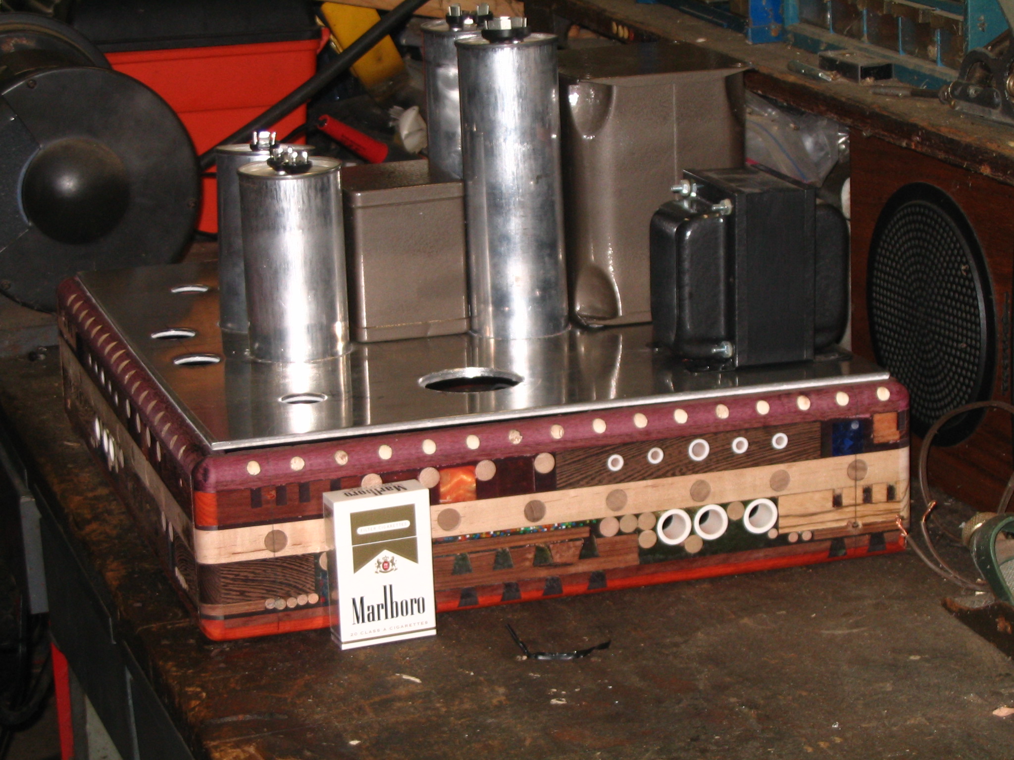

Here is the chassis in the rough. I should have it done this week and ready for wiring. The top plate is 1/4" aluminum and measures 19" w x 16" d. I am thinking it will weigh in at 50 lbs or so. The two holes in front of the cab are for the 6D22S reg tubes, the big holes next to the potted choke are for the GM70 and the little holes in front of those are for the 12HL7 driver tubes. Two stage SET with CCS on the driver tubes. I am thinking about 10 wpc or so. B+ is 870v.
