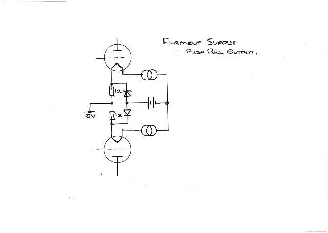

Ian, That's what I was thinking.
The difference in voltage between the 1-ohm resistors is forced to appear across the filament CCSs - which is fine, they're designed to cope with that.
The 1-ohm resistors should be able to sense anode current without interference from its opposite half, allowing the autobias circuit to operate.

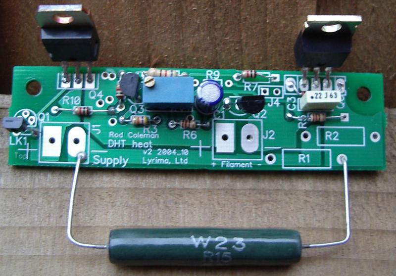

Hi John,
The new PCBs are due on November 22 [next week], so I hope to start shipping kits shortly after that.
This is a new version-2 PCB with support for the big Transmitting DHTs in SE amplifiers.
There is a PP version all laid out, but needs a little more interest to justify sending out for fabrication yet.
The regulators are available as 2 PCB + component kit - ALL the PCB parts. But, you must add your own Heatsink, & dc supply - transformer, rectifier, capacitors. Full details of the external parts you need are given in the PDF Application notes - which have lots of info on Building and Use of the kits - please send some PM to have a copy.

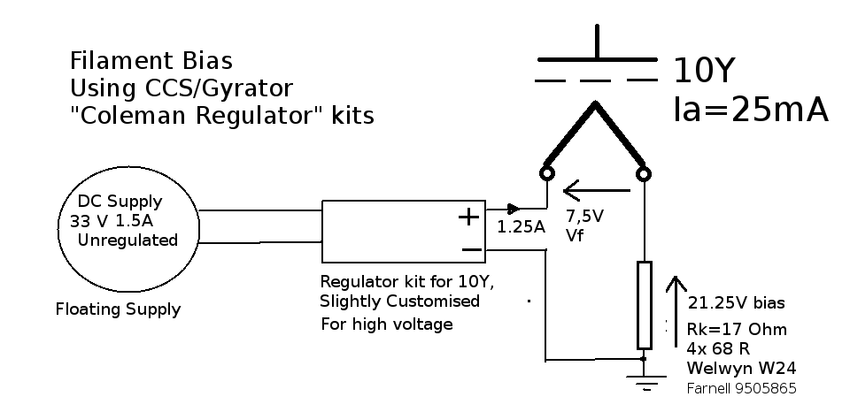

HI Rod I'm waiting info for filament bias 10y 25ma
thanks
Hi Manu,
I think I would do it like this:
The cathode resistor burns nearly 27W in this configuration! I would use 4x 68R 14W as a minimum rated power handling for this setup. The Welwyn W24 vitreous enamelled wirewound is a good low cost part for this position - good quality too.
THe raw dc supply must be floating from system ground - see drawing.
THe 26 DHT would burn much less power in a filament bias connexion.
But you can use my regulator boards in this way with no problem. They will sound much better than any 3-terminal regulator chip in the same position - and will not suffer the problems that ICs have with start-up current-limit, and instability. The boards will be tweaked with higher voltage capacitor, and a resistor change.
Manu, remember that the filament CCS is adjustable. You can adjust the bias using the filament current. Just be sure that the filament voltage is 7.2 to 7.6V.
Or you can use those Huntingdon rheostats (50W +).
At the input, you can use transformer (like your drawing) or -
- capacitor coupling;
- or use nothing! use dc coupling if your source has no offset!
