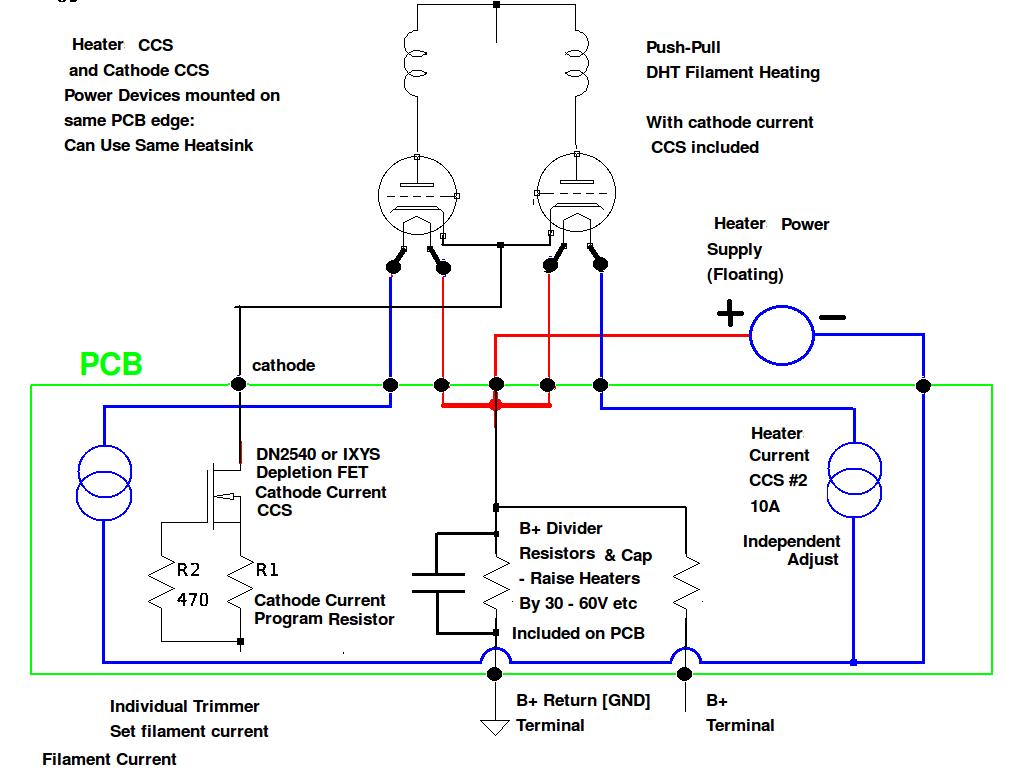

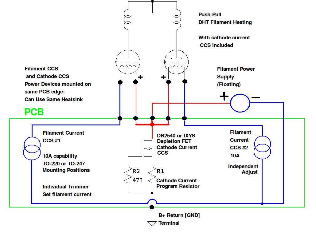

There has been some interest in a Push-Pull version of the DHT Heater PCB. How about this for the solution: A single PCB with 2 Filament CCS, able to work at up to 10A per CCS. TO-220 or TO-247 transistor packages can be used, to deal with filaments from 100mA up to 10A beasts. Each CCS has an independent adjuster. The PP filament regulator has only CCS, no gyrator, since any small amount of ripple current effect would be bucked out by the PP action.
To make the board more useful, a depletion FET CCS is included, for DHT phase splitters - Long Tail Pair with constant current tail. The Supertex DN2540 or any IXYS FETs can be used in the tail circuit. The Depletion FET is in-line with the two CCS transistors, so that 1 heatsink can be used for all three CCS power transistors.
Board is 91mm x 21mm [the SE regulator is 79mm x 21]
Does that look useful to anyone?

The board is also configurable to work with indirectly heated tubes - which is useful when you are working at low levels or RIAA stages etc. Each heater can be independently adjusted - so you could experiment with fine-tuning the heater voltage in first-stage amplifiers with 6Ж32П (6J32P) or EF86 or 6BS7 etc. These can sometimes be improved in noise (and sound) with the heaters reduced to 5.0V or 5.5V.
The cathode CCS can be used for differential stages, and B+ divider resistors & capacitor positions are provided on the board - so that raising the heaters to +30 or +50V is easy.

Ian, For Parallel PP, with 4x 300B per side [8x 300B for stereo] I would think you would use 2 autobias modules per side [4 for stereo].
If that is right, we would drive those with 2 transformers per side [4x for stereo] and 2 of the PP regulator boards per side [4x for stereo].
We may be able to make it work with only 1 transformer per side if diodes are inserted in the positive feed of the filament supplies. [The positive side of the filaments is returned to GND via independent resistors for Push and Pull]. P-N Diodes should suffice to keep the anode currents separate enough to perform the sensing on 1-ohm sense resistors.

Hi Dennis,
The PP board is designed to work with two DHTs running from the same supply - this is normal for PP, but for SE we normally use 2 independent supplies - else the cathodes for Left & Right would be joined.
This PP PCB supports 2x current sink [CCS] only, where the SE PCB supports 1x CCS and 1x gyrator. The gyrator gives a higher level of buffering between the filament and the power supply, and this 2-way buffering is one reason the sound is better than other techniques for DHT heating.
With PP this buffering has less [but not zero] importance, because the PP-action cancels much of the common-mode noise and pollution from the filament supply.
The other application for the PP board is XX-large transmitters like the 304TL - you should be able to support the 12.5A filament current by running half [6,25A] through each CCS on the board - they are independently adjustable.
