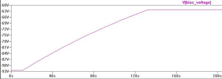

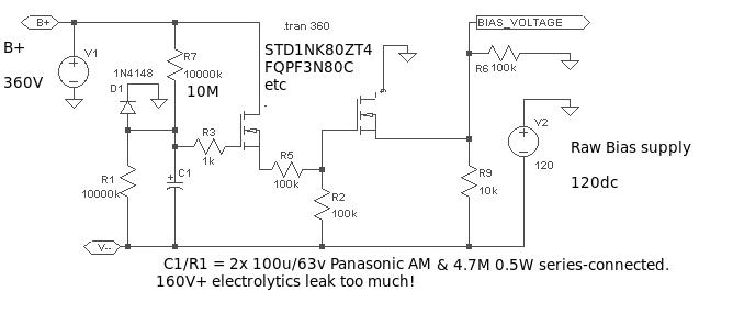

CLS, timer for B+ may take up a lot of space, so how about a slow Bias voltage? Biasing the DHT to cutoff will protect the cathode while it warms up.
This circuit is dimensioned for 300B, but could be adapted for any DHT. With no B+, it starts with about -95V, which is almost cutoff for 360V 300B. The bias takes 2 min to get to the -63v.
