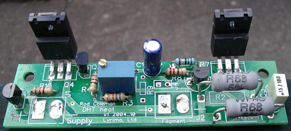

2a3
Here's a completed heater for a 2A3! Low noise performance for 7V +/-10% input supply.
Hi - on vacation for a few days, but some progress to report:
So far we have the 250mA, 250mA/#26 switchable, 300B, and 2A3 versions all characterised. They are working well - with sub mA ripple in 3A versions, even with 200mV input ripple voltage. Voltage headroom required is 4V minimum for sure, less typically. The GM70 version [20V 3A] has taken some time to get under control, due to the big switch-ON power pulse in the power transistors. (That's to say - the first versions failed due to overstress from the 24..25V-supply needed in these transmitting tube filaments). I wanted to have all the versions ready at once, as I believe many folks want the GM70 along with orders for the lower power heaters.
Meanwhile, the documentation in terms of assembly guides, power supply build examples, heatsinking worked examples is advanced but not complete. It's been quite an effort to prepare all these! Hoping to have a big finishing effort when I get back, and on with the release - I have plenty of PCBs stocked.
Apologies for the wait - I intend to offer a well-documented, well-supported offering, - thoroughly tested by the time it is released.
