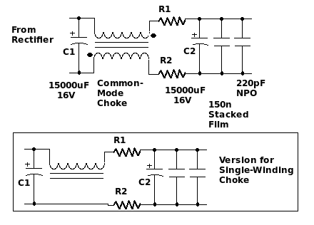

In the application notes it recommends the EpCos 1mH choke, this is available in the USA as digikey part number 495-2733-ND, my question is this is a 4 pin device while the application notes show it as a 2 pin choke, so we need some clarification on how to hook it up between the filtering caps.
Dave, I'll put the information in the App notes, but here's a preview. For 4-pin devices - these are common-mode chokes, use the diagram at the top. If you have a standard choke, use the single winding diagram at the bottom.
If you choose you own choke, you can either use a ferrite type in common mode or differential mode. These are very effective for reducing HF noise. you may suffer from this if your mains is polluted by industrial noise, subway activity etc. Or if there are powerful radio stations in your locality.
Chokes with laminated steel cores are effective against any remaining mains ripple too, although there won't be much of that left if you use 15000uF caps.
