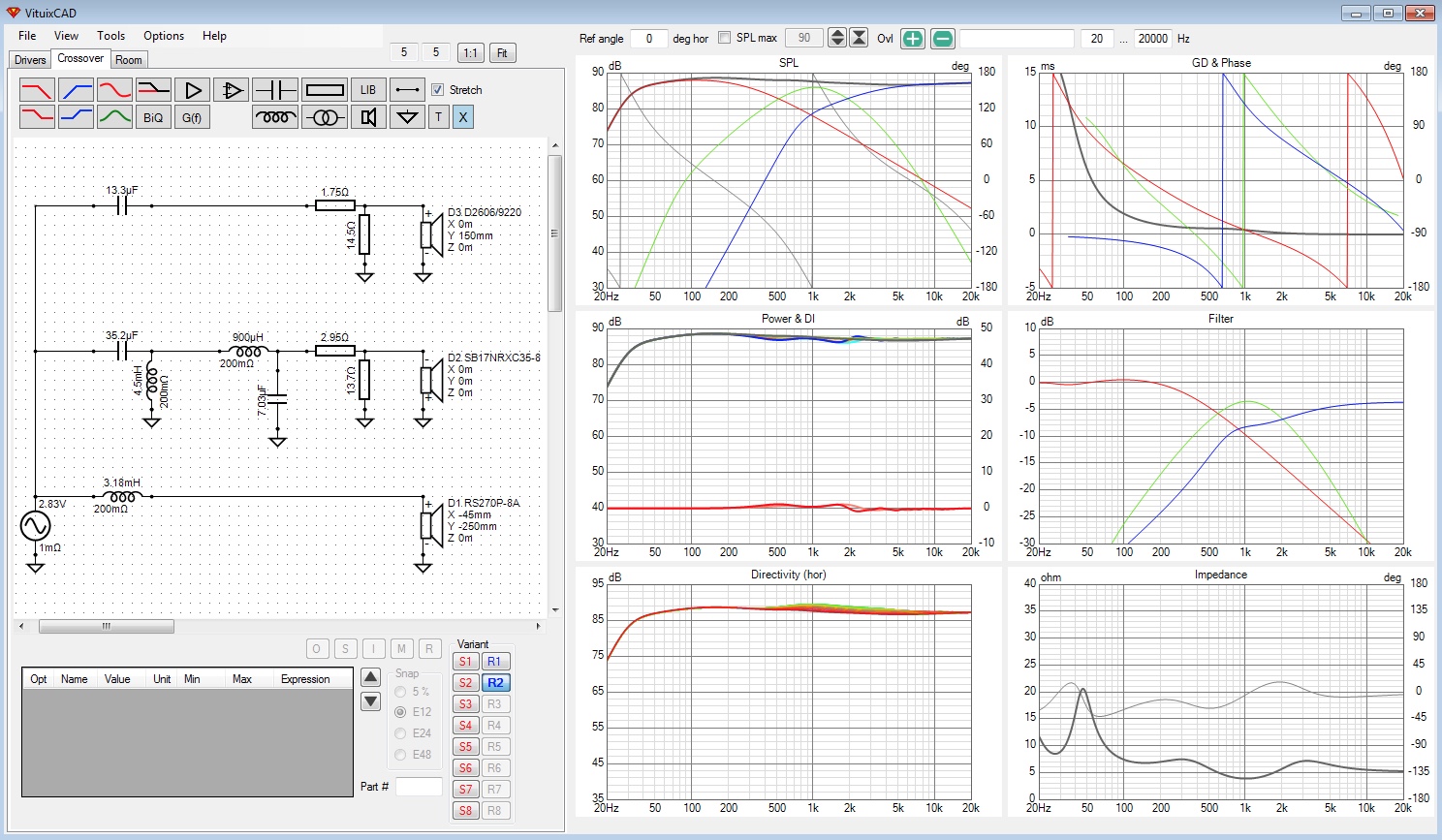

I updated the simulation with your box volumes for the mid and woofer (be careful with stuffing because it will act as further increase of the volume).
I went with a 7 cm inner diameter of the port since 3 inch ports are common and I usually use a piece of drain pipe with a 7 cm inner diameter (cheap and common where I live).
Mid:
  • Box volume Vb=13.3 l
  • Total Q factor Qtc=0.69
Woofer:
  • Box volume Vb = 54.5 l
  • Vent diameter and length Dv=7.0 cm, Lv=20.4 cm
  • f3 = 32.2 Hz
Filters still the same but response updated based on the above. I still don't know if this will work as simulated but it is at least an indication of what to expect...

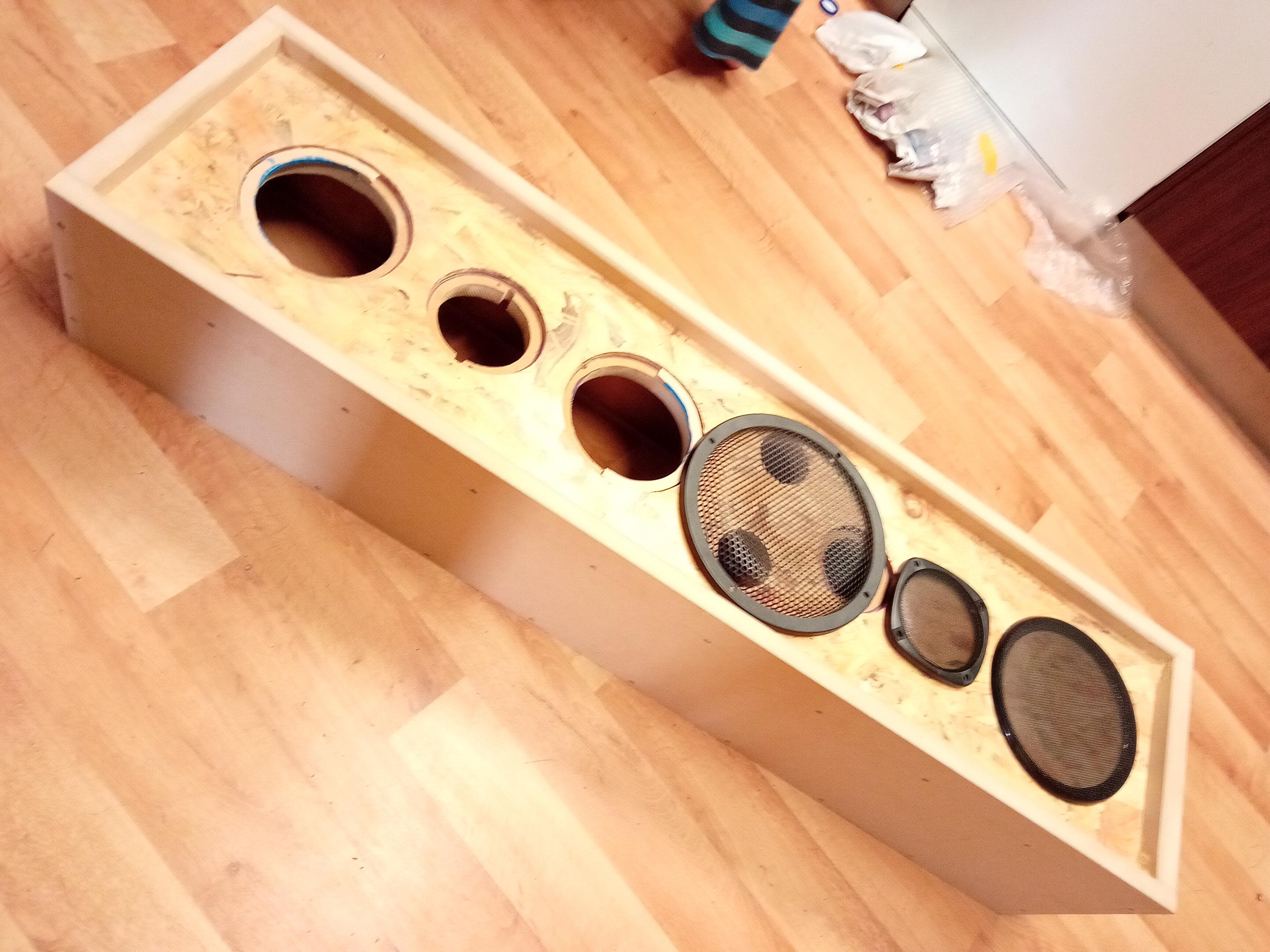

Here is the speaker layout I was planning ignore the cutouts. The human voice frequencies which is the major component of the music would not be coming from the tweeter so I could not understand why that would be placed at ear height? What do you think?

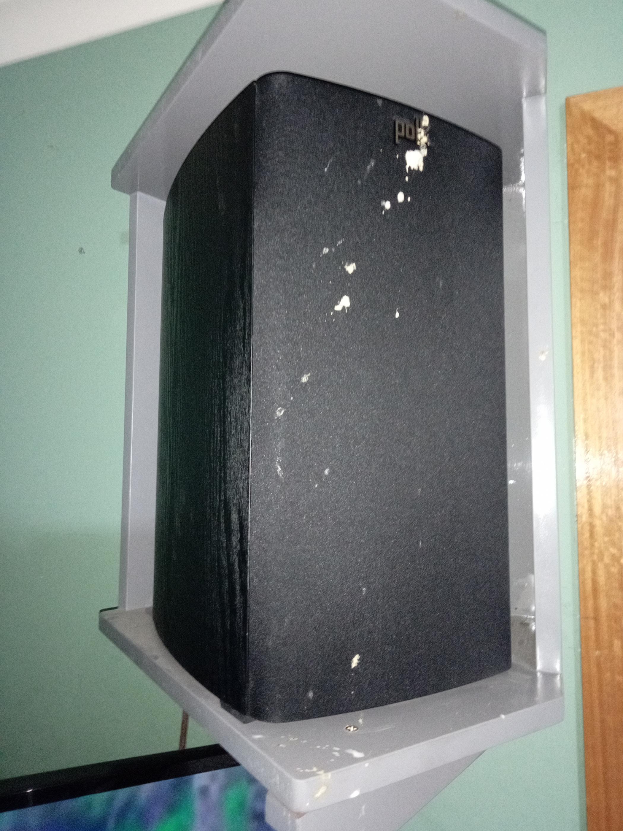

The recess all the way around the edges of the cabinet face will be 20mm inset now not 30 as I've had to cut a new peice of 9 mm OSB board and will fill the old cut outs (I originally had 4x SB 6.5"s)

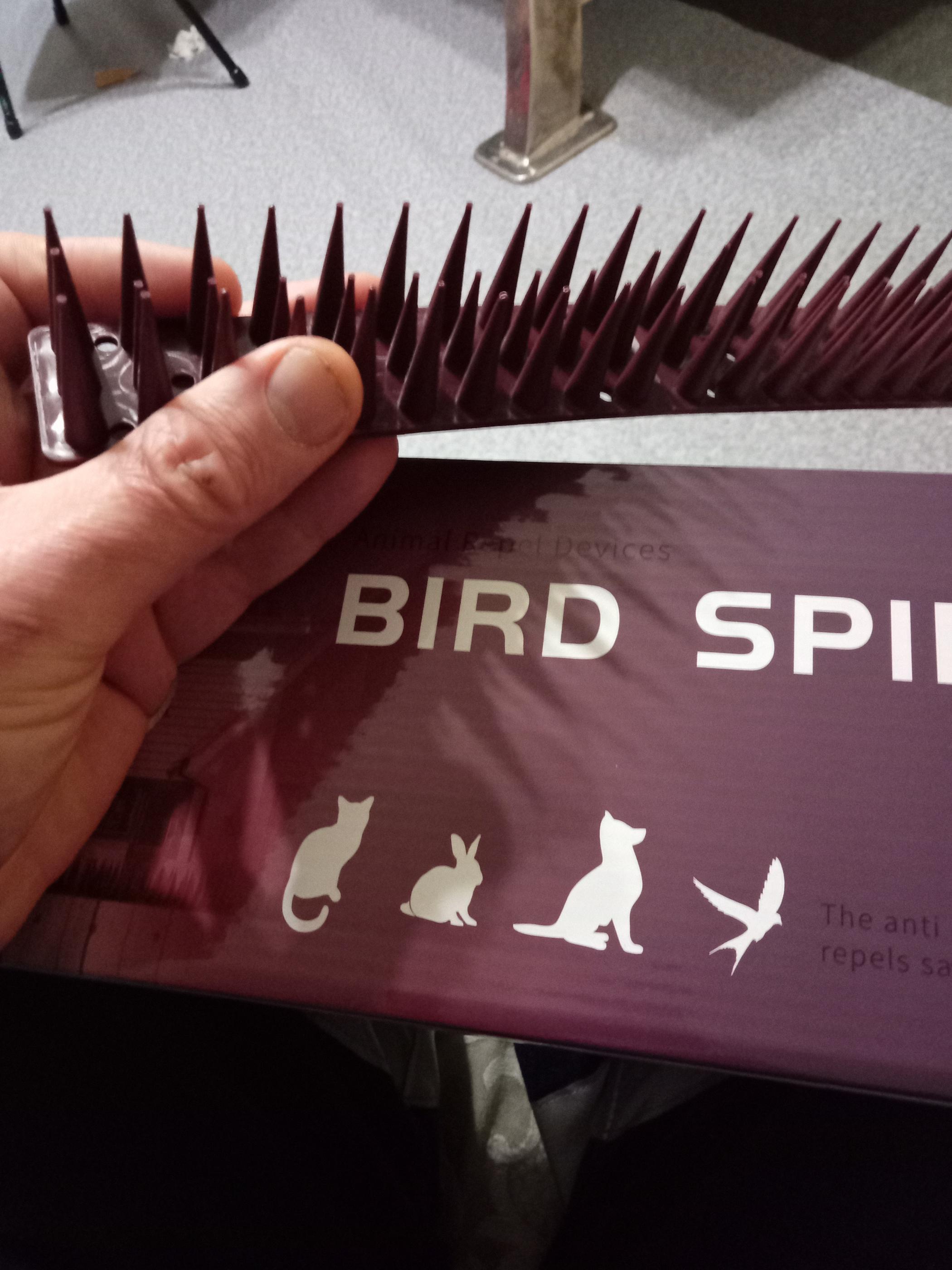

I put the recess to help prevent my pet birds messing on the driver cones. Although now it is uneccesary because I have purchased these bird spikes to put on top of the speakers (I know it will look bad). I'm thinking perhaps I should not do this recess at all if it will interfere with the acoustics?
They dive bomb my speakers!!!
It penetrates through the fabric on to the driver.
What are the arrows on the schematic of the crossover design.

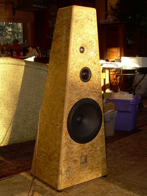

I have one 6.5" and one 10" in each box and one port.
Regards Tim
Great because that is what I simulated but I got a bit confused by the photo of the baffle, it seems to have six holes but I think I get it now. Its going to get a new baffle and the speaker grills mark where you plan to put the drivers, right? From top to bottom - mid, tweeter, woofer, right?
Yes that's it, your correct, actually I've already repaired all the old speaker holes with lots of circles and epoxy.

Just changing a driver from an 8Ω version to a 4Ω version will shift filter corner frequencies by an octave up or down (doubling or halving); the same for doubling up with drivers..
I'm sorry, but this is incorrect. The shift of the impedance will change the Q of the xover, not the Fc. The only way this is valid as to shifting in half or double due to the impedance change is for 1st order xovers.
While the change in Q will affect the response to where drivers rolloff differently than at the other Q, the Fc of the components in the xover (or the resonance of the components) will not actually change.

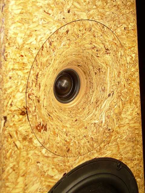

This link on port testing with flares and different sizes is interesting . I wanted to do a flared port 150 front by 70 back by 50 mm deep but the calculations are too difficult for me to work out.
Port Flares - Evaluation of noise
It would look something like this in pic with the edges of my OSB board rolled back and exposed. It's too complex for me to do the math on and I'd still need a 45 degree bend in the port.
This link on port testing with flares and different sizes is interesting ...
