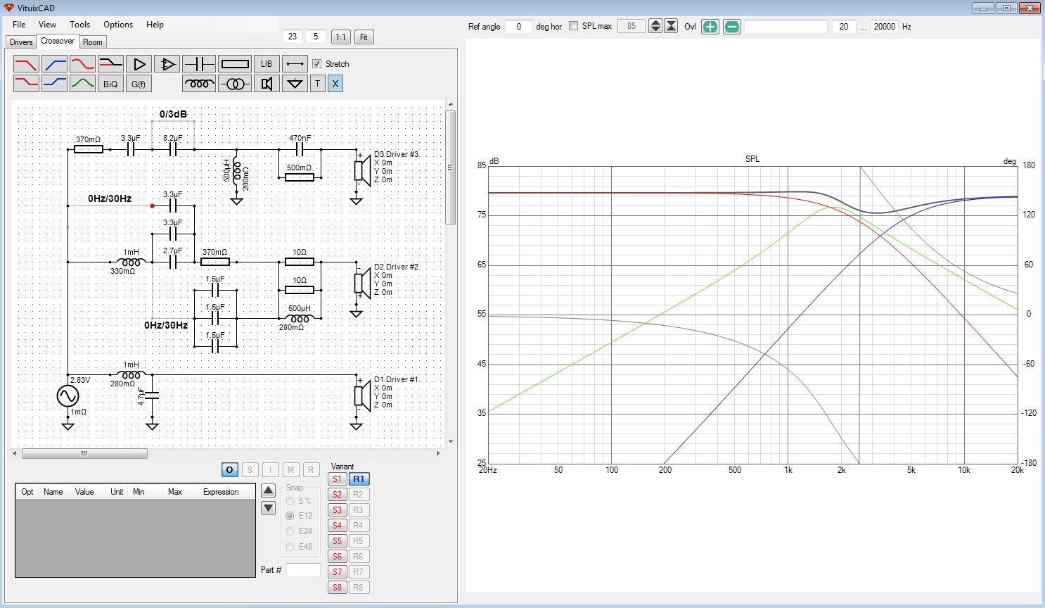

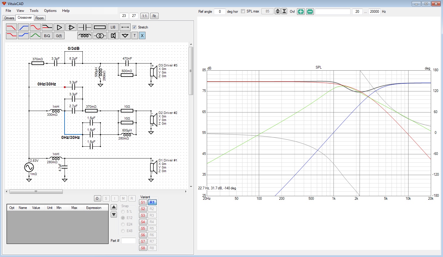

I've attempted to draw out the crossover. Please feel free to make corrections.
Mine looked almost the same but I could not read the inductor values. Here is my simulation in VituixCAD. There are no switches in VituixCAD but you can open or short any element. I have marked the wires I open and close representing the switches on the board. I used three generic drivers in this simulation, all set to 80 SPL and 8 Z. I have inverted driver #2 (the mid).

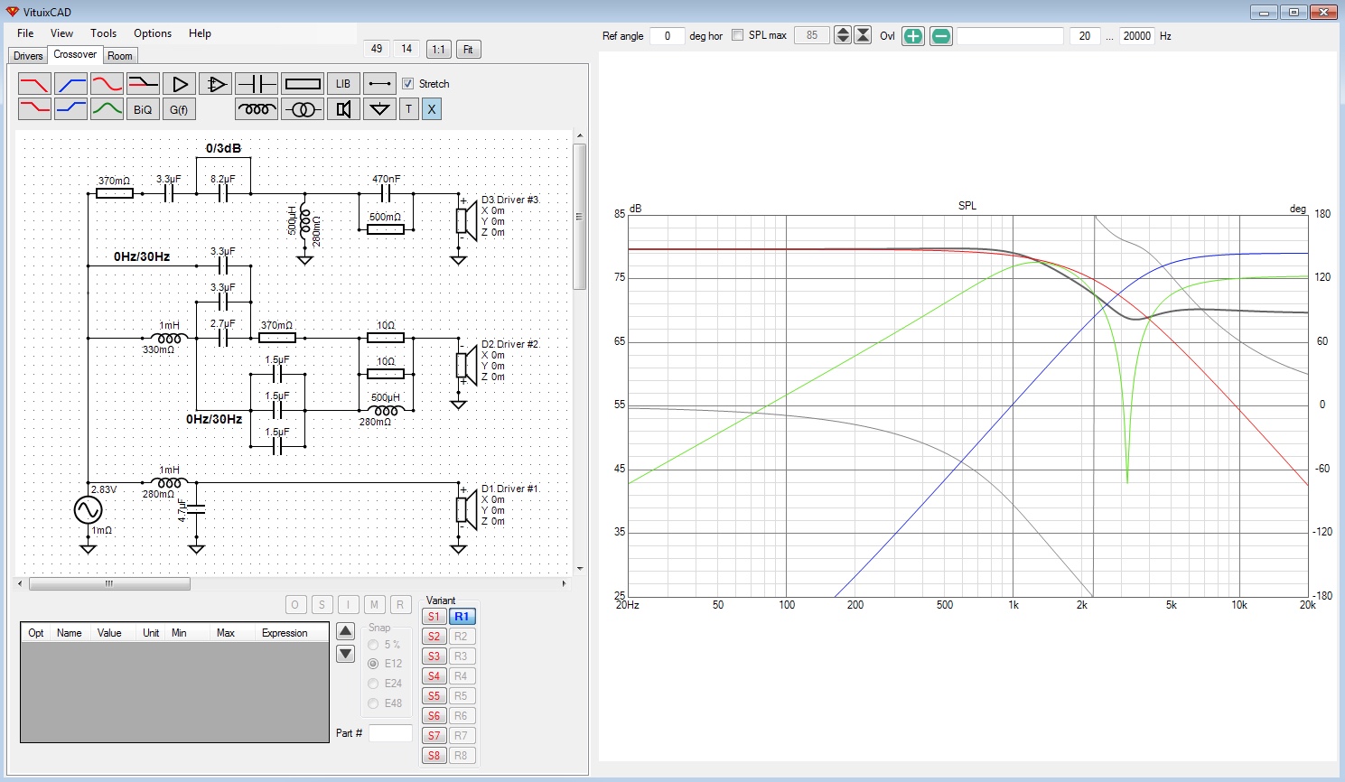

Image 1 is with all switches open (it seems to be the default based on images of the board). The bass seems to be down -0.3 dB to start with and I get F3 to be around 1743 Hz. The tweeter is down -1.3 dB with an F3 of around 5800 Hz. The mid is down -3.2 with F3s around 1230 Hz and 2830 Hz.
Image 2 is with the tweeters 0/3dB switch closed.

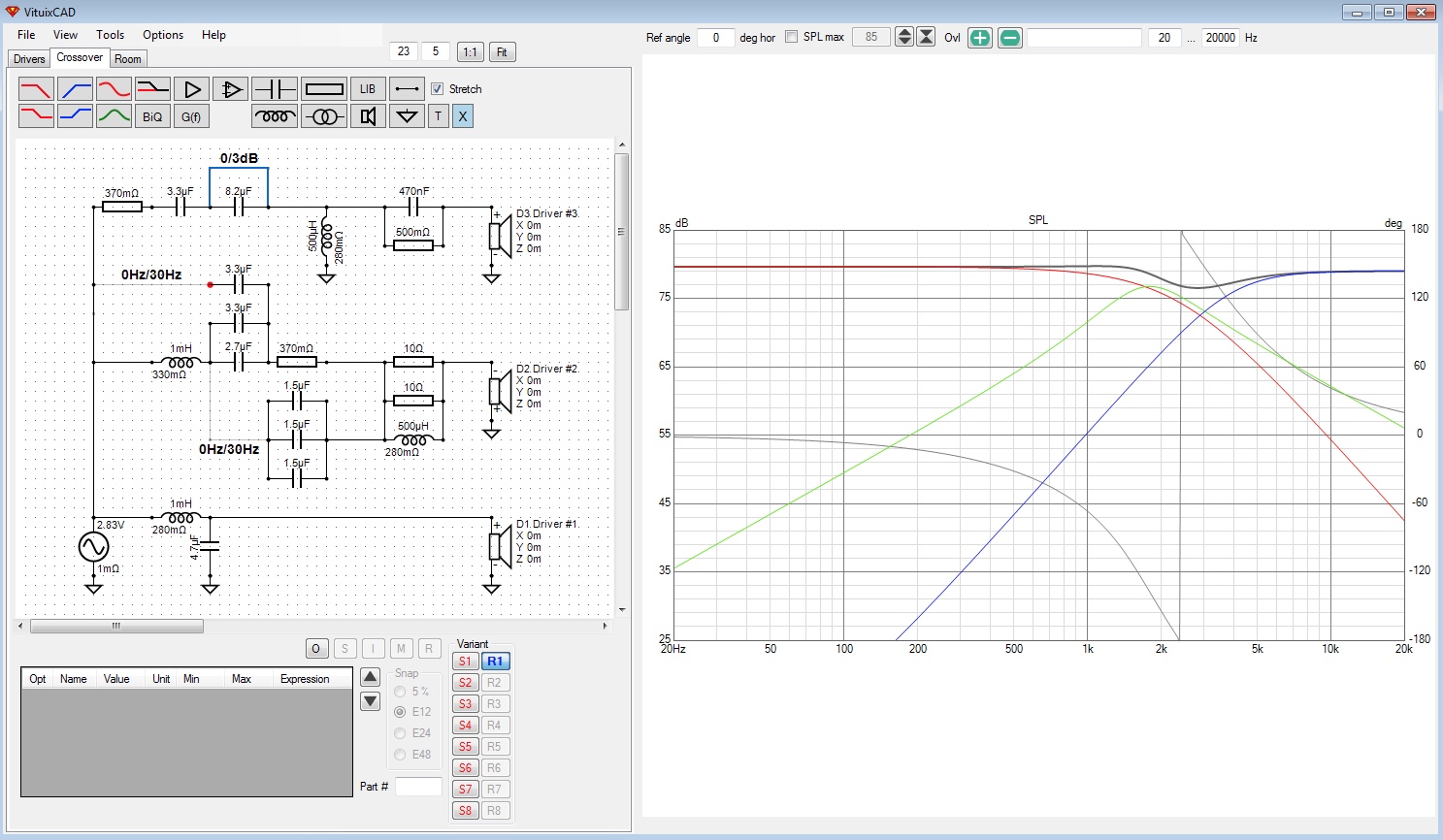

Image 3 is with the 0Hz/30Hz switch going to the three 1.5 uF capacitors closed.
Image 4 is with the last 0Hz/30Hz switch going to the 3.3 uF capacitor closed.
Does any if this make any sense? And what about the switch going to the 3.3 uF capacitor, what is it for? Is this really the right component values (not that other values would help much)?

Unfortunately the 1 mH and 4.7 uF for the Lowpass/Bass section is not even close for an 8 Ohms 10"woofer. This should in reality be in the 5 mH/80 uF ballpark.
The electrical sims in VCAD tell only half the story: load the real in box measurements (.frd and .zma files) of the drivers and it will get even worse. Sorry to say, but this x/o looks like a waste for such fine drivers.

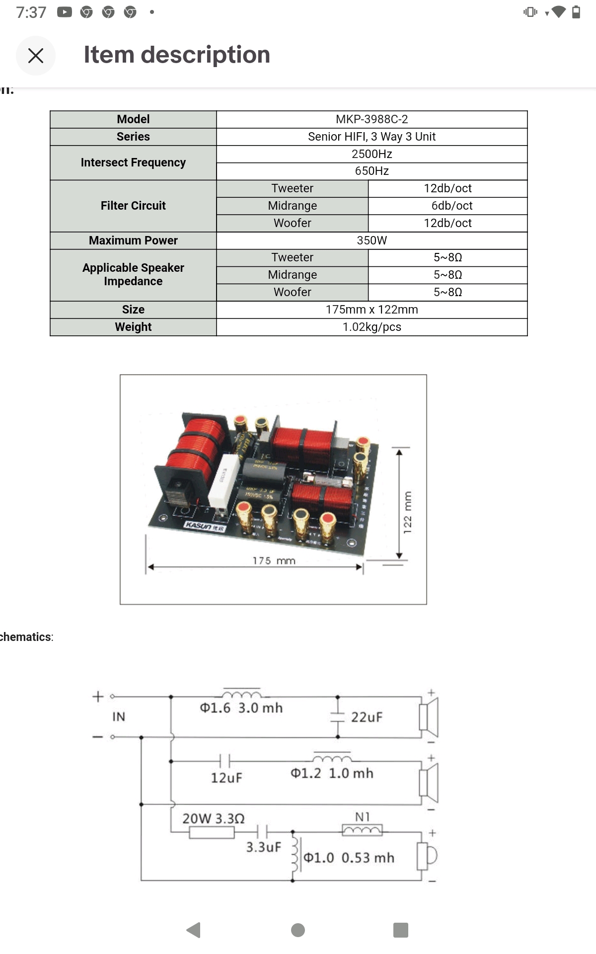

The only other crossover I could find that comes even close is this Kasun one at 3 times the price below in pic. Would this one work for my set is it enough for the 10".
There is also a 300w Dayton crossover called at XO3W-375/3K that crosses over low. Here is the Kasun it's at 650 and 2400 khz

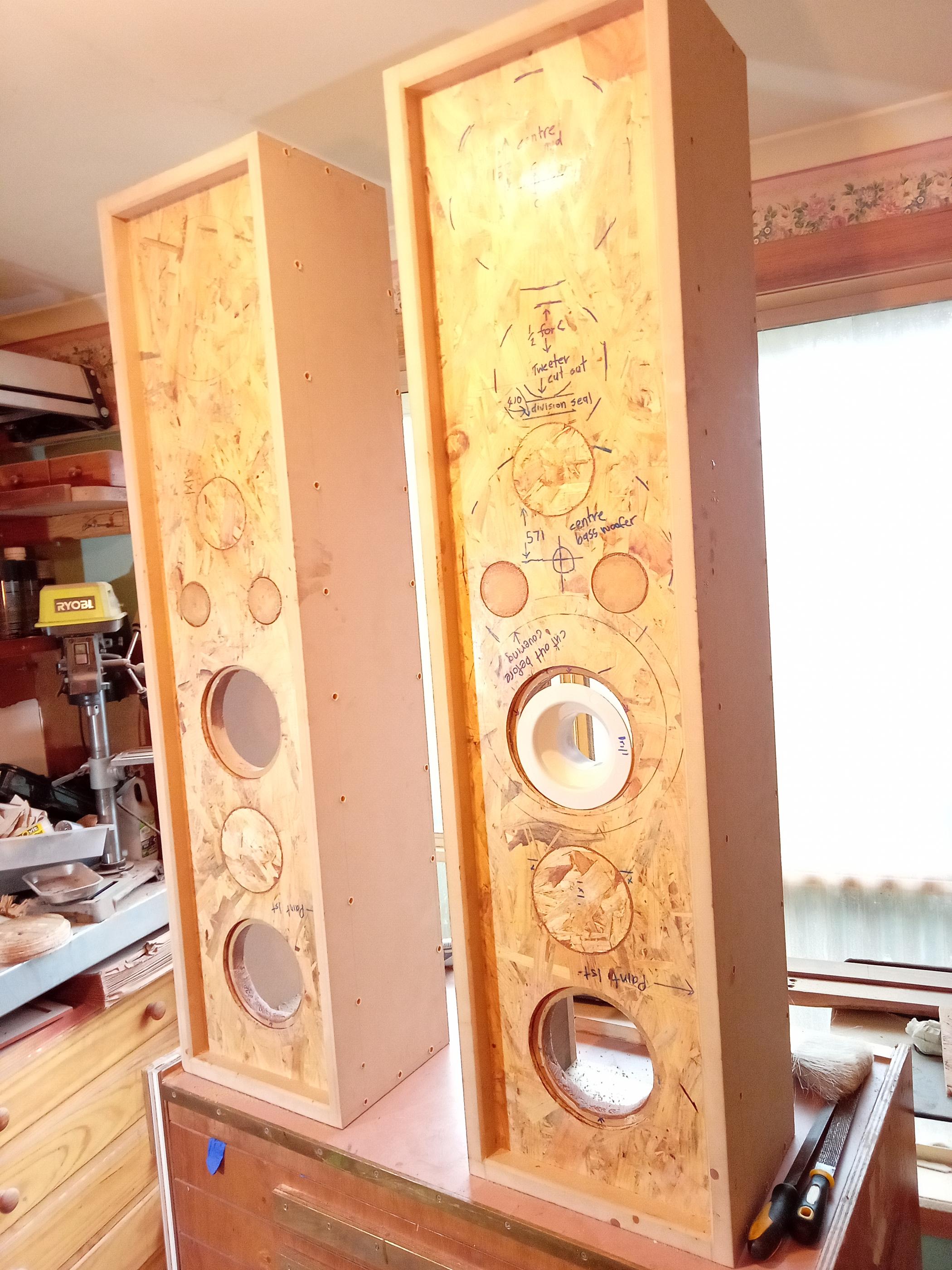

Can you see how many mistakes I've made on my speaker boxes re in pics. I think I've redone the calculations near 100 times.
No because the boxes are just one piece of the puzzle. There are usually many rights and wrongs and a lot in between. Not referring to your boxes but generally speaking.

I couldn't find any crossover's with 5 mH/80 uF for bass 10" woofer. Looks like it will have to be made.
It is almost always better to custom build a crossover than to buy a generic one...

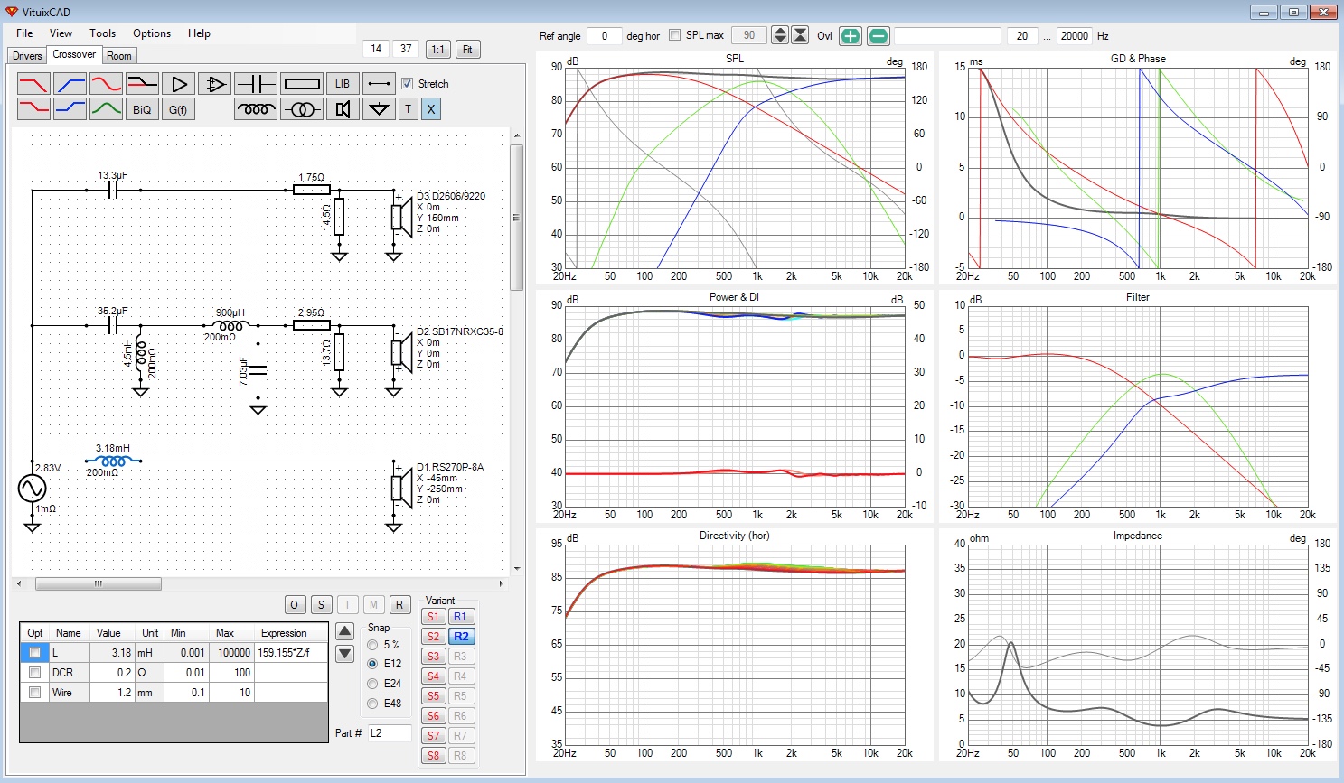

OK here is my first stab at this, entirely built on manufacturer specifications and personal preferences so take it for what it is.
First we need to find out if the woofer is suitable for a sealed or a ported enclosure. So we calculate the Efficiency Bandwidth Product (EBP), it equals Free Air Resonance (Fs) / Driver Electrical "Q" (Qes) -> 22.9 / 0.42 = 54.5. Less than 50 calls for sealed, more than 90 calls for ported, anything between and we can go with either. We got EBP = 54.5 so we can go with either but I personally go for sealed whenever I can. I find them to sound better, they are easier and more predictable to get right and the bass can easily be extended with EQ.
You can do the same calculations for the mid if you want. The EBP = 88.9 but I don't even consider porting it when used as a mid.
I use the VituixCAD Enclosure Tool to figure out the volumes needed for the mid and the woofer where Qtc = 0.707 (critical dampening). This is what I get:

Next up would be the LF and HF crossover points. I have no experience with these drivers so I really need some help here. The woofer looks usable up to 300-400 Hz. The mid down to 300-400 Hz. LF around 400 Hz? HF seems a bit more problematic. The tweeter looks usable down to what, can it go as low as 2 kHz? The mid up to 2 kHz? HF around 2 kHz? Any other thoughts?
Something like the attached image as a starting point maybe? Someone else can probably do better. One drawback f3 = 52.6 Hz for a 10 inch woofer feels a bit on the high side. It can always be extended with a Linkwitz transform but it would have been nice with a lower f3. Maybe someone can come up with a ported alternative? A first order filter between woofer and mid would save some money. Maybe spend it on a third order filter between mid and tweeter?
Ps. there are a lot more to be done. I haven't simulated the baffle yet because I have no idea what you want the enclosures to look like, height, baffle width etc. It is needed to simulate baffle step loss and add it to the mix...

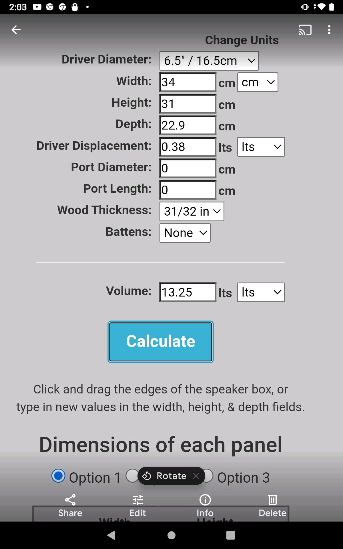

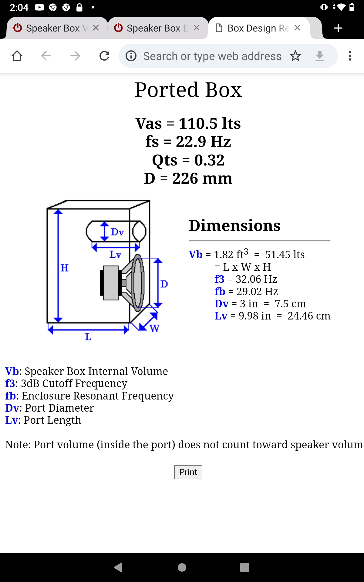

I would like to use a ported enclosure with the 10" woofer because my last speakers were sealed (possibly done incorrectly) and I couldn't hear the bass to anything like the degree I have with my previous DIY ported boxes. Although admittedly I was using to small a crossover.
My new speakers box sizes are
1338 x 340 x 290 mm all 25mm thick material accept for back which is 19 mm
The front baffle is 43 mm thick (measuring o/a of 25mm to give 290 width for calcs)
Minus internal bracing
That gives me 51.87 litres for the 10" ported woofer and
13.25 litres for the SB 6.5" sealed (SB recommends 7 litres sealed 50% filled with poly)
Here is a project using the same woofer in a 51 litre enclosure in link I was planning on using his port size of 18.8 cm but 70 wide instead which is what I was able to get locally.
See his designer spread sheet calcs.
Dayton RS270P-8A - Lockdown project. - DIY Audio Projects - StereoNET International
I have made an error calculating a qtc of 0.707 instead of your 0.710
Here is the 10" woofer design calculations
and exact size from diy audio calc
Kind Regards Tim
This is what VituixCAD gives for a ported design:
Code:
STATISTICS
 f3     34.6 Hz
 f6     28.7 Hz
 f10    23.8 Hz
 Zmin    6.8 Ohm @ 39793.9 Hz
 Zmax   24.6 Ohm @ 13.2 Hz
 GDmax  14.7 ms  @ 24.5 Hz
 XmaxC   4.5 mm  @ 5 Hz
 VmaxR     3 m/s @ 21.2 Hz
 Pmax    1.2 VA  @ 39793.9 Hz
DRIVER: Dayton Audio RS270P-8A, 1 pcs in series
 n0      0.31 %       Reference efficiency
 SPL     87.0 dB/W    Sensitivity
 USPL    87.7 dB/2.83 Sensitivity
 EBP     54.5         Efficiency bandwidth product
 Dd      21.0 cm      Effective diameter of driver
 Vd     207.8 cm^3    Maximum linear volume of displacement
 Cas  7.92E-7 m^5/N   Acoustic equivalent of Cms
 Mas    6.1E1 kg/m^4  Acoustic equivalent of Mms+Mme
 Ras   6.75E3 Ns/m^5  Acoustic equivalent of Rms
 Rae   2.07E4 Ns/m^5  Acoustic equivalent of Re+Rg
BOX REAR 1: Vb=46.7 l, Ql=7.0
 Fb      28.3 Hz      System resonance frequency
 Cab   3.3E-7 m^5/N   Acoustic compliance of air in enclosure
 Rab   5.66E2 Ns/m^5  Acoustic resistance due to absorption
 Ral   1.19E5 Ns/m^5  Acoustic resistance due to leakage
VENT REAR 1: Dv=6.8 cm, Lv=23.2 cm
 Sp      36.3 cm^2    Effective area of port
 Map   9.54E1 kg/m^4  Acoustic mass of air in port
  Rap    1.7E2 Ns/m^5  Acoustic resistance of port losses
The important parts for your box:
  • BOX: Vb=46.7 l
  • VENT: Dv=6.8 cm, Lv=23.2 cm
f3 = 34.6 Hz, nice. Expect around 34.1 Hz for a box volume of 51.87 l, but port tuning is not my strong suite...

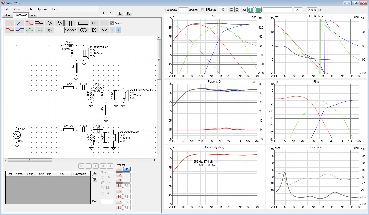

I don't know where you positioned your drivers on the baffle. I positioned the tweeter 138 mm down and 100 mm from one of the sides (to get it at 1200 mm listening height). I then positioned the mid on the same x-axis another 150 mm down. The woofer another 250 mm down but positioned on the center x-axis. I used the mid as the acoustic center of the simulation. This is all just approximations so it should all be taken with a grain of salt.
I did a quick simulation of the baffle step loss, I did not include it in the crossover simulation. You will probably get most of it back from room gain (depending on where you place the speakers).
I have no idea if this would work or not but I tried to come up with the most cost efficient crossovers possible (i.e. with as few components as possible). I could not make the mid work with a first order filter so I went with a second order Butterworth @ 400 and 2000 Hz. The woofer and tweeter both got a simple first order filter (also @ 400 and 2000 Hz). I have never built anything like this before but it seems to work in simulation. The real world might look different though. Impossible to know without proper measurements...
