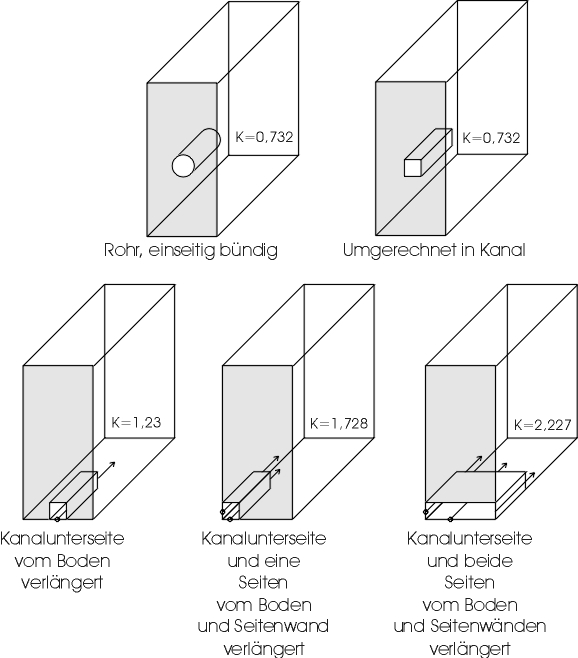

As I already said, port tuning is not my strong suit so please correct me if I'm wrong. I think the port length equation is:
Port Length (L) = (2.35625 × 10^4 × D^2 × N) / (Vb × Fb^2) - K × D

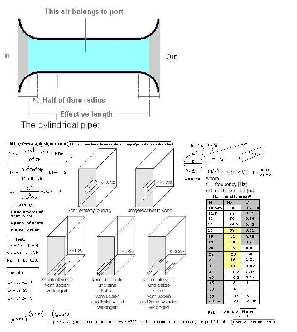

And end corrections factors according to attached image.
I further think that you are supposed to keep the height to width ratio of a slot port no more than 1 to 8.
288 mm wide -> 36 mm height. 28.8 x 3.6 = 103.68 cm2 -> 11.49 cm diameter of a circular port.
Fb = 25.1 Hz for the woofer if Vb = 54.5.
K = 2.227 for a slot port.
Port Length (L) = (2.35625 × 10^4 × 11.49^2 × 1) / (54.5 × 25.1^2) - 2.227 × 11.49
L = 65 cm, that is a rather long port...
If you don't care about the 1:8 ratio (seems to be based on some JL Audio whitepaper without any reason or data for why they recommend 1:8 as the maximum ratio) and make the height of the slot port 2 cm instead.
28.8 x 2 = 57.6 cm2 -> 8.56 cm diameter of a circular port.
Port Length (L) = (2.35625 × 10^4 × 8.56^2 × 1) / (54.5 × 25.1^2) - 2.227 × 8.56
L = 31.2 cm.

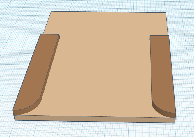

Look at the two attached images. I have tried to illustrate the bottom of the box in light brown and two pieces of MDF on top of it in darker brown. Those two pieces can be made to adjust height and width of the port then cut to length. I have rounded them to make a flair. The second image is me trying to illustrate how the rest might go around the bottom to make up the slot port.
Note: Troels uses a 20 x 200 mm slot port in his ScanSpeak Bookshelf-3WC build. He uses aperiodic tuning for that build but I don't think a 20 mm slot port necessary being too narrow: Bookshelf-3WC
The slot space would need to be 288 mm wide. For the 46.71 litre size.

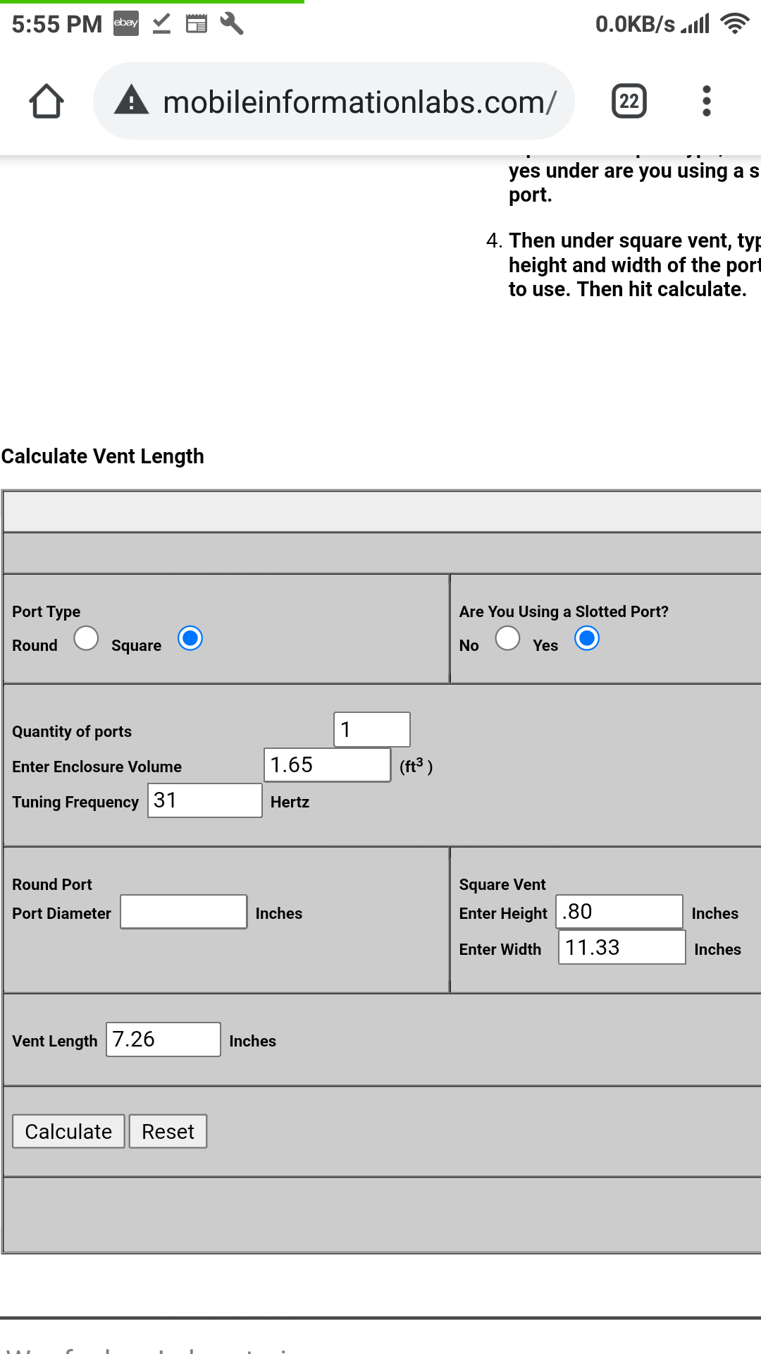

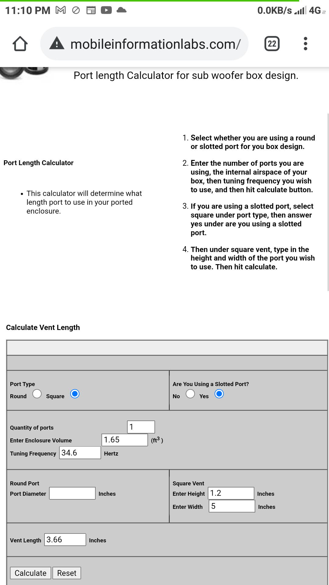

That looks very nice I like it but I think you did the calcs based on 54.5 litres not the 46.7 figure you also gave me earlier, last night I tried to get 54.5 litres but just didn't have the space in it, 46.7 gives me lots of room for bracing and the the slotted port wall thickness.
The online calc I used says I only need 7.26" long slotted port length with those dimensions. I couldn't work out why such a difference with the same dimensions. I think this one is inaccurate see screenshot.
Port Length Calculator
OK. I will do all simulations from now on based on 46.7 liters for the woofer.
K = 2.227 for a slotted port will make it shorter. The reason behind the 2.227 constant is quite complex and it looks like a lot of online converters (and even simulation software) only do conversion based on port area.

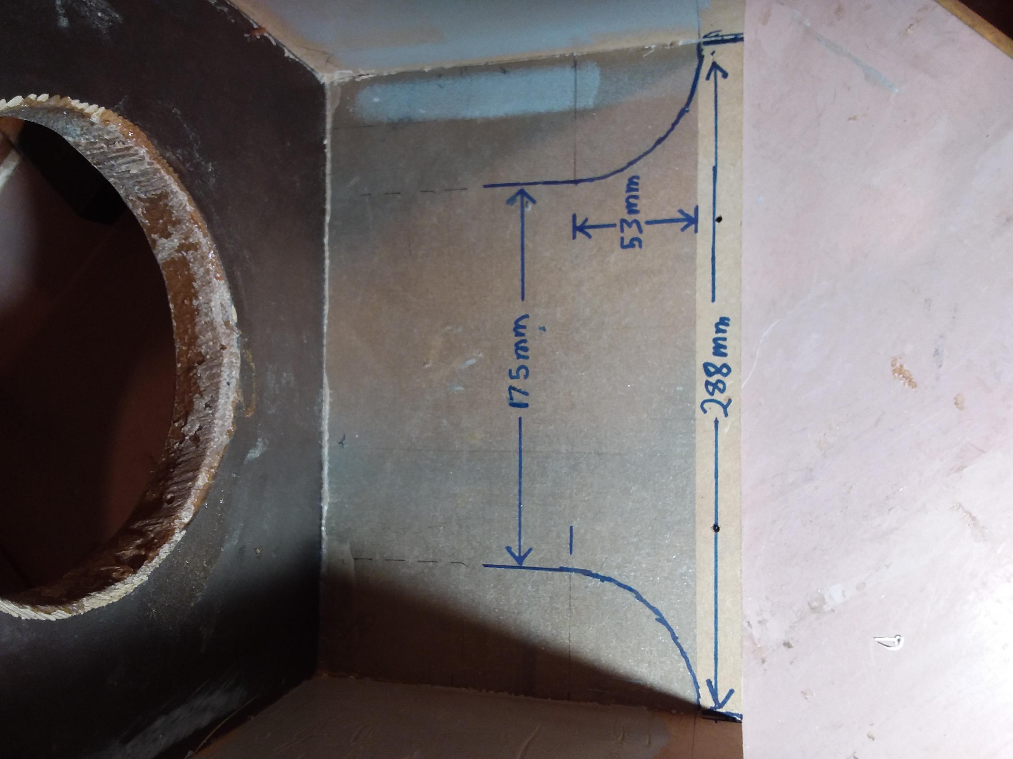

I like what you did in the detail in the attachment, is this viable in attachment here with a 36mm high slot if not then a 25mm slot. For 46.71 litre? I would do it front facing as it looks nice.
So the hole I see in the picture is at the back and the port flare is facing forward, right?
175 x 36 mm equals a port area of 63 cm2 -> 30.4 cm port length.
Code:
VENT REAR 1: Dv=9.0 cm, Lv=30.4 cm
 Sp      63.0 cm^2    Effective area of port
175 x 25 mm equals a port area of 43.75 cm2 -> 18.4 cm port length.
Code:
VENT REAR 1: Dv=7.5 cm, Lv=18.4 cm
 Sp      43.8 cm^2    Effective area of port
That was all simulated with the "mythical" 2.227 end correction factor...
The hole is the front of the speakers I just drew it like that because it was easier. The flare will be forward facing at the bottom of the speakers.
The pieces that sandwiches the flares between them will need to extend past the flares at the front 6mm so I can radius the edges a little for a smooth exit. I think that may change the port volume a little.
I did the calculations with that link and got the same 8.25" length. I like this, I think it will suit my box. I saved the photo too thanks ☺️

For reference and future documentation, I think I found the text that goes with the "German picture" of end correction factors (see quoted text below and attached file). So this adds a bit of context to the picture. A quick highlight from the text translated to English:
The following applies to the correction factor:
  • 0.85 for port flush on both sides (e.g. housing wall only)
  • 0.732 for one-sided flush ports (normal case)
  • 0.614 for ports protruding on both sides inside and outside (e.g. with a screwed-in pipe, if the flange is not countersunk)
  • 2.227 for a port like the VOX 25x
  • 1.23 for a three-sided enclosed port that only has one extending side wall (see VISATON 'Filou')
  • 1.728 for a port extended by two housing walls.
The port used with end correction 2.227 is likened to what was used for the VOX 25x. It seems to refer to a series of speaker designs by VISATON, e.g. VOX 253 (see the other attached file). It can be compared to the port type used for the VISATON Filou with the recommended end correction 1.23.
Ps. Note: the author is comparing the formula Lv = 10 * c ^ 2 / (16 * pi) * D ^ 2 * Np / (fb ^ 2 * Vb) -k * D, to F.H's formula l = 10 x c² x A / 4 x pi² x fb² x Vb - (0.5 x (Pi x A) ^ 0.5). The former using different end correction factors where the latter seems to use a general end correction factor of about 0.785.

I think it best I use the info provided re the crossover and source a ready made crossover.
I tried incorporating the port slot in my box today and it was too difficult due to the fact I have already assembled the sides and front. I'll put a round port in the side.
