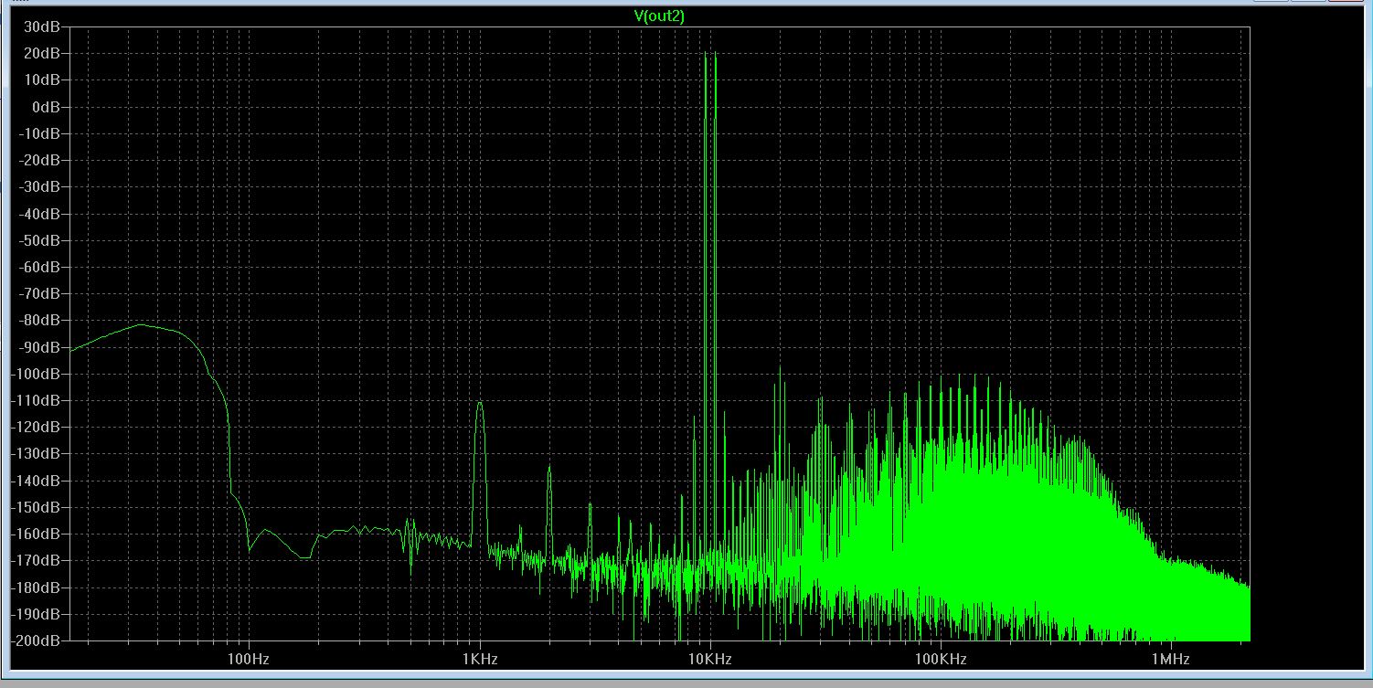

I actually have the QuantAsylum. But it won't work the way you suggested as it is a single end input where one side is grounded.
I have been doing simulation with LTSpice with your idea of tapping the middle of the resistor between the two driver transistors. I even put a voltage divider across the voltage spreader ( using 1M resistor for divider so not to load the VAS). The result is bad!!! I did two or three OPS even with crossover compensation and I did not get better than -30dB on the more important 3rd harmonic. I even ran the simulation of the famous Nelson Pass's Aleph3 ( that actually got me looking into all these crossover compensation) and the result is not that good.
I want your opinion whether I am right or not: if I run the usual 1KHz, 5KHz, 10KHz and 20KHz FFT. More importantly, run two tone test at say 10KHz. Pick the one that is lowest and go with it. If I get over -90dB on the harmonics or intermod, that's a good design whether there is crossover compensation or not.

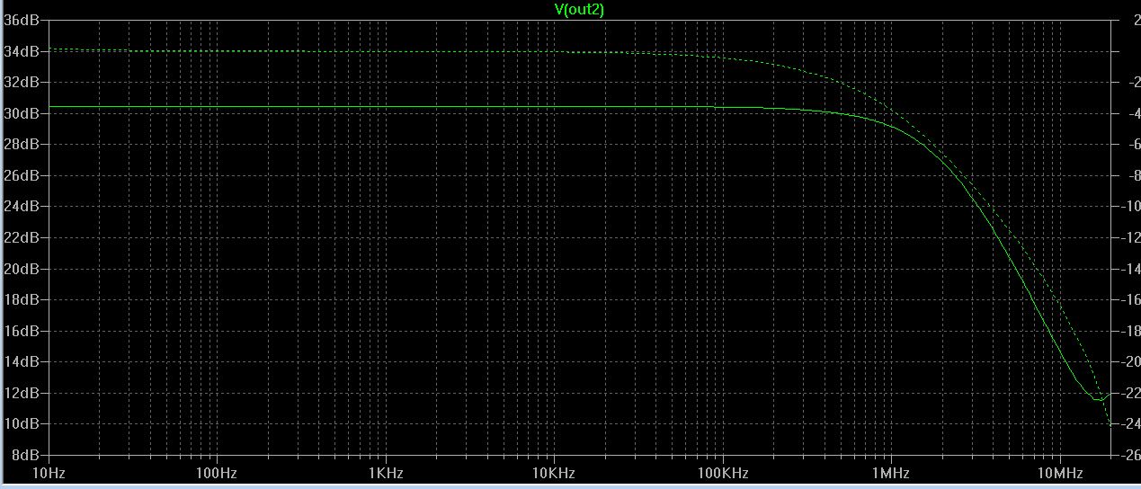

In simulation, I tried exactly what you suggested AND I put a voltage divider across the bias spreader to tape the mid point. Result is exactly the same. I was expecting to get more distortion when tapping the bias spreader as it includes the change of Vbe of the drivers...or pre-drivers for 3EF. But it's exactly the same.
Well, depends on the values you are using for the divider.

Optimal bias threshold is rather narrow, so adding a divider in parallel with the spreader would definitely influence the bias, if the R values are rather low.
Ah! I see now - it's 1M - then it's too high.
Anyway, it looks to me that the bias is not optimal in your simulations. Too consistently high, from what I see.

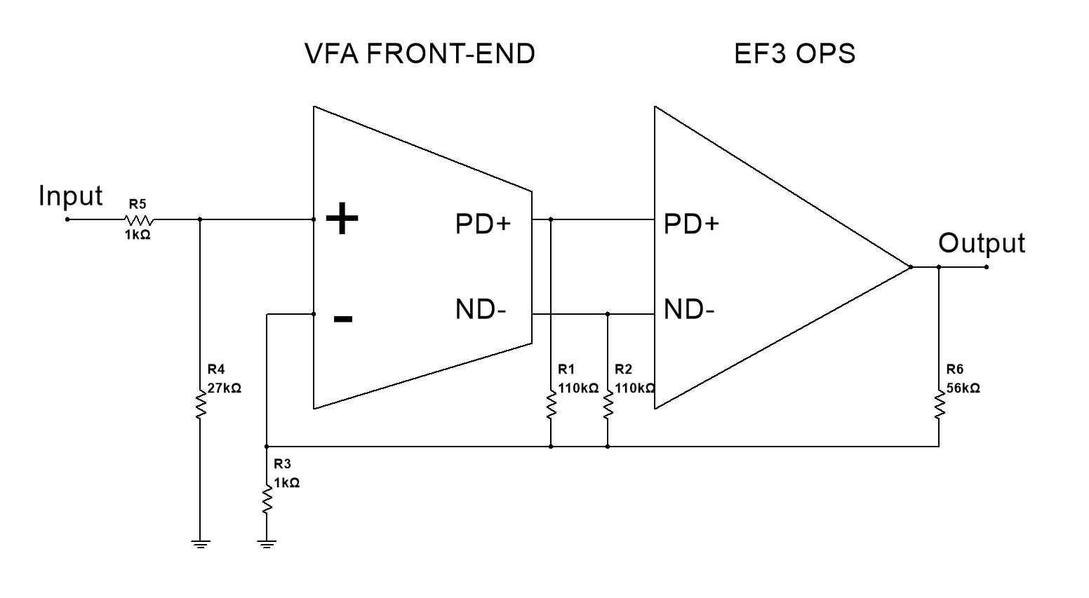

It is assumed, that you connect NFB resistor to the center tap of the emitter resistor (in case of the pre-drivers approach, as Bob recommended), or you connect it to the center tap of the divider, placed over the spreader (in case of VAS approach, as I described earlier).
Now, if this divider, placed over the spreader, is made of 1M resistors, your NFB loop gain is changed significantly (to almost open loop). That's why this is not the right way of doing it. That's why I split the NFB resistor in 2, double the value of each of them, and connect them on both sides of the spreader. Then the loop gain stays the same for the front-end.

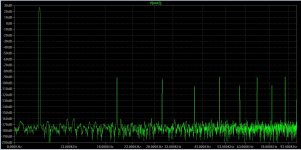

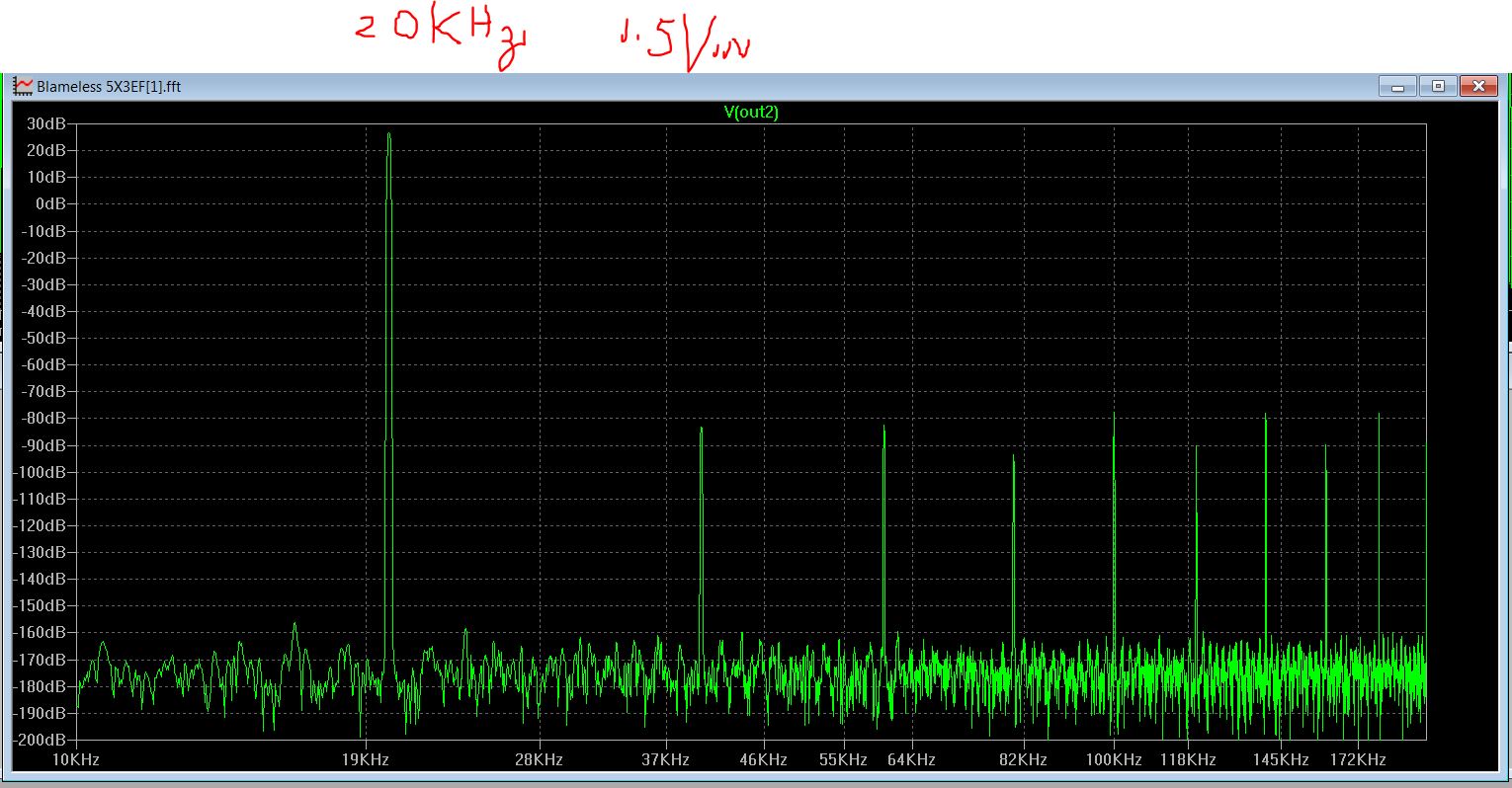

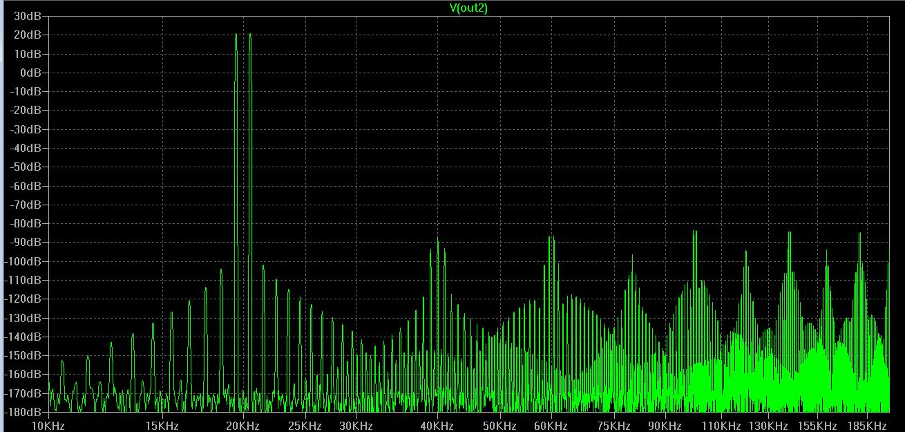

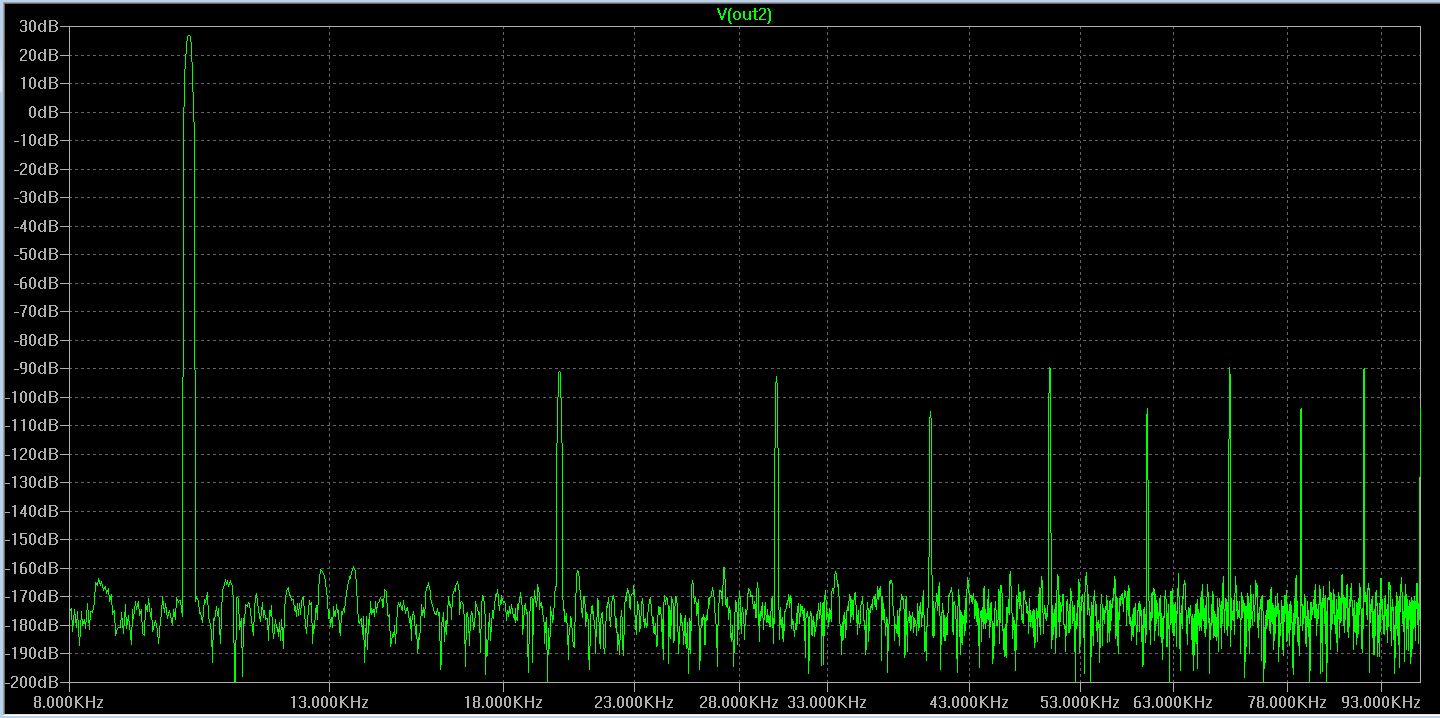

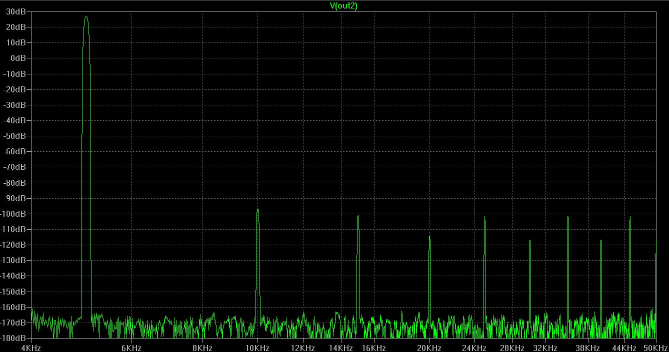

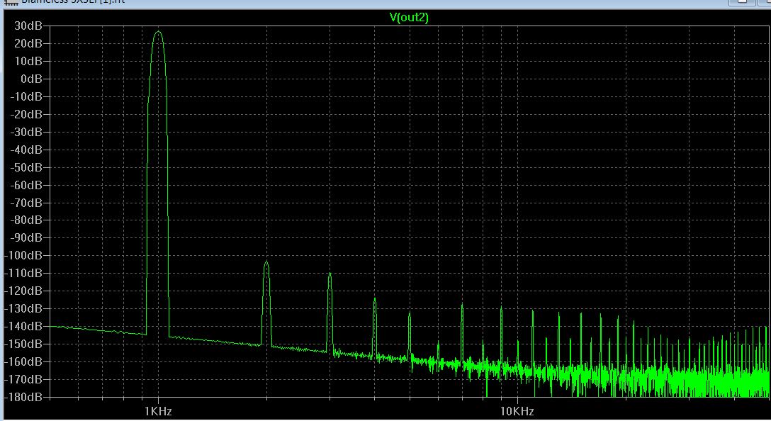

Since I have no luck with simulation, so I turn to the opposite direction. I have been playing around with simulation of a simple minded "Blameless" something like Doug Self used with 3EF and 3 pairs of output transistors at optimal bias. I only posted the one with 30V output for 1, 5, 10 and 20KHz. I include also two 2Tone simulation of 10KHz and 20KHz center frequency. You can see the harmonics are over 100dB down from the main signal. The 2 Tone simulations look very good with over 100dB. I also attached the .asc I used to generate these plots.
I don't know how representative are the simulation to the real circuit, whether you can get these result in real life. But over 100dB in every single case, 120dB at lower signal level like 10V output. That's pretty impressive. Particularly I use 4ohm load, not 8 ohm.
Two tone Blameless 3EF X3pairs 19.5KHz 20.5KHz 0.75V.JPG177.3 KB · Views: 149

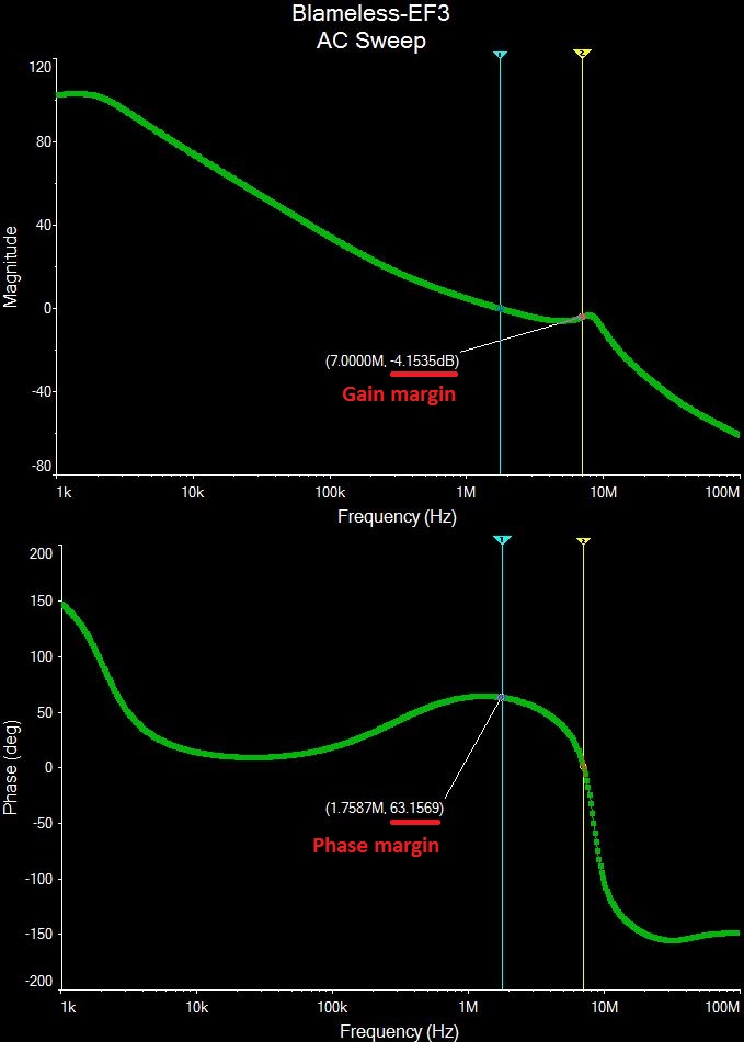

Unfortunately, the way it is shown, it will not work in the real world.
102db loop gain at 1KHz (huge), only 4db gain margin (almost none).
Meaning - it's unstable. Even in simulation - if you send it into clipping (which is rather awful - full of artifacts), it starts oscillating on recovery.
102db loop gain is rather difficult to stabilize. Possible, but you will have to sacrifice many other good things. Not worth it.

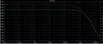

Feedback loop analysis of your circuit is attached.

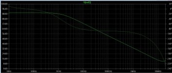

I ran the simulation on both close loop and open loop gain phase plot. Yes, it is not stable at the end of the plot. I ran the open loop by changing R123( feedback resistor) to 1ohm to increase the gain of the amp to 20000. This pretty much show the open loop gain to plot the gain phase.
I don't think it look that bad. From looking at the plot, it should be not that hard to put a lag lead at frequency beyond 20KHz(beyond audio range) to get a little more phase margin. Say putting a poll at 25KHz and a zero at 200KHz to drop about 20dB gain, I don't think it will increase the distortion much. But say it increase by 10dB. Still in most part, it's over 100dB down. I'll get to it when I have time.
I ran at output =30V into 4ohm. That's tough. If I run smaller signal, driving 8ohm, I likely will get about -110dB distortion even with extra compensation.
But again, this is theoretical talk.
I don't think it look that bad. From looking at the plot, it should be not that hard to put a lag lead at frequency beyond 20KHz(beyond audio range) to get a little more phase margin. I don't think it will increase the distortion much. But say it increase by 10dB. Still in most part, it's over 100dB down. I'll get to it when I have time.
You have to use one of the methods for looking what happens inside the loop when the loop is closed (that's what my plot shows).
Running it open loop does not give you the right picture.

Use the Tian probe method from the exsaples directory of LT-spice, that will give you a good indication of circuit stability. A dirty an quick glanze can be made by breaking the loop with a 1GH inductor.

Bear in mind that looking at in-situ distortion of the output stage by connecting the analyzer to the center-tap of the driver does not require a balanced input.
Looking at the driver center-tap distortion of an output stage in-situ in a closed loop can be quite revealing of how much distortion the output stage is contributing open-loop. the number -30 dB (about 3% HD) does sound a bit bad, however.
Traditional crossover distortion is basically static, and largely independent of frequency in the open loop. In the closed loop, it will go up with frequency because the feedback loop gain is going down with frequency. So, for evaluation of ordinary non-frequency-dependent crossover distortion in an output stage, just taking a look at 1kHz THD is a very good start.
