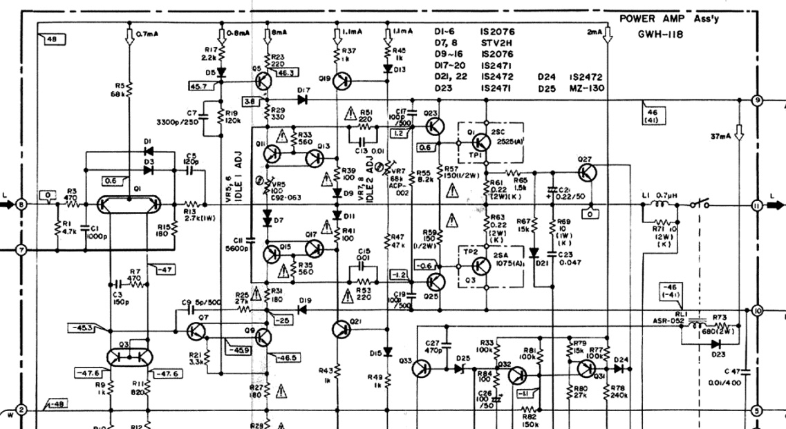

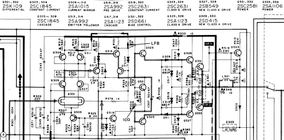

hello,
would there be an intellectual property infringement if a company sells three small PCBs, or carrierboards, about 1.5 by 1.0 inch tall, fitted with SMDs, ready to use, providing each one a specific Class AB biaising scheme :
- "New Class A" bias module (see Technics folklore - synchro bias)
- "Super-A" bias module (see JVC folklore)
- "Non Switching" bias module (see Pioneer folklore)
The idea is to help hobbyists designing their own audio power amplifiers, making an effortless revival of the three non-switching class AB biaising methods. Hobbyists and designers would integrate the module of their choice onto their own main board.
Technics "New Class A" is relying on fast diodes, implementing a dynamic switch that is automatically chosing between the voltage that's coming from the driver (this is when the output device is pushed to drive the load), and between a fixed voltage that is preset and defining the minimum bias current (this is when the output device gets pulled out, with the load being driven by the other half).
Looks fine, apart from the inherent switching nature of the process. Technics engineers used to call it "synchro-bias", but the marketing rejected that name, and coined "New Class A" for very understandable reasons. I guess that nowadays ultrafast diodes can be used, specified with a less than 10ns switching time, an order of magnitude faster than the output devices.

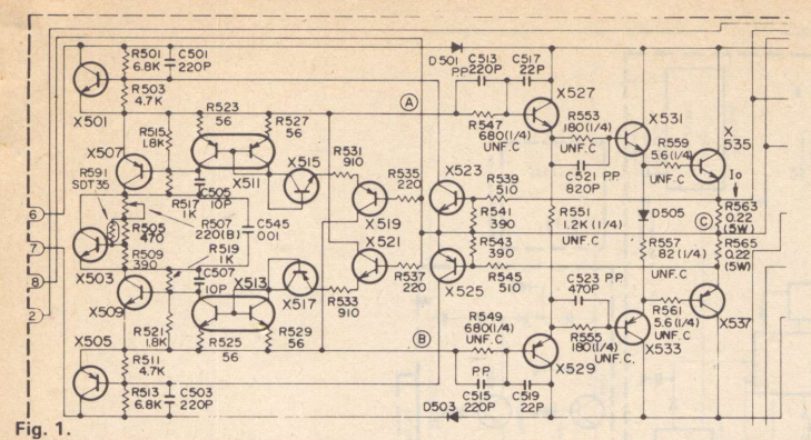

JVC "Super-A" monitors the sum of Vbe of all output devices, plus the voltage drop that occurs on the 0.22 Ohm emitter resistance. This voltage gets then compared to a fixed threshold (like 2 Vbe in case of a Darlington), and when the total voltage gets beyond this threshold, plus a little something, a transistor fitted into the Vbe multiplier arrangement acts to gently increase the multiplication coefficient.
Looks weird, like a positive feedback ! The increase rate must remain well controlled.
Pioneer "Non Switching" monitors the sum of Vbe of all output devices, plus the voltage drop that occurs on the 0.22 Ohm emitter resistance. This voltage gets then compared to a fixed threshold (like 2 Vbe in case of a Darlington), and when the total voltage gets beyond this threshold, plus a little something, a transistor fitted into the Vbe multiplier arrangement acts to gently increase the multiplication coefficient.
In essence, this is exactly as JVC "Super-A". Pioneer scheme needs a supplementary current source, which would make transistor count higher than JVC "Super-A", but on the other hand Pioneer takes some shorcuts regarding the Vbe multipliers, saving transistors over there.

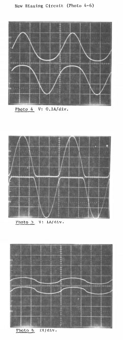

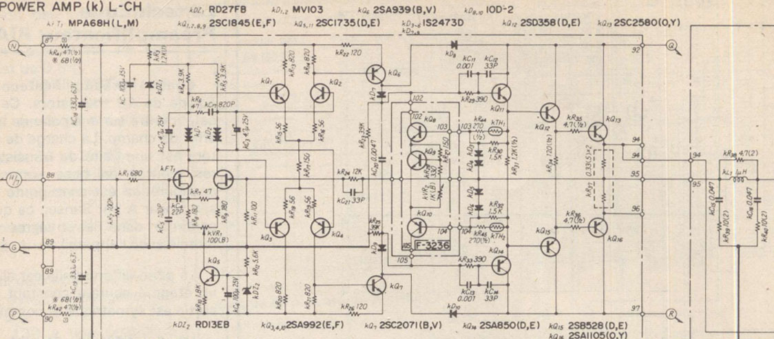

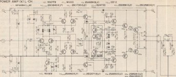

Sansui "Tanaka Non Switching" monitors the sum of Vbe of the last two power devices, plus the voltage drop that occurs on the 0.33 Ohm emitter resistance. This simple schematic seems to be effective as explained by Tanaka, the author of the design, in the AES publication he made in 1980.
AES E-Library: New Biasing Circuit for Class-B Operation
There are, however, some differences between the circuit that got described at the AES, and the practical implementation in the Sansui AU-D5 amplifier.
Don't know if there are practical Sansui implementations, closer to the circuit that got described at the AES.
See attached pictures.

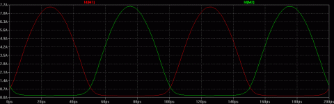

Excepting for design with diodes, others only work as advertised into resistive load.
A reactive load can source or sink away the reserve current, causing the affected
power device to still shut off sometimes.
I like Schottky diodes to moderate the crossing: square law curves, low dissipation,
and fast clean recovery. A resistor across the same fixed voltage span, but not in
any way connected to the load, draws the constant reserve current. The diodes
insure the load never has a path to source or sink away this reserve.
I slave the power devices to the curve of the diode crossing. I do not curve upon
the law of hot devices that may or may not always be well matched compliments.
Much easier to trust two cold Schottkys be our good quasi-complimentary match.

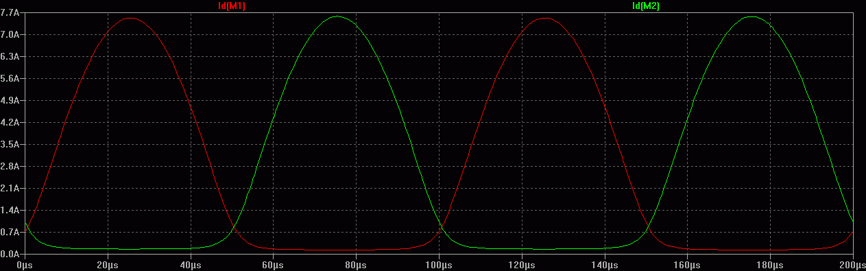

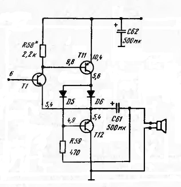

The making of an effortless revival from all non-switching class AB biaising methods is indeed an interest idea for the aim of evaluation. Perhaps anybody realize this and offer such an evaluation amp kit.

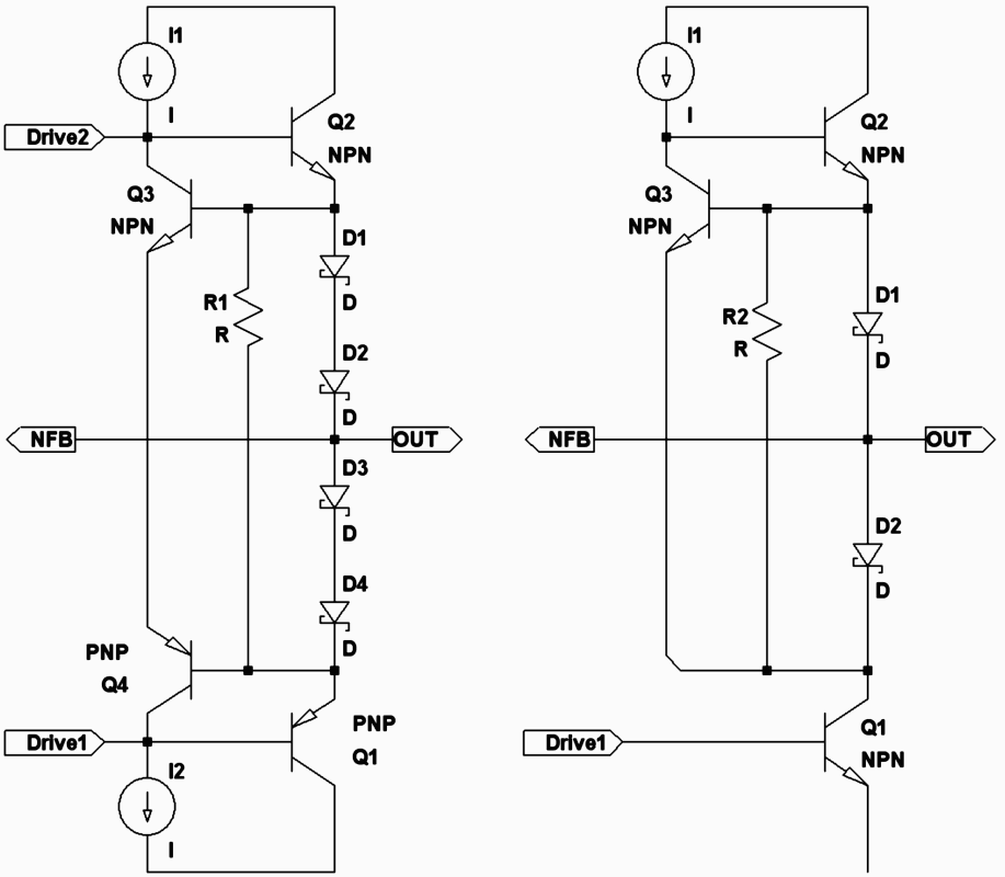

Far as I know: The easiest way to assure operation in this class is to cross
deliberately underbiased Schottkys. Thus forcing them to operate upon the
square law curve. You then use this law to re-curve your power transistors
for a super-smooth B crossing! Plus the reserve current always bled by R1.
It doesn't matter that Schottkys operate in Class B and turn off. There is
no significant tail current, and they recover fast. The slow transistors are
always conducting the reserve current, and thus in Class A at all times.
It doesn't matter the exact quiescent current of an underbiased Schottky
B crossing. Its always more than zero, and less than would blow anything.
Will probably drift a bit with temperature. You can bond Q3 Q4 to heatsink
if you want to assure hot drift always floats deeper into B rather than AB...
It probably isn't necessary.
Remember: We are talking about a deliberate underbias. No more than one
half the Schottky stack can ever be fully on at once. We strictly regulate
the voltage sum across the stack, so that could never happen. Runaway
just isn't a likely event, even if you did nothing to thermally compensate.
Whats a Schottky diode gonna dissipate in this application? Less than 2W.
TO-220 packages are common, so thermals are going nowhere! Hot power
devices only do the work, but are never trusted to make the decisions.
The smoothness of the crossing is assured by the quasi-complimentary
square laws, and not by a specific bias current that has to be controlled.
No attempt is made to define what actual small B crossing current might
be? The extra reserve current bleeder assures the power devices will be
operating well above the small crossing of the Schottkys.

I will show one "well forgotten" circuit from the '60s with the interesting properties.
It is SRPP (in Cl. A bias), but is Non-Switching in Cl. AB bias.
T11 will never switch off. The Non-switching condition for T12 is
V(D5)≥0.5V + V(D6)max.
D6 should be Schottky (to minimize power waste) with the appropriate current rating and in TO-220 or TO-3P case.
Obviously, it is the voltage follower/power buffer and T1 provides the Error Correction function for Pushing and Pulling action of T11, T12.
The bias with the shown values: T1, T12 ~0.4 mA, T11 ~10 mA, D6 is (may be) non conducting. D5 is generally not necessary (only for non-switching T12 and Cl. A bias) and can be shorted. C61 provides bootstrapping for R59.
The circuit can be easily modified for bipolar supplies and scaled for the higher voltages/power.
And now you can explore the quietly ignored "new" idea along these lines from Andreas Wahlberg :
http://www.diyaudio.com/forums/solid-state/21329-self-regulating-class-2.html
espacenet — Bibliographic data
This the famous Nelson Pass patent, indeed. Thanks 1000 times for reminding us. It is panicking to see those japanese companies (Matsushita, JVC, Pioneer, Sansui) rushing around 1978-1979 for Non-Switching Class AB, while Nelson Pass had it done as soon as Feb 1975, with his US patent granted Nov 1976. What are the commercial amplifiers made, and what are the DIY amplifiers made, using Nelson Pass schematic ?
Kenpeter, to change the bias to Cl. A, select D5 to produce higher voltage
drop ~1...1,2V (IR diode, or voltage multiplier) to produce
V(D5)=0.8V(VbeT12) + 0.2V(Schotk. D6),
and reduce R58, R59, to accomodate the bias currents in all transistors, using corresponding betas (current gain).
In class A both diodes will always conduct. That is SRPP.
D5 will conduct in all modes/time.
In cl. AB D6 does not have to conduct when T12 is supplying the current in it's half cycle.
