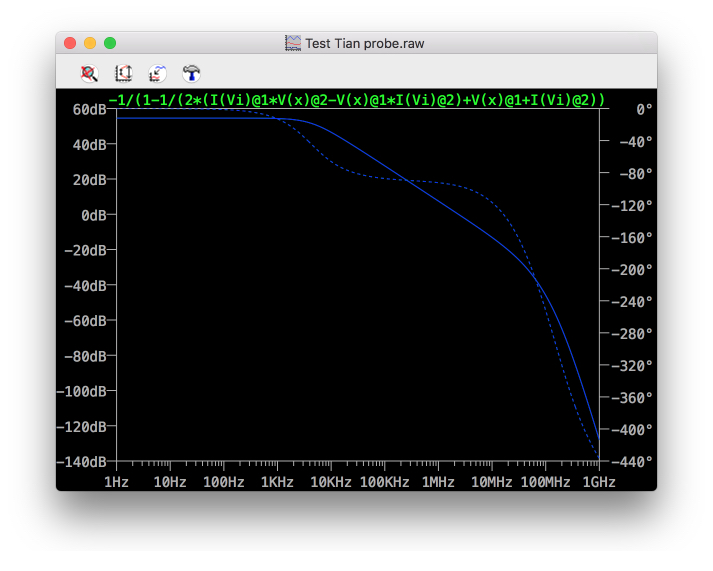

Tha is Tian probe. Just ran simulation, click on output and then change shown plot with -1/(1-1/(2*(I(Vi)@1*V(x)@2-V(x)@1*I(Vi)@2)+V(x)@1+I(Vi)@2)) .
that is on .asc file too.

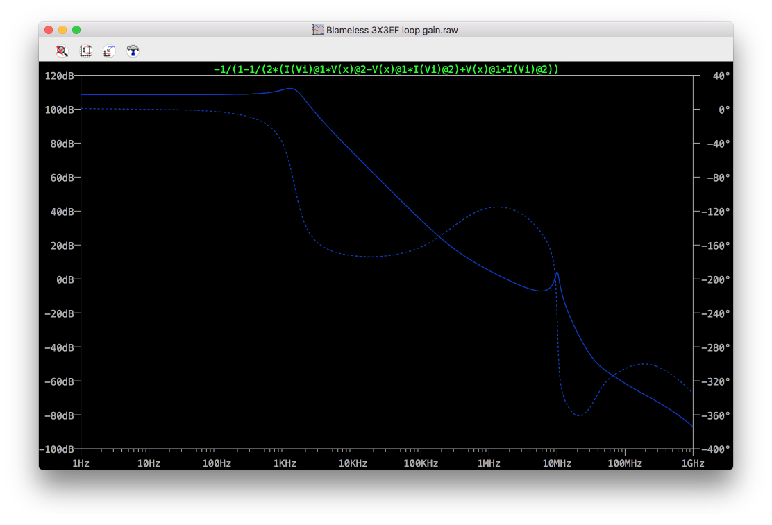

I made it working. Damir - thank you for a hint 😉
Here is the Loop Gain simulated with Tian probe, PM=62 dB, GM= 4 degree. I changed some models as I don't have them.

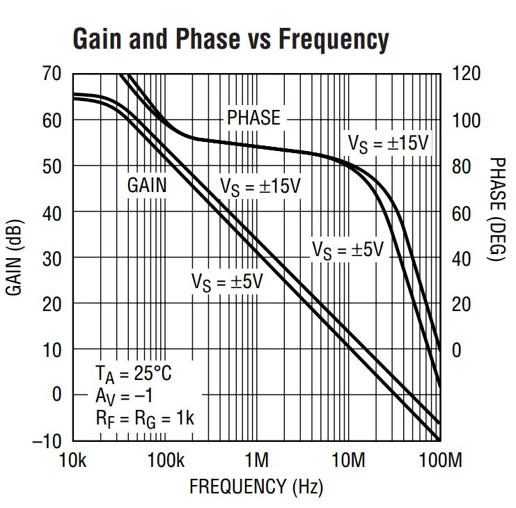

I simulate with your modified file, it does not look right. So I try with a known opamp LT1360. I attached the .asc for LT1360 which is just your program with the LT1360 substituted in. I also attached the open loop gain of LT1360 from datasheet and the graph of your simulation. They don't look that same at all. You have the green trace of phase going to -400deg also.

These curves are different from the datasheet plot you attached earlier, as they are different by nature - the ones in the model show the feedback loop response with the loop closed, the ones in the datasheet are just open loop. Those will always be different. For analyzing stability you need to look at the feedback loop curves with the loop closed. Open loop curves don't give you this info.

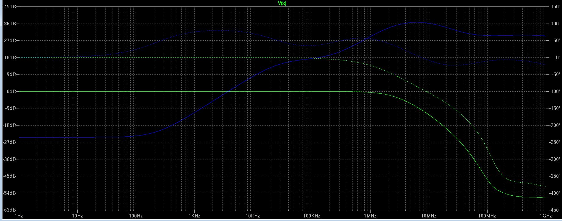

Thanks, I got it. What is the point in the schematic is this? Can you explain this?

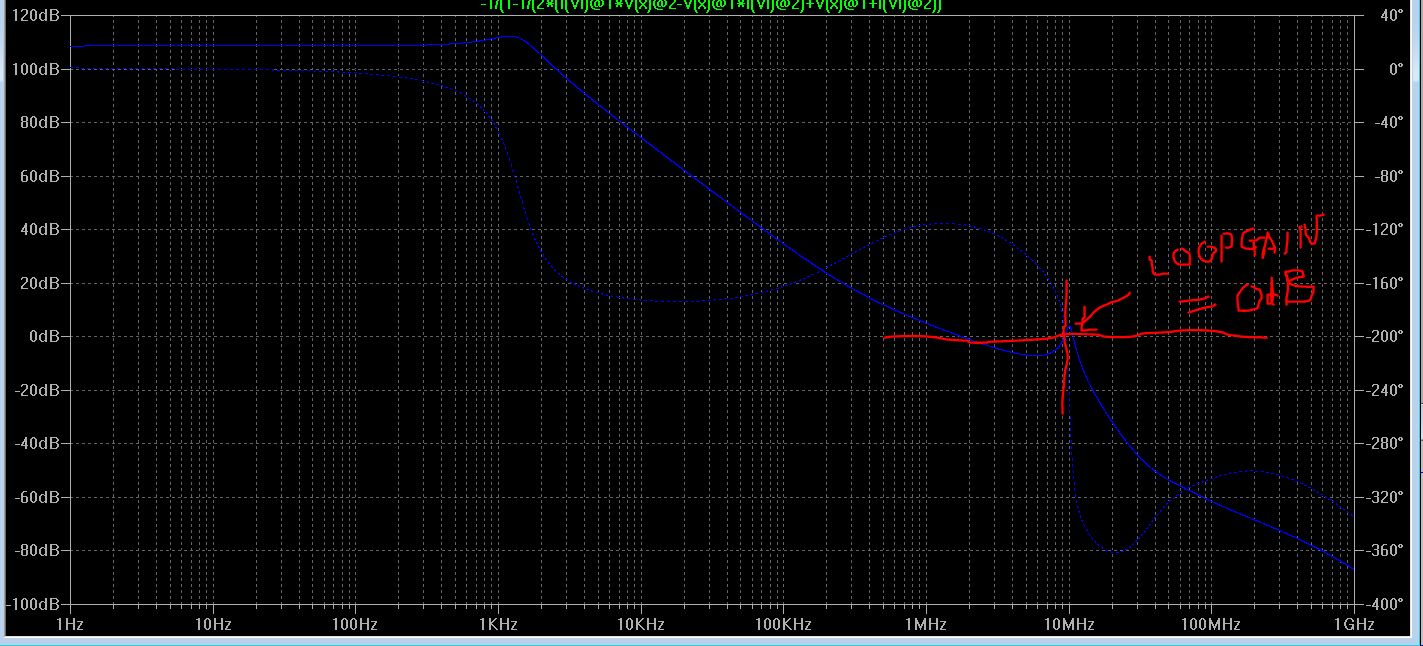

This is the plot per your instruction. This is a loop gain plot with the loop closed.
So you want to look at the loop gain trace at the point crossing the 0dB line. If the phase at that pointis >=180 degrees, then it's not stable.
The phase is about -200 deg, so it's not stable, I need to make the phase at 0dB less than 180deg?

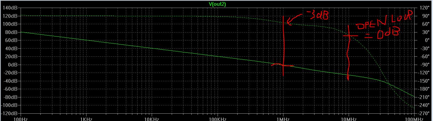

I found my problem. I need to set the amplitude of the generator on the right side, not just the left side. Attached is the .asc and the loop gain phase plot. This looks a lot more like the ones in the data sheet. This is a modification of Valery's idea.
I label the -3dB point of loop gain and 0dB point of open loop gain(-30dB down in loop gain as closed loop gain is about 30dB).

Nothing is wrong with the inductor, just it is not accurate enough. This method is similar with the one used in LoopGain.asc(also explained in the LTspice examples), where you get the loop gain instead open loop gain as with the inductor method. The Tian probe is explain in the LoopGain2.asc :
Here the open loop gain is determined from the closed loop system[1].
The open loop gain can be plotted by plotting the quantity:
Alternatively, you add the following line to your plot.defs file:
.func T.et.al() -1/(1-1/(2*(I(Vi)@1*V(x)@2-V(x)@1*I(Vi)@2)+V(x)@1+I(Vi)@2))
And then plot simply T.et.al()
This is an improvement over the technique shown in LoopGain.asc
because it (i) accounts for reverse feedback(it doesn't even
matter if you reverse the direction of the probe -- you still compute
the same open loop response) and (ii) the inserted probe elements
result in a smaller, sparser circuit matrix.
