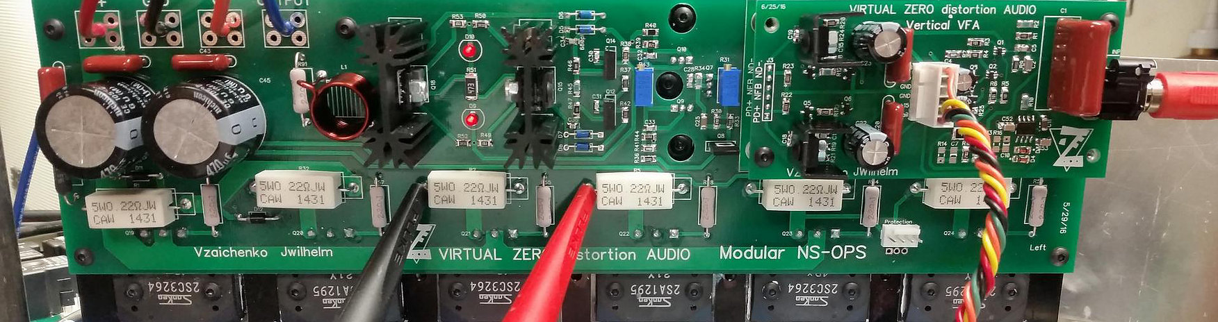

I'm working in a few directions
Here is some material on what is already thoroughly tested.
NS-OPS schematic:
NS-OPS initial design
What it looks like after the great modular layout re-design, performed by Jeff:
NS Modular configuration, allowing different front-end options
Built and tested by Thimios:
NS Modular with X4 front-end - my favourite combination
Some more measurements are available down the link in my signature.
Jeff is also going to live-test the VHex+EC (the one with feed-forward EC) amplifier pretty soon - we will report on the results 😉
Valery

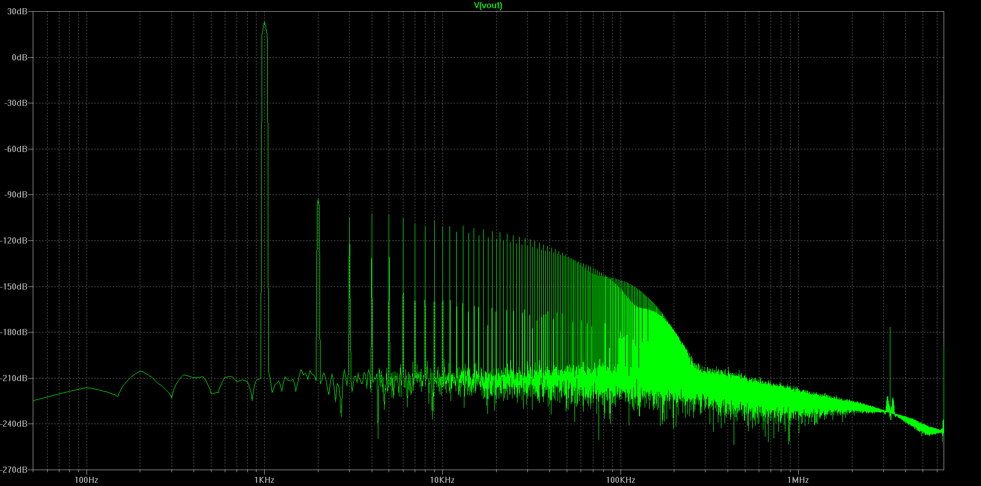

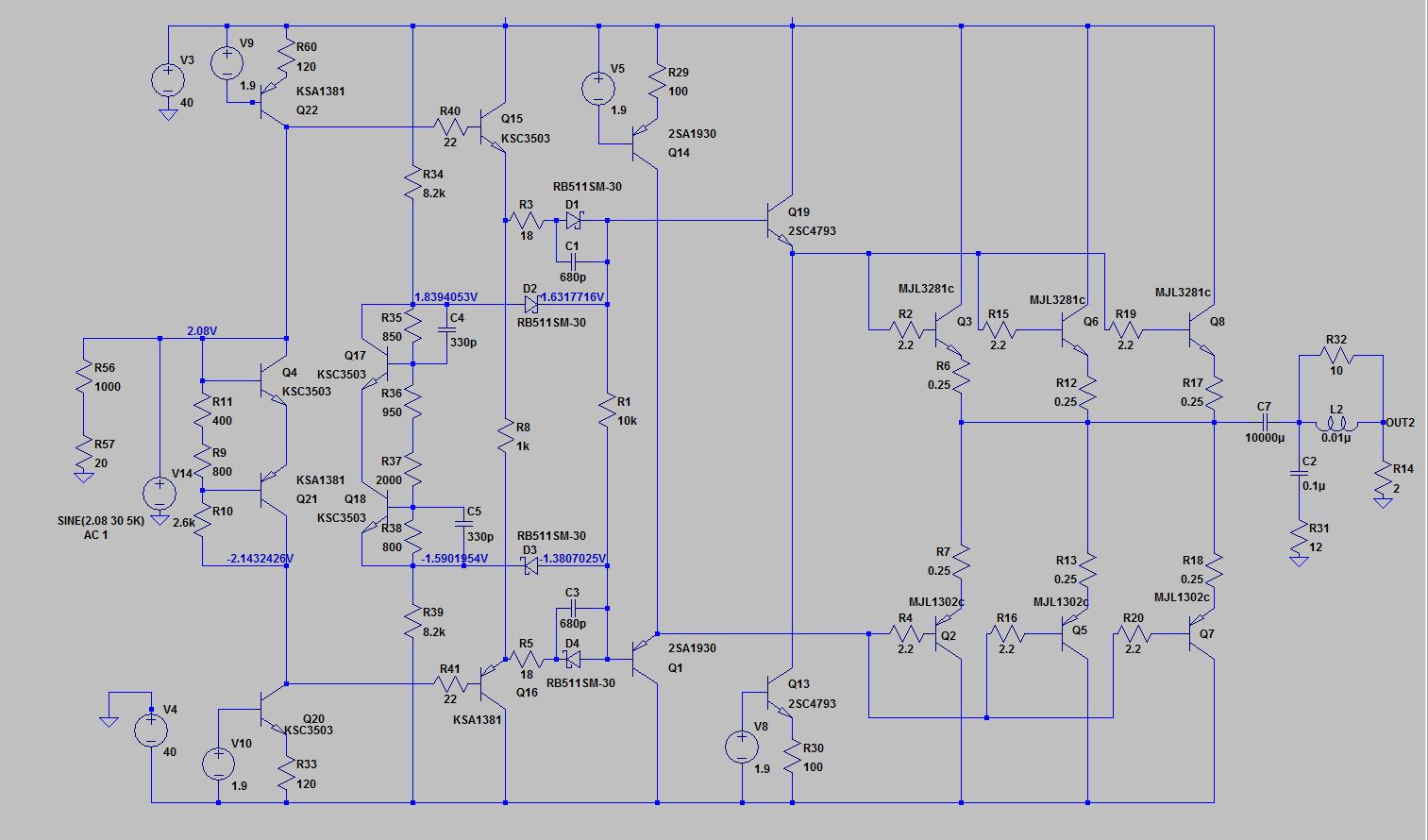

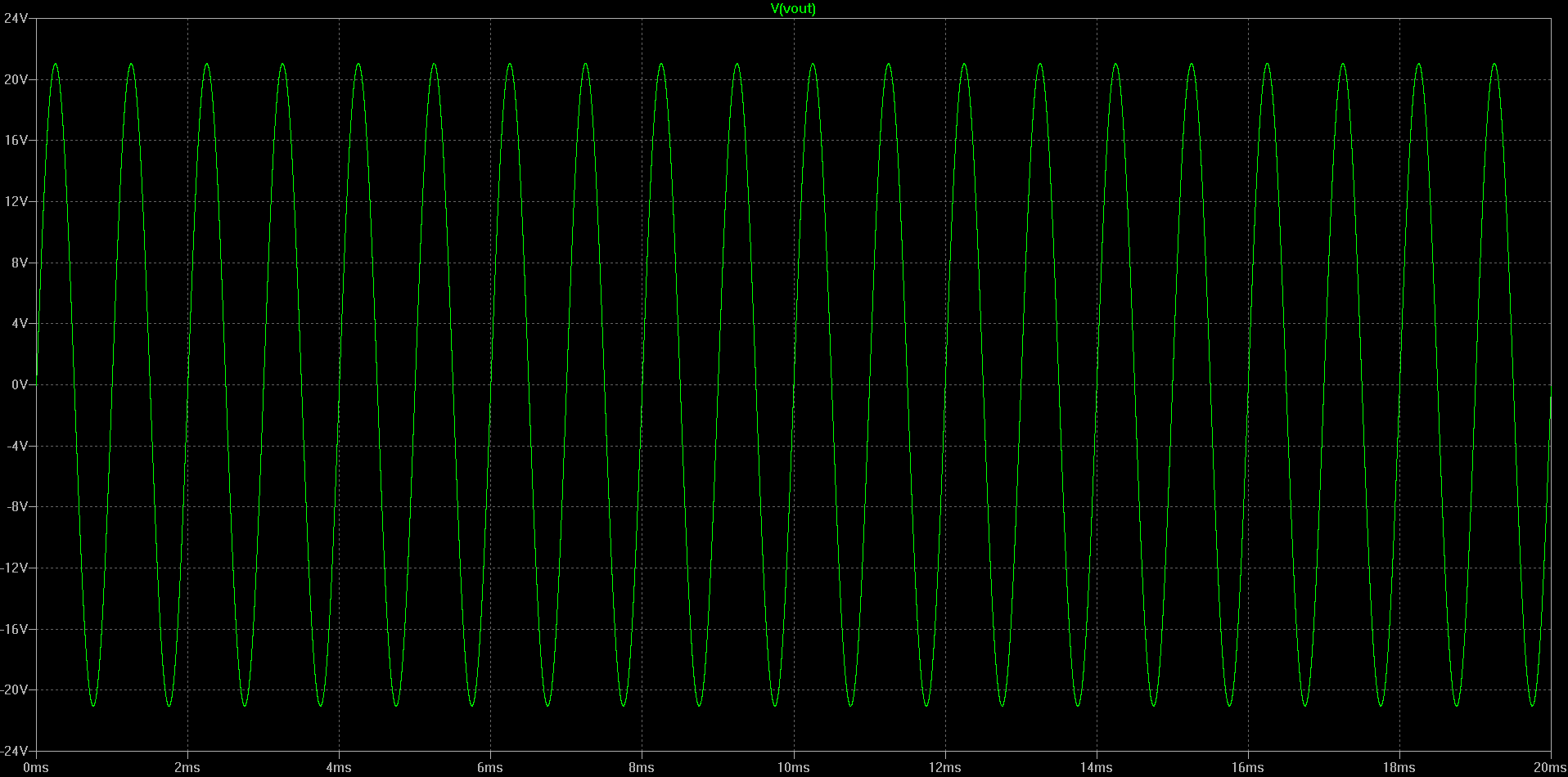

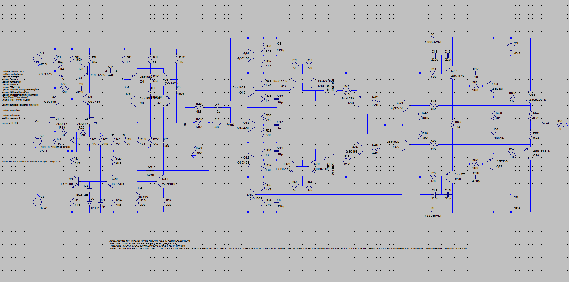

I spent some time doing simulation with LTSpice on a few circuits talked about in this thread. I simulate with only the OPS with no feedback. I just drive the voltage spreader with generator, check the biased current and plot the FFT. I cannot get good result so far. None of the case is even close to a good old simple Class AB with optimal bias.
Anyone simulated these circuit before? Can you post your .asc file? I might make wrong assumptions and don't get the good result.

Hi Valery
I drive the OPA alone only loop using voltage generator driving the top of the voltage spreader. I adjust the offset of the generator to get the output as close to 0V as possible. Then I AC couple to 2ohm load with a high value cap to run the FFT.
My idea is just looking at the distortion created only by the OPS with the bias enhancement shown in this thread. I consistently get worst distortion than when I remove the bias compensation.
I actually simulated your circuit as it really look interesting and it make sense. But I got higher distortion in the FFT when I have the bias compensation circuit in than when I just disconnect D1 and D4 in your schematic( D2 and D3 in my simulation). I play with different voltage across Q5 and Q6 (Q17 and Q18) with no luck.
What is the reason I should simulate with the whole circuit including the IPS and VAS? I worry that the feedback gain mask the distortion of the OPS alone. That's why I run OPS alone without any feedback to look at the full distortion.
they are a part of ltspice lib, I do not have separate ones...
probably if you change them to std BC550/560, BD193/140, MJE15032/33, etc, the sim will be possible!
I'll work on it.

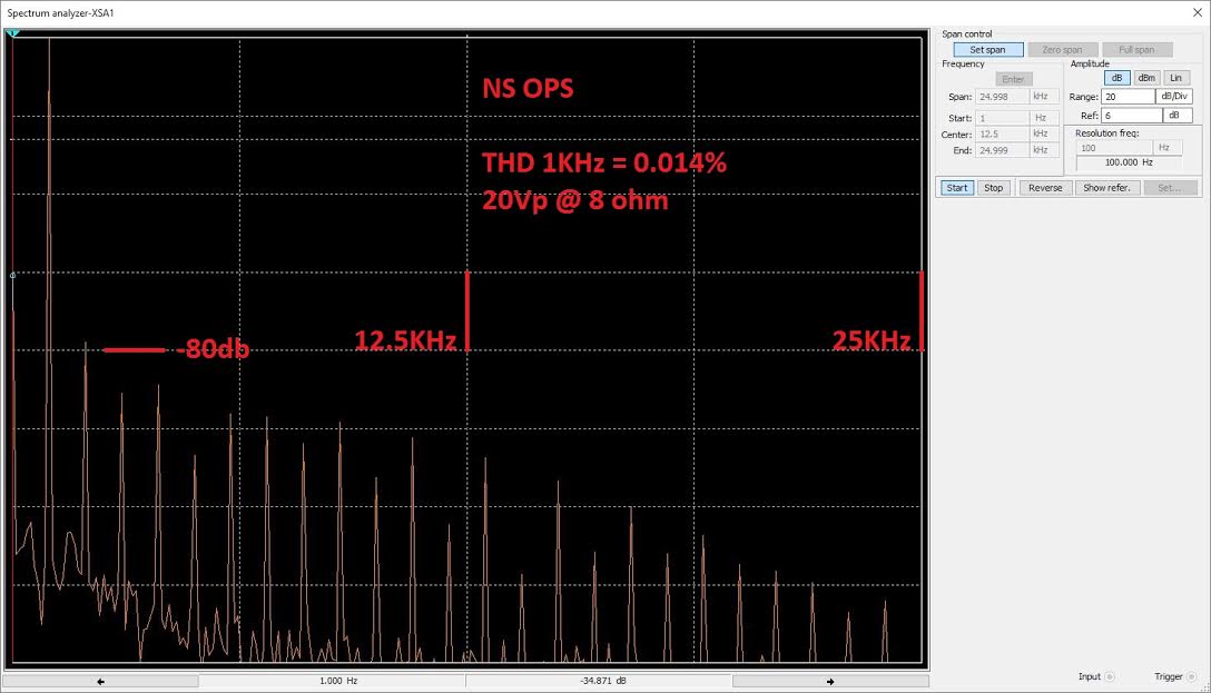

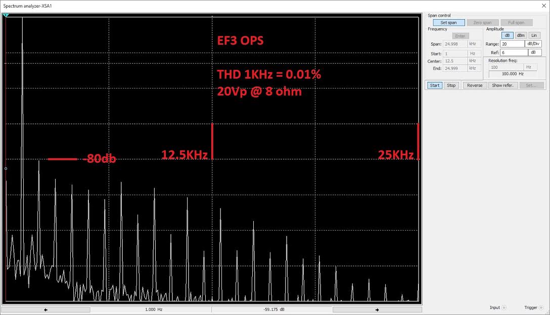

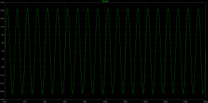

Hi Audiocrase and All,
I ran some simulations, using two CCSs 5 mA each from OPS input to the rails, driving the input via 100R resistor.
At 1KHz 20Vp spectrums are rather similar.
1-st picture - traditional EF3 arrangement;
2-nd picture - NS OPS.
Simulated THD is rather close, although the one with NS OPS is a little bit higher.
I have quickly checked THD at lover output levels:
4Vp -> EF3 = 0.007% | NS OPS = 0.007%
2Vp -> EF3 = 0.003% | NS OPS = 0.003%
However, live measurements show excellent performance of NS OPS, both measured and listened.
One more thing - rather important one. NS OPS keeps low level of distortion in much wider range of the quiescent currents, which is always good to have - distortion increase when the volume goes down after running high for a long time (hot heatsinks) is a well known issue for traditional EF OPS with thermally coupled bias spreader.
Probably simulation does not reflect all the nuances of switching distortion in crossover region.
Valery
