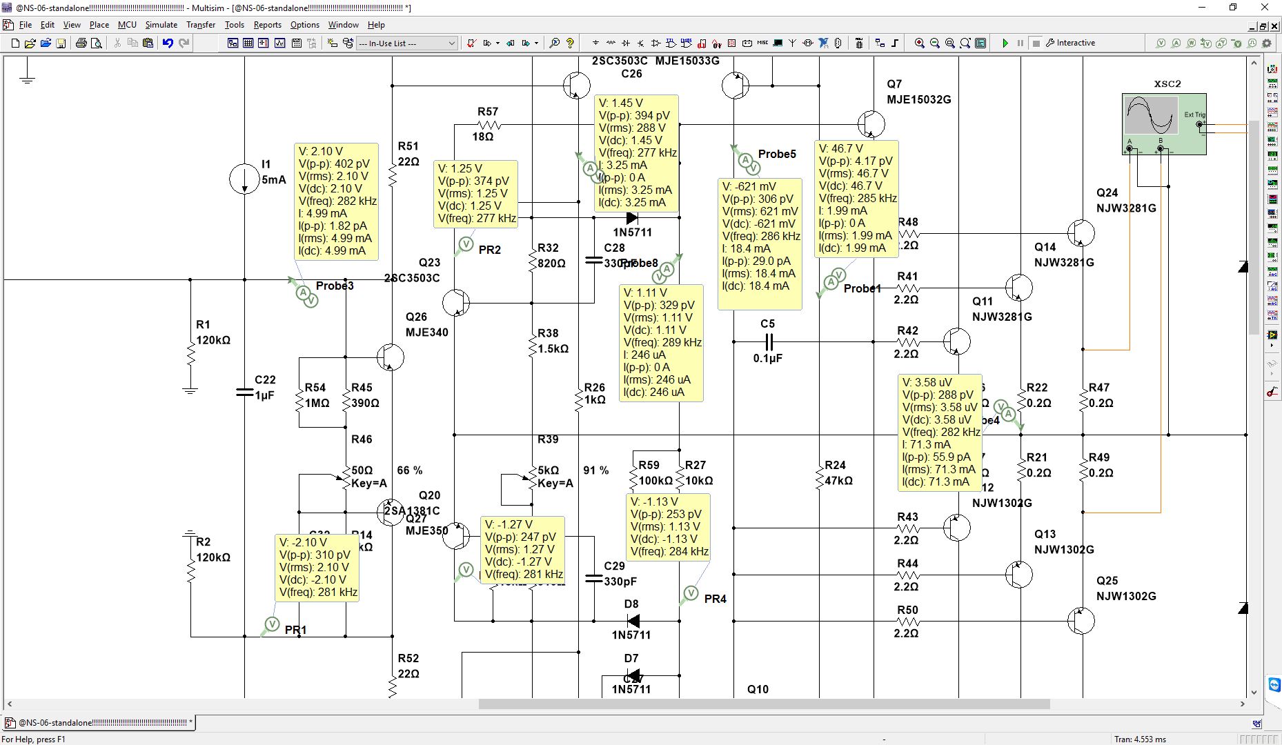

I drive the OPA alone only loop using voltage generator driving the top of the voltage spreader. I adjust the offset of the generator to get the output as close to 0V as possible. Then I AC couple to 2ohm load with a high value cap to run the FFT.
My idea is just looking at the distortion created only by the OPS with the bias enhancement shown in this thread. I consistently get worst distortion than when I remove the bias compensation.
I actually simulated your circuit as it really look interesting and it make sense. But I got higher distortion in the FFT when I have the bias compensation circuit in than when I just disconnect D1 and D4 in your schematic( D2 and D3 in my simulation). I play with different voltage across Q5 and Q6 (Q17 and Q18) with no luck.
What is the reason I should simulate with the whole circuit including the IPS and VAS? I worry that the feedback gain mask the distortion of the OPS alone. That's why I run OPS alone without any feedback to look at the full distortion.

Makes a lot of sense. I observe a sort of the same thing, simulating the OPS with feed-forward error correction - the profile and level of low-order harmonics is roughly the same (just very slightly lower), but all the higher-order "garbage" is suppressed significantly. This is, what I believe, makes it sounding better. Our prototype is still in the building stage, so I will report back later on this.
Hi Valery
Thanks for your response. I am very interested in your circuit. Do you mean in your last post, you actually only simulate the OPS alone and drive the input of the OPS with 100ohm resistor and got the FFT plot?
Hi Audiocrase, that's right.
Your result is a lot better than what I got in LTSpice simulation. It must be something I did wrong with my simulation. Can you tell me how you set the voltages on the few places I shown in my attachment? Particularly the voltage across D2 and D3. I experimented quite a bit with my simulation, the attachment show my final voltage on both the voltage spreaders. I don't know whether it is optimal or not.
Attached picture demonstrates the voltages and currents in the key points of the circuit (no input signal, DC offset is close to zero).

Bob - a good one, as long as we don't consider the pre-drivers being part of the OPS.
When I ran initial tests on the non-switching prototype, I have split the NFB resistor into 2 x double-value ones and connected them to the positive and negative shoulders of push-pull VAS output (just on both sides of bias spreader) - works well if NFB netwok's impedance is relatively high.
The drawback of the approach - we slightly load the VAS, decreasing its output impedance at the same time (improving its driving capabilities with regards to OPS). However, the whole OPS, including the pre-drivers, is running clean outside the global loop, allowing open loop measurements and valid comparison with other OPS topology options.
