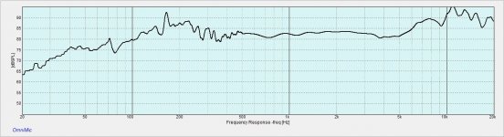

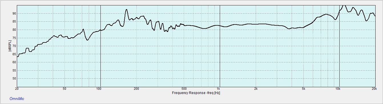

Not sure what you're looking at but the on-axis frequency response is very good up to 4 kHz or so, with the only flaw being a mild, broad rise centered at 1.5-2 kHz.
If you're talking about the 30 and 60 degree off-axis curves, they seem to be fairly in-line with other drivers of similar size. I have not, however, double-checked to confirm...
If you put the driver on a narrow baffle of a typical size of about 200mm, there is usually a dip around 3 - 4khz due to diffraction. On the infinite baffle, the driver starts to taper beginning at 2khz then dips at around 3khz, then starts to break up after that so generously after 3khz, it is no longer usable. So if you combine the diffraction dip and the inherent dip of the driver on the actual baffle, it does start to taper off rather quickly after 2khz. I have the actual freq. measurement on a 200mm baffle which is posted below. As you can see, realistically on a 200mm x 300mm baffle, one should design a xover that start to roll off after 2khz.

You are using super tiny 5db/div and not only that you stretch out the horizontal axis so it will make any driver looks good. The graph shows the same dip as on my graph but the 5db/div makes it looks a lot better. There is not that much difference between yours and my plot.

You need to look closer at the data. Your plot shows a 6 dB dip. My measurement that Jim posted shows only a 3 dB dip. A different scale on either or both axis may make a plot look subjectively better or worse, but the data stands on its own. Your data does not match my data.

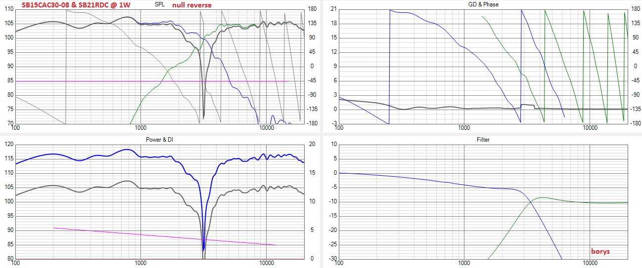

This doesn't add up. I simulated a 200 mm wide x 300 mm tall baffle, with sharp edges, and a 120 mm diameter driver. No matter where I position the driver on the baffle there is never a dip at 4kHz. In fact at realistic positions there is actually a 1 dB peak at 4kHz. This disappears if you add even a modest edge round over.
This doesn't add up. I simulated a 200 mm wide x 300 mm tall baffle, with sharp edges, and a 120 mm diameter driver. .

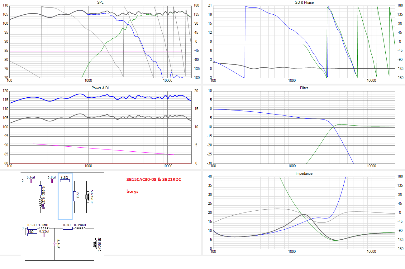

Well it would be helpful if you could post your design and xover. With the internet nowaday, there are just too many "unproven" claims. I promise I won't steal your works.
If you are using real measured responses, simulations are more accurate than you think they are. If the tool is holding its salt, and the person using it and measuring the drivers know their salt, then the tool will be really accurate as utilized. Simulations are not bad things, especially when the results match that of the sim.

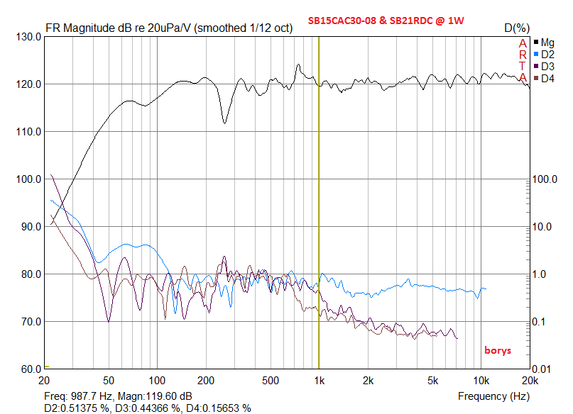

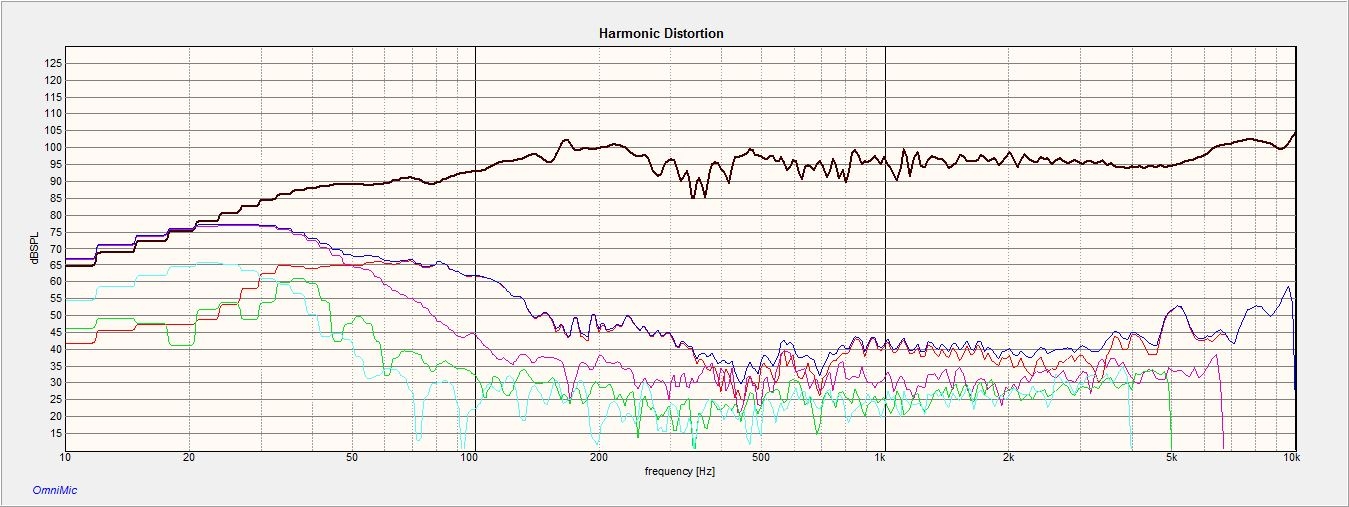

If you issue with these is that it won't do your 1st order filters well, then that is your problem. Most of the time 5" drivers aren't required to exceed 4k in response. This does not make it garbage. FWIW, the HD on that measurement PR took is very good, and at the price of the driver it's really cheap for that kind of performance. It is rare for a driver to have that low of HD, and be $80. I had a driver that was almost $375 each just barely do better at HD than this $80 one does.

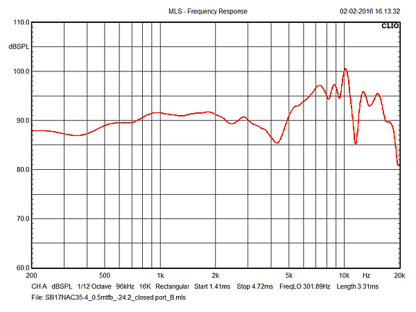

Well I am sure there are very accurate simulation, but I won't argue with it since I don't really know the tool He was using. All I can comment on my own measurements. Also if you saw Troels' measurement on the NAC (post #104), you can see the 6db dip at around 4khz as well. And to have any credibility, one should post one's own design. Seems like a lot of people in this thread had their own opinions of the driver but somehow none could post their own design.
As for HD, I don't think it tells the whole story. It's only part of millions of variables that made up what is good about a driver.

I posted my measurement and the baffle geometry. I also pointed out Troels measurement which has similar dip around 4khz as mine. Both of which are verifiable. I put my money where my mouth is. I am not sure why it's so difficult to understand. As I said before, with the Internet nowaday, there are just too many "unproven" claims and witch crafts being passed off as real science.
