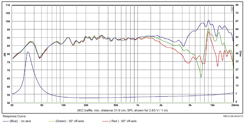

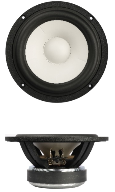

Looks nice! :)
SB Acoustics :: 4" SB12CACS25-4
SB Acoustics :: 5" SB15CAC30-4
SB Acoustics :: 6" SB17CAC35-4
SB Acoustics :: 8" SB23CACS45-8
attachment.php
attachment.php
I will test it, when available!
Regards
/Göran

;) It is a ceramic cone or a ceramic coated metal cone ?
Might also be ceramic coated paper, Focal made cones like this and called them W glass, Silver Flute too, i guess a chimical treatment leaving a mineral coating at both faces of the cone...:rolleyes:
Break up modes are strong but somewhat scattered.
Regarding these SBA, the 8' is interesting, the rest me-too midwoofers as plenty on the market, nothing new under the sun, simply more choice for diyers...
The W has a foamed rohacell core if I don't mistake, don't know how they coat the "glass" but the surface is not smooth, a little like grain of sand...
Or it's FauxCal !
There are finally many drivers makers which took the idea of a sandwich with a foam core structure : also B&W ? The brand also than Focal Audio speakers chose... iirc.
So one thing that is kind of weird is that despite being ceramic, they also seem to use the standard 3-part construction. Cone, dust cap and voice coil former.
Actually it's weird any metal cone driver does this too.
Wonder why. I mean if I was going to go through the trouble of making a pure ceramic driver, I would at least eliminate the dust cap.
