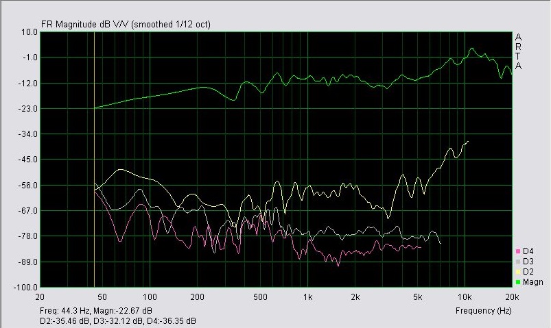

Bellow callibrated 2.83V RMS.

These SB Acoustics CAC ceramic (and NAC aluminium) line of drivers are one of the single cleanest measuring bass-midrange drivers out there. It handles well nonlinearities even at elevated drive voltages. Only Seas Excel W15CY001 measures so clean but remember that Seas is 3x more expensive driver and what is more its magnesium membrane is plagued with severe break-up so you do need to know well how to handle it. SB driver is extremely easy to use, on the other hand. Response in passive alignments is impressive as well. Kudos to SB Acoustics!

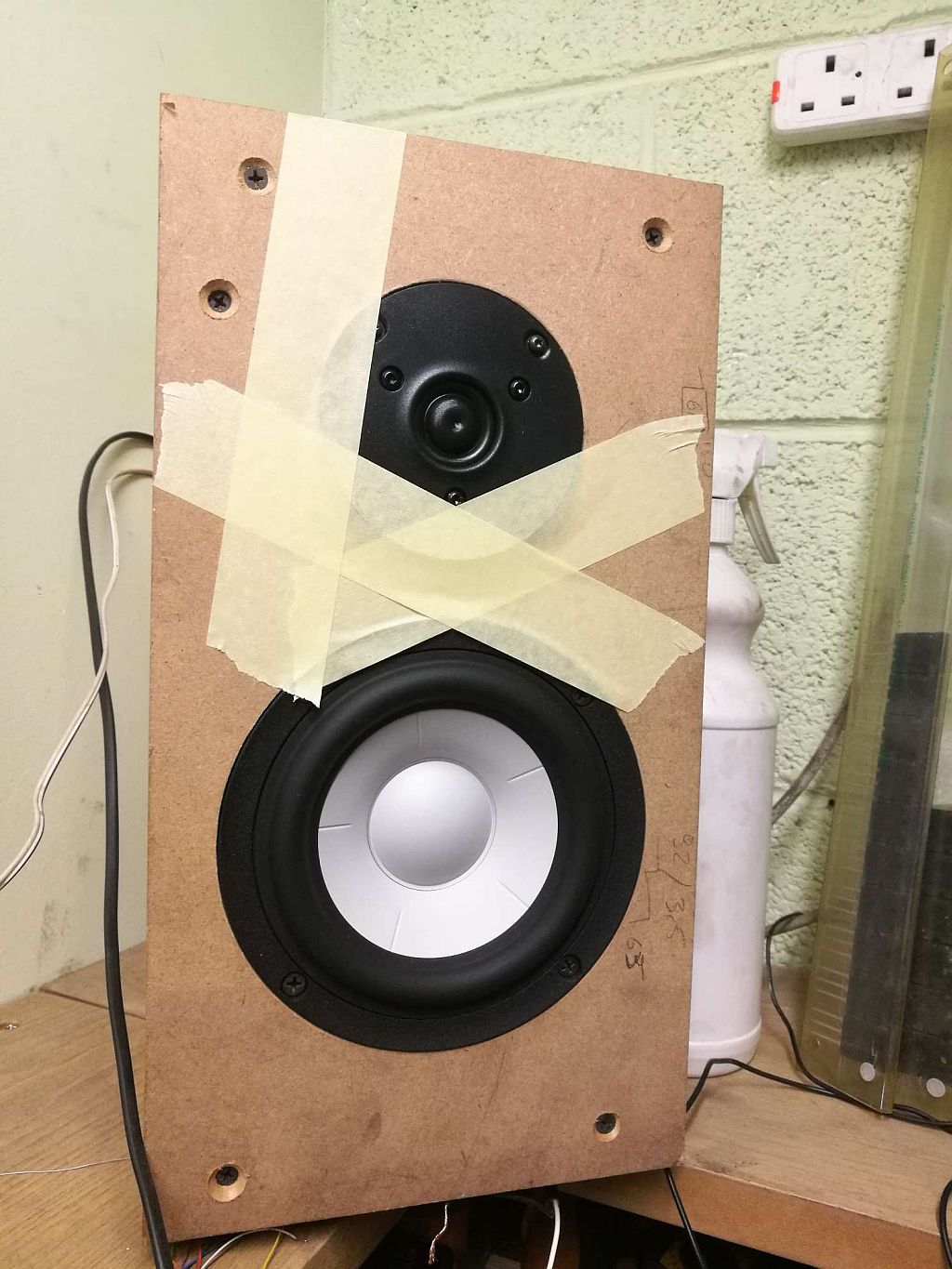

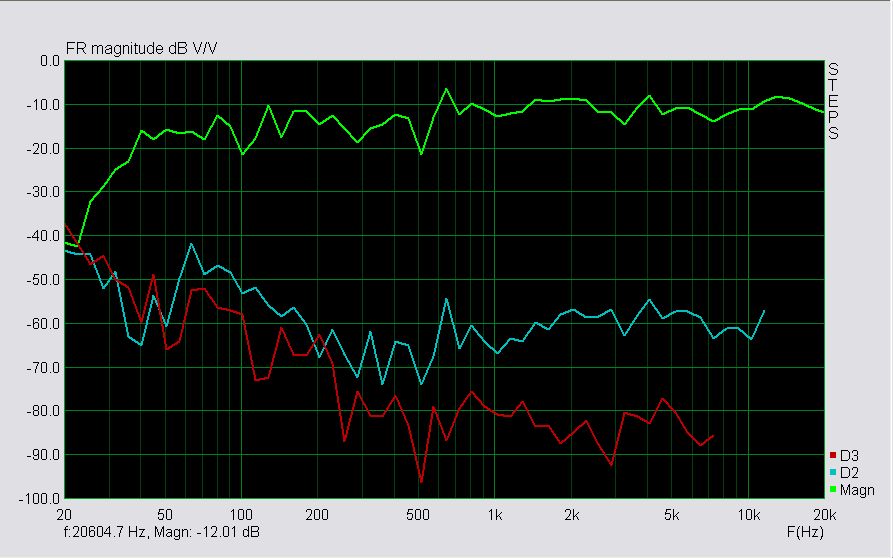

I have made quick setup SB15CAC + SB21RDC + some parts hanging around my desk. This 15cm woofer is bass-crazy, just look Yourself :D
The measurements are not super accurate (crossover also) but the bass is really deep.

Good balance of T-S parameters combined with decent linear stroke capabilities can develop impressive output from small enclosure and relatively small excitation signal. This is combined with special features: low-order HD rapidly rising from ultra - clean midrange (typical for constant - inductance motors and rigid membranes behaving like ideal piston) into the harmonics - rich bass. High HD content inside of bass range gives the impression of "huge bass". These are my favorites among 5".
