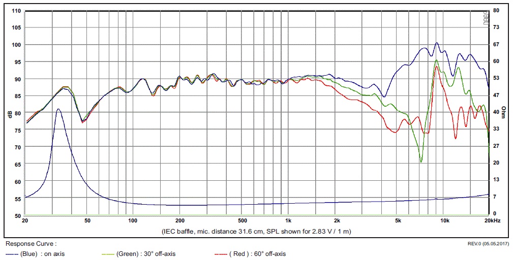

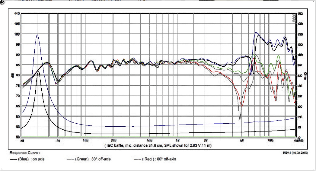

Because measurements are done with IEC baffle at close distance of 31.6 cm (and than scaled to 2.83V/1m).
Would you describe the phenomenon that caused the dip in the response ?
Please ?
IEC baffle is a dipole loudspeaker, so there will be one wide dip around 150 Hz (as seen on all pictures).
Dip at 50 Hz and peak below 40 Hz are the same with different drver Fs, so are room related:

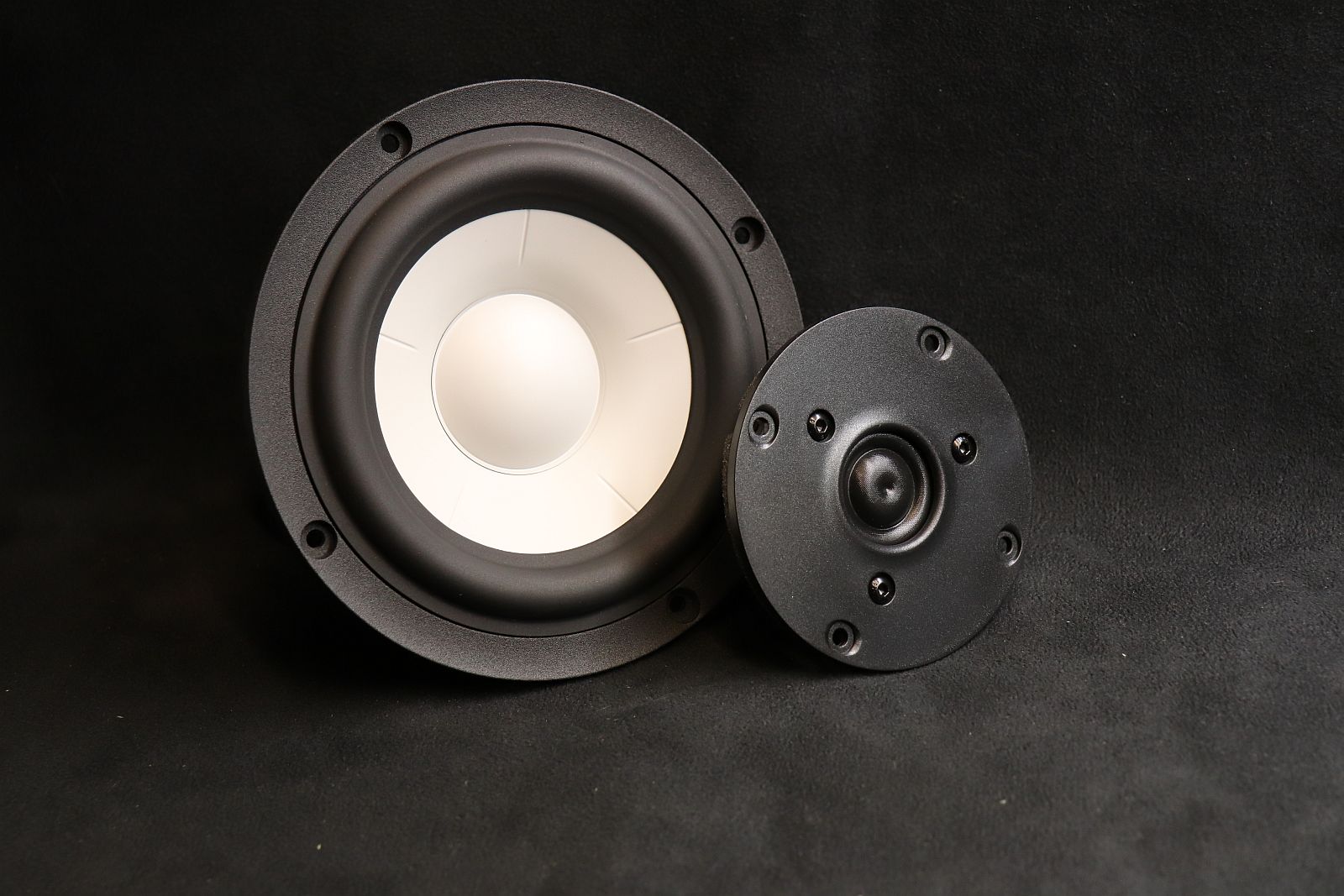

So one thing that is kind of weird is that despite being ceramic, they also seem to use the standard 3-part construction. Cone, dust cap and voice coil former.
Actually it's weird any metal cone driver does this too.
Wonder why. I mean if I was going to go through the trouble of making a pure ceramic driver, I would at least eliminate the dust cap.
The reason is quite simple: These ceramics are made by oxidizing aluminium. They produce it like any usual aluminium cone and oxidizing the upper layer of aluminium then, which makes the cones 'automatically' composite layered. Another technique is to 'spray coating' it on, I think it may be named 'vapor deposition' but I'm not sure (sry, not a native speaker) and let it build up that way. So it's not the same as the membranes of the Thiel/Accuton drivers which are, to my knowledge, pure ceramics.
I mean, the idea of forming the dust cap separately and gluing it on is an artifact of paper cone construction, isn't it?
No, it got several constructional advantages. Because the dustcap can be mounted last, it is so much easier to center the voice coil and glue it on, that keeps the tolerances low. And, ofcourse, you can use the same, already existing production lines as for all the other drivers.
It is a ceramic cone or a ceramic coated metal cone ?
The latter. And I pretty much prefer it that way by far. Firstly, the breakup does not happen that explosion-like and secondly something like this can't happen:

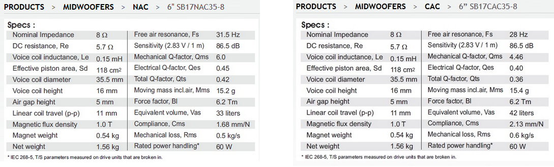

The 6.5" ceramic driver has a cone break-up mode at ~9kHz, while the pure alu version has it at ~10kHz.
9kHz is good for a driver of this size, but as in the alu version to have it at 10kHz is simply amazing.
SB17CAC35-4
SB17NAC35-4

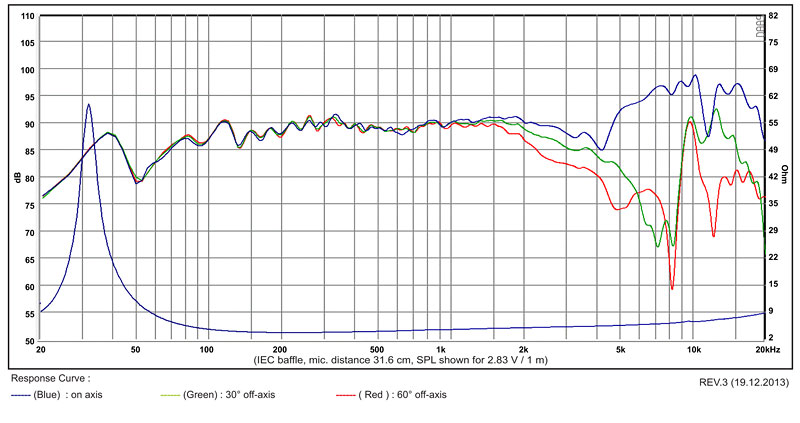

"for optimum piston operation and reduced break-up"
I see huuuge break-ups...

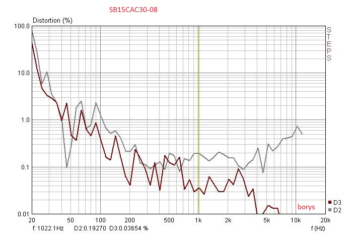

Yes, these are hard cone drivers, but look at the distortion plots:
www.audioexcite.com -- SB Acoustics SB17NAC35-4
The break-ups are very well handled and is the best I've seen and measured for a hard cone driver of this size.

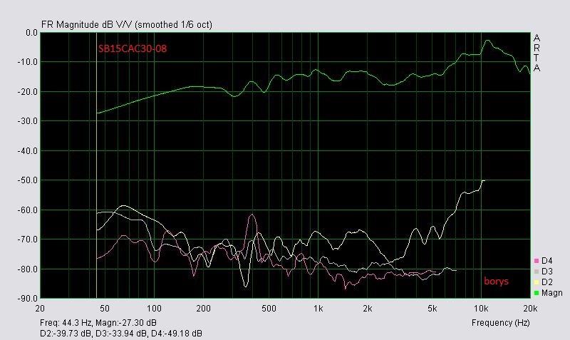

Not possible..Are the SB17 range all the same below 100hz?(distortionwise)
But, that is very good THD for 6-7' driver, usually have first distorsion peak around or below 2k..
Not possible..
Interested in below 100hz as there are differing opinions of various SB17 models. Id assume the motors are identical, just the cones and possibly spiders are different.
Sorry, I don't have such distortion measurements.
Rgds
/Göran
Zaph had distorsion measurements below 100Hz..Sorry, I don't have such distortion measurements.

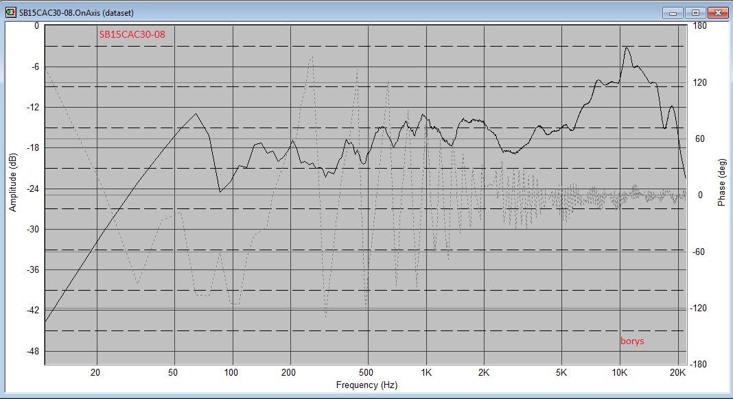

I got a pair of the new CAC mid woofers. First test measurements were taken today. Bass goes very low for the 15cm woofer but IMHO it doesn't have so many ''colours'' as paper woofers. Midrange are superb and very natural with plenty details. Overall good value for the money.

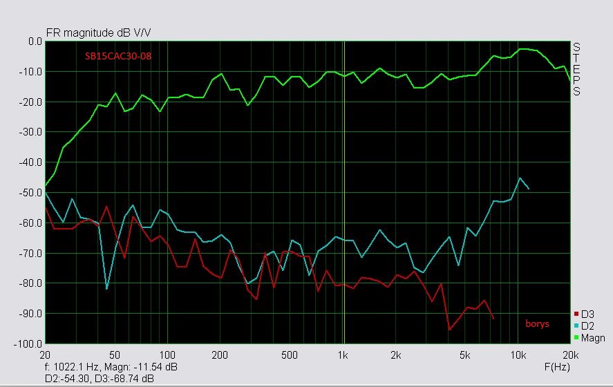

About that first illustration, is that showing speaker distortion running as low as .1% THD? Or am I reading it all wrong?I got a pair of the new CAC mid woofers. First test measurements were taken today.....
.1% would be truly incredible.
