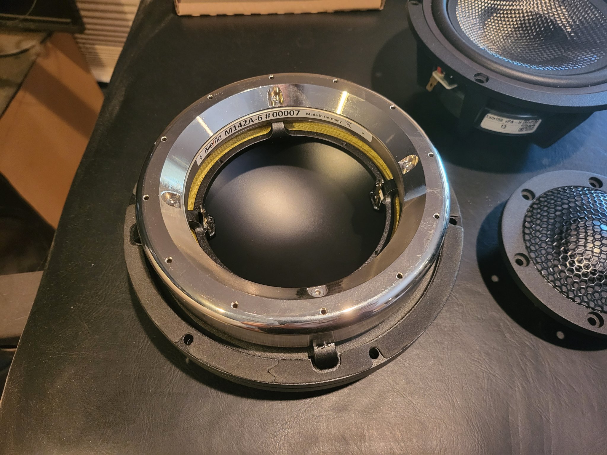

Yes it will be an high SPL / low distortion active 3-way (Hypex Fusion FA503) with dual PHL 6021MNd crossed over at 200Hz to dual Purifi PTT6.5M08 and crossed over at 2500Hz to the (probably) Bliesma T34A. I want to hold on to that 200Hz crossover to keep the most important midrange band in one driver.
That´s why the Bliesma M142-6 would be a very nice alternative to keep midrange and tweeter acoustically very close together.

There are PHL 6,5" which fit the 200Hz perfectly - but I would not let them run to 2500Hz cause this would produce a jump in directivity. (Also with the Purify)
Depending on your room I would aim for a higher crossover, at least 250Hz. Cause the 2 15" will probably behave better in the room in the critical 80-250Hz transition area. Also there are important parts of Instruments in the 200Hz area (e.g. bottom of snare), I would put these to the 15".
I would also cross lower to the tweeter - with a PROPER crossover you can make that seamless between M142 and T34 and the lower crossover and close acoustic centers will get you a better "point source".

Yes the crossovers are THE challenge of this whole project. The tweeter needs a passive 2nd order HPF for protection against possible Hypex hiccups. All other drivers wil get active filtering. Not shure what order they'll have to be for best result? I need further reading into filter design to do thing right from the start.
The project will be quite unique as all drivers will be built into an extremely sturdy concave AV wall and will be hidden behind cloth grills. The center speaker module will be straight and will be the base for an 85" TV or larger. All speaker cabinets will be fully braced and at least for the midranges I'm thinking of a special internal shape. If the M142-6 would be used, I'd put even more effort in the enclosure to minimize resonances and reflections.
What would be the best size and shape for the back chamber for the M142-6?

Before thinking about orders of filters ... how will you measure the whole thing?

Standard is 4th order filtering - but ACOUSTICALLY 4th order! So you must use the electronic filter order to achieve that with your chassis. Best is to linearize your chassis in the speaker housing with EQ and then apply your filters. Get delays correct (invert phase and aim for biggest chancellation), fine tune filter.
I normally fill cavities with sheep wool enough dense that all resonances are dampened. Most fancy shapes for midranges are totally useless! The strongest and main resonances are lambda/2 of the dimensions - and these don't care about some variations. When you get rid of these - you automatically don't have higer frequency ones.

Does the M142B have a separate spider as a secondary suspension other than just the dome surround? It just seems awfully gutsy to rely on the surround itself to control the moving asy, being such a setup usually permits diaphragm rocking at lower frequencies closer to Fs. With as much xmax as this driver is capable of, a single suspension would be counterproductive IMO.
Isn't that the whole point of it being a dome type? If it had a spider then it would just be a regular driver, just with a convex diaphragm instead of a concave one.
The ATC 3" dome has a separate spider. There are others with the same setup. I was under the impression some of the Accuton domes also had this arrangement?.
IMO, the biggest benefit to having a single suspension element is keeping the back of the diaphragm unobstructed for less internal reflections.

I only know the ATCs with this setup - never opened a 2" or 3" or 2,5" dome with a spider. (Btw - is there a picture of the ATC interns? How did they solve that?)
I also never detected a problem with 2-3" domes to be honest. Even when I tend to cross over as low as possible.
A huge dome like the M142B ... would be more prone for these effects, that's for sure. But there is an underhung coil in a very strong magnetic field, maybe that's enough to have a controlled movement. Moving mass is very low too.

I imported both M142A-6 and Purifi PTT6.5M08 in WinISD and simulated midrange cabinets with QTC ranging from 0.5 to 0.7 combined with a 2nd order 250Hz HPF and I don't see a lot of difference. But what you say is making the enclosure even smaller (QTC 0,9 or higher) to achieve the right crossover frequency?

In order to get the filters right you need to get good measurements! That's not so hard with the tweeter, but a midrange going down to 250Hz is not easy to measure in room. Working with absorber "walls" is a good idea! I always just put a lot of absorbers at the floor, at least 50cm high.I was thinking of making a 120cm x 120cm x 120cm cavity with 30cm of mineral wool boards to minimize room reflections during measurements. OTOH why make all that effort when they get installed in a normal decorated living room with dips up to 15dB at the listening position and where the AVR Dirac or Audyssey does it's own correction on top of all room modes?
It's Diracs work to care about the room EQ but first you must have a good working filtering.
2 methodes for filtering a midrange highpass. You can use the natural fall off (2nd order) and add a filter 2nd order. This only works when the original cut off frequency is relatively close to the wanted filter frequency. But don't overdo it in simulation - you need to do that with the real speaker.I imported both M142A-6 and Purifi PTT6.5M08 in WinISD and simulated midrange cabinets with QTC ranging from 0.5 to 0.7 combined with a 2nd order 250Hz HPF and I don't see a lot of difference. But what you say is making the enclosure even smaller (QTC 0,9 or higher) to achieve the right crossover frequency?
Or you filter higher as the resonance (as I do with 2-3" midranges or tweeters) - the linearise around your filter frequency so the electrical filter can work as it should, at least in the transition area. This can also mean you boost frequencies there which you later filter away - so no problem for the driver, just don't overdo it.
