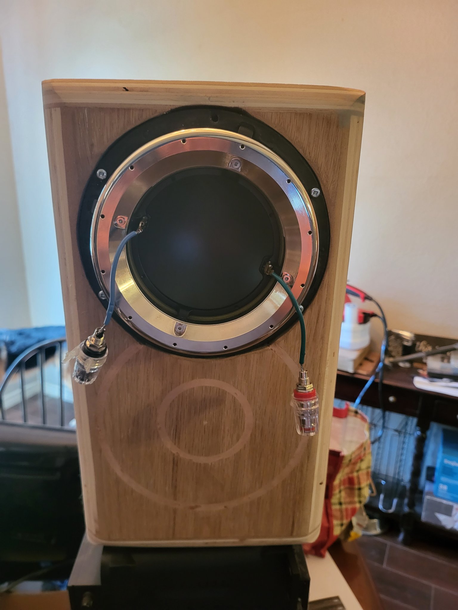

I'm actually going to be testing the back side of the driver today smoking a pork shoulder for dinner on a new smoker so I'm going to baby it all day so I'm going to have a fun day cleaning house and testing while that's going on.
You canlook at the voice coil from the side. There will be some spl emitted there which likely doesn't add properly.
So got around to testing the driver backwards pretty neat the magnet just funnels the sound 0-60 degrees are all fine and dandy then at 90 your -15db also that huge bump is definitely just the back of the drivers response being funneled down the magnet its acting like a waveguide. There is a peak out at 3.3khz that is some sort distortion much higher then anyway where else I'm guessing it's the gap between magnet and basket that I didn't fill with anything. Cardioid is much more interesting but that will have to wait a few weeks getting +3db at 250-400hz ?
