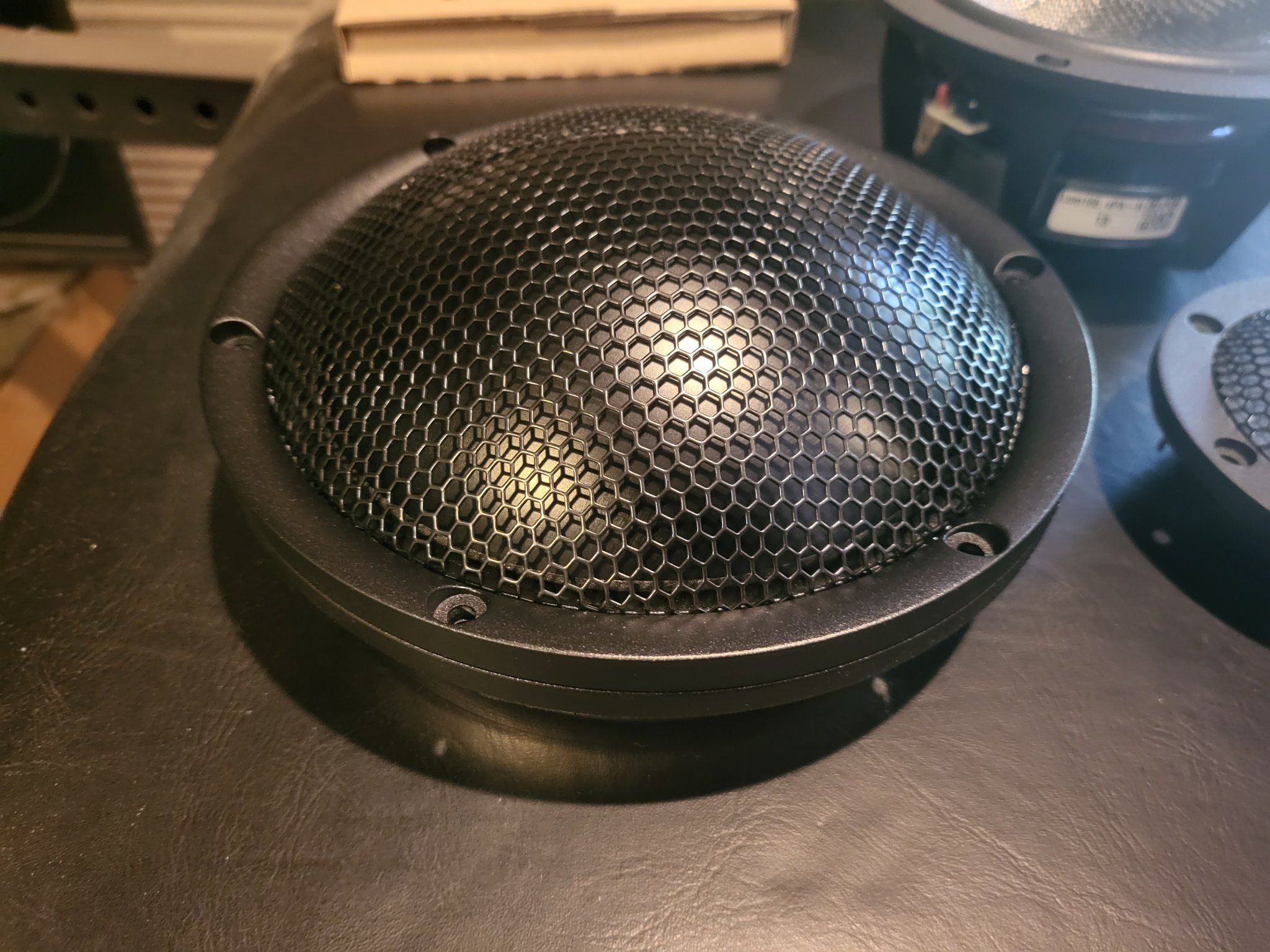

This mid is pretty out there In design was kinda shocked at its size unpacking it. Next to It is bliesma,kartesian 6.5 lom pa ,purifi 8 for scale.

Oh wow! That open ring magnet assembly is incredible. Reminds me of a woofer that used to be sold on Madisound probably 10+ years ago. Was very low profile, had a honeycomb diaphragm and a completely open magnet structure just like that. I think it was about 10" diameter, but I can't find it anywhere online after searching for about a half hour and have no recolection of the brand name.

the surround is a concaveHow is the 142 mm dome suspended at the dome rim?
It looks as if there is a classic corrugated spider -to hold the VC in place I presume- , but I cannot detect the outside suspension because of the mesh.

These perimeter driven drivers are not new. Yes Accuton has a few models in the CELL range with it, but not all.
eg.
C168-6-990-CELL
C90-6-724-CELL
Like all neo drivers, they are lighter than ferrite motors. But apart from being novel, I'd like to see some data of the purported benefits.
eg.
C168-6-990-CELL
C90-6-724-CELL
Isn't this just the Bliesma version of Accuton Cell ?
Pretty sure he designed for them before starting Bliesma.

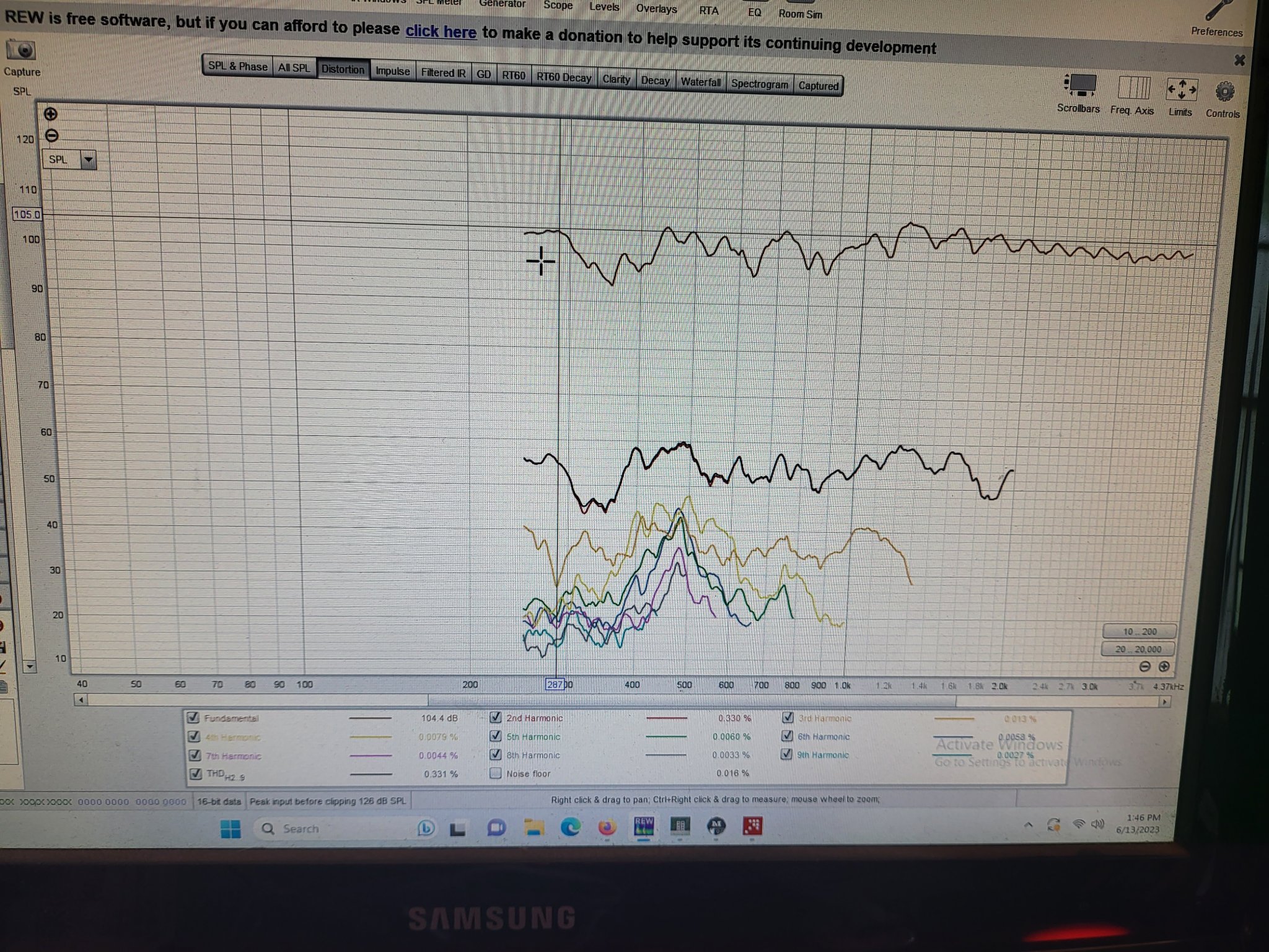

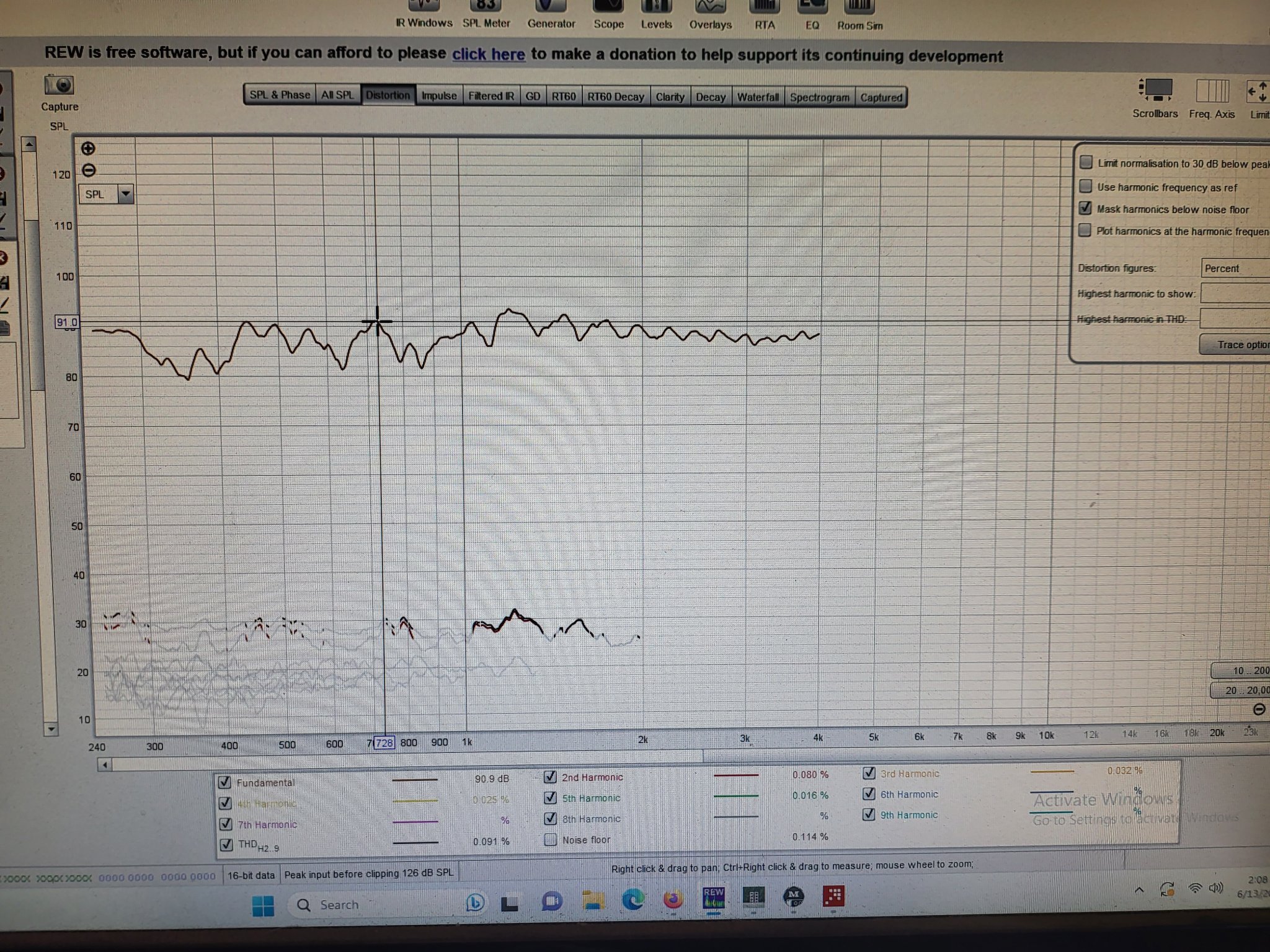

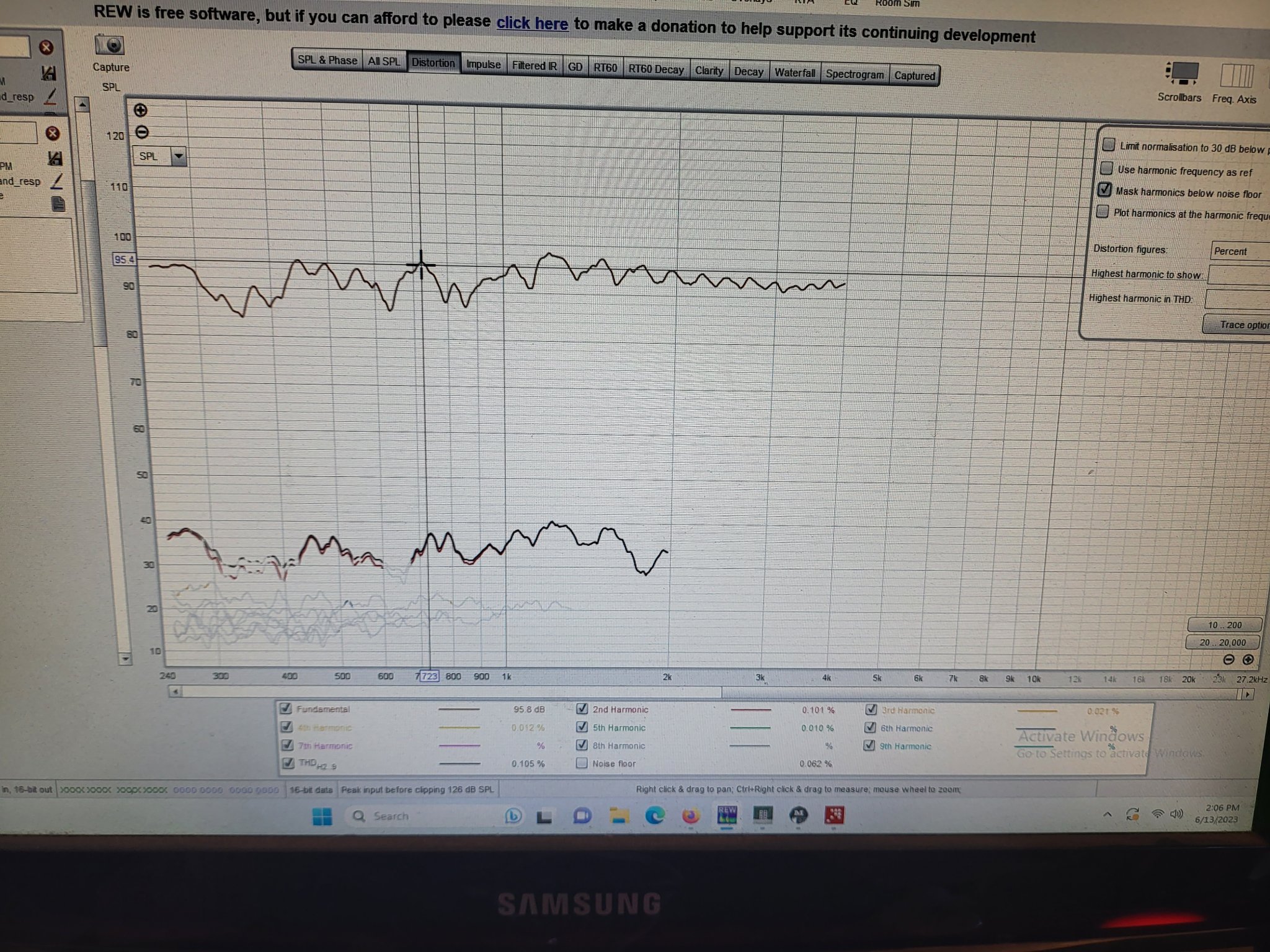

Distortion at 104db at 3 ft distortion does rise a bit below 250hz 1 percent at 96db so I would say this driver is good between 250 and 2k. My box is not good at all I've already had to go to get weather stripping. Here's 104 94 89 I would say they are okay drivers.
