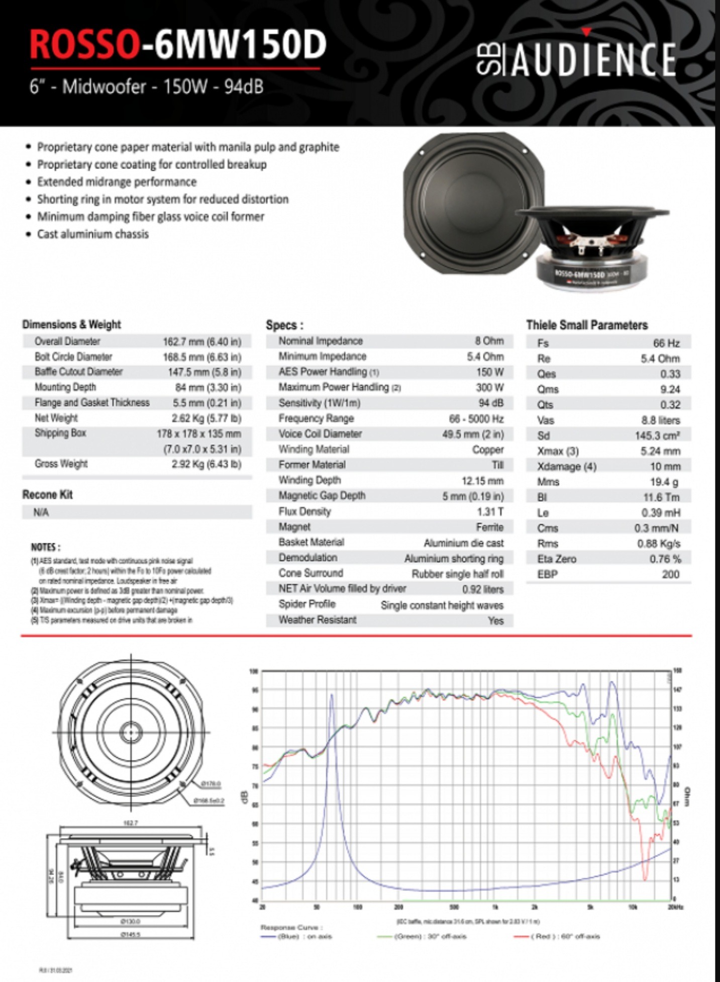

If breakup above say 5 Khz and low Fs are the design target, any properly designed 4-5" paper or alu coned driver will do the job. All that is required is that manufactureres would use a somewhat more beefed up motor in order to increase sensitivity. A very suitable candidate would be the Vifa NE149: a virtually blameless driver.
But hey, this echoes the recent discussion about the applicability of 3" domes versus 3-4" cone drivers..
I see very little point in such a large diameter dome driver having a relatively limited operating range and not utilizing a double suspension as found in cone drivers.
A decent 6" pro sound driver would be a better choice performance wise, as it can be used down to Fs (xmax permitting) and wouldn't potentially suffer from diaphragm rocking modes. The upper cutoff isn't anything special to achieve. The SB Audience 6MW150D gets close performance wise and costs less than $100.
