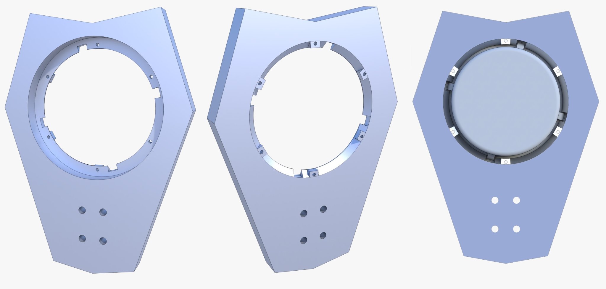

I have same driver and working on the design of the dipole panel. It will cover 250-1K in my system with the M74B/T25B above it.
This is not a driver to work with the usual DiY methods. I recommend asking Bliesma for the 3D file. It requiere attention, as you already noted.
I recommend precision routing both sides (if you use MDF). I decided to use CNC/solid 6061.
Whether you use OB or closed a very sloped chamfer is necessary at the back to leave the MC as free as possible, this is Bliesma recommendation.
are you doing Purifi sealed?Will need the basket ribs cutout but this is basically what I’m doing. pairing with T34B and 6x Purifi 5.25x woofers. I think they should keep up!

Doing some prototypes out of CF reinforced ABS or even CF / PLA would be an option. It sounds like there's a lot of little mexhanical details to consider when adapting the M142 chassis to a bespoke enclosure design. Alot of CAD design help would be needed in this case which isn't cheap. A tapered midrange TL would be nice like B&W does and could likely have big sonic benefits vs a simple stuffed enclosure.
